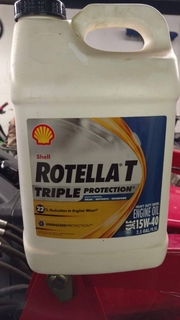

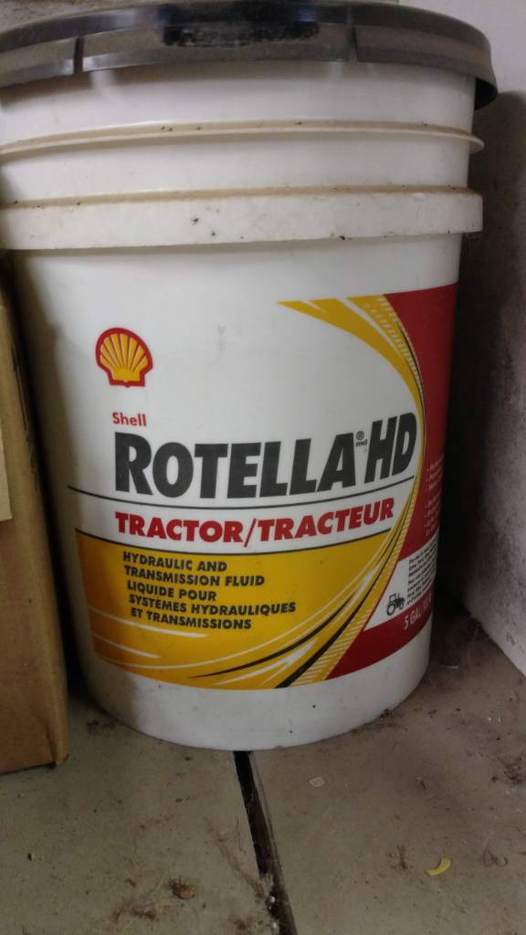

This Hydraulic filter fits the MAx28 Shuttle. May fit others.
Also I found this oil to work really well in hydraulics, both hot and cold weather.
K&N HP1010 oil filters with T6 Shell Rotella is my go to motor oil.
Just motioning this as I just did an unscheduled complete fluid change on my MAX28 Shuttle.

Thanks I will keep it in mind.
one (just one of) of the big problems with those aftermarket filters is what happens in cold weather when the oil is thick. The filter has to have a by pass for the heavy thick oil or bad things can happen. The one that was engineered for your machine will have the appropriate measures already built in to accommodate your machine. Some aftermarket one will not.
The aftermarket filter may have a by-pass to deal with thick cold oil but it may not be sufficient for your machine or it may be too easy and your machine may invoke it frequently, either way, it's not good. The engineers for the aftermarket filters were not using the specifications for your machine.
They could be re-branded Cat or Deer or whatever but not your mahindra model.
/ Oil Equivalents #24
I always buy the expensive specific Kubota dual hydraulic oil filters for My TLB. Externally Kubota make 4 outwardly identical filters that would fit. The one I get has a ring magnet and specific relief valve.
