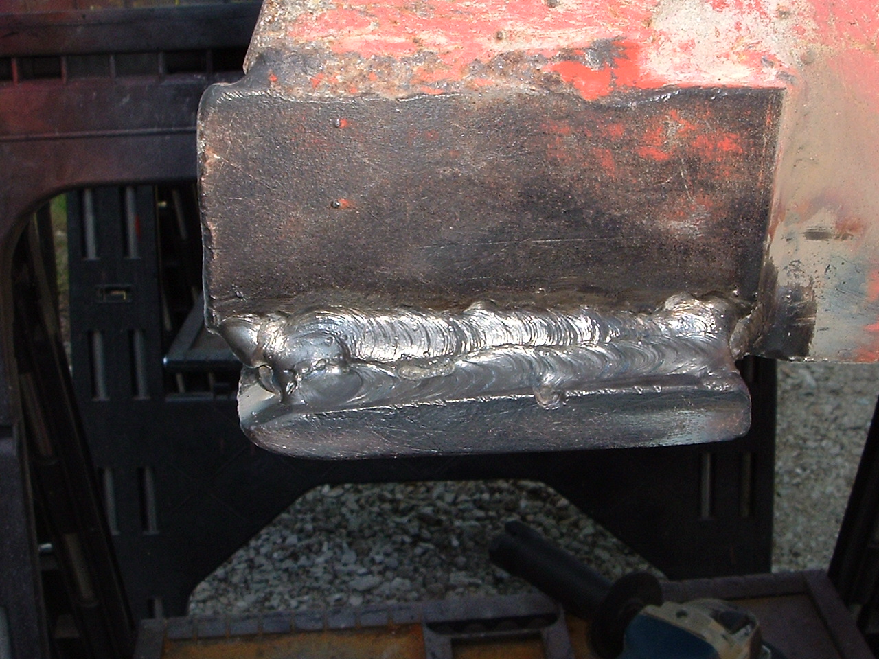

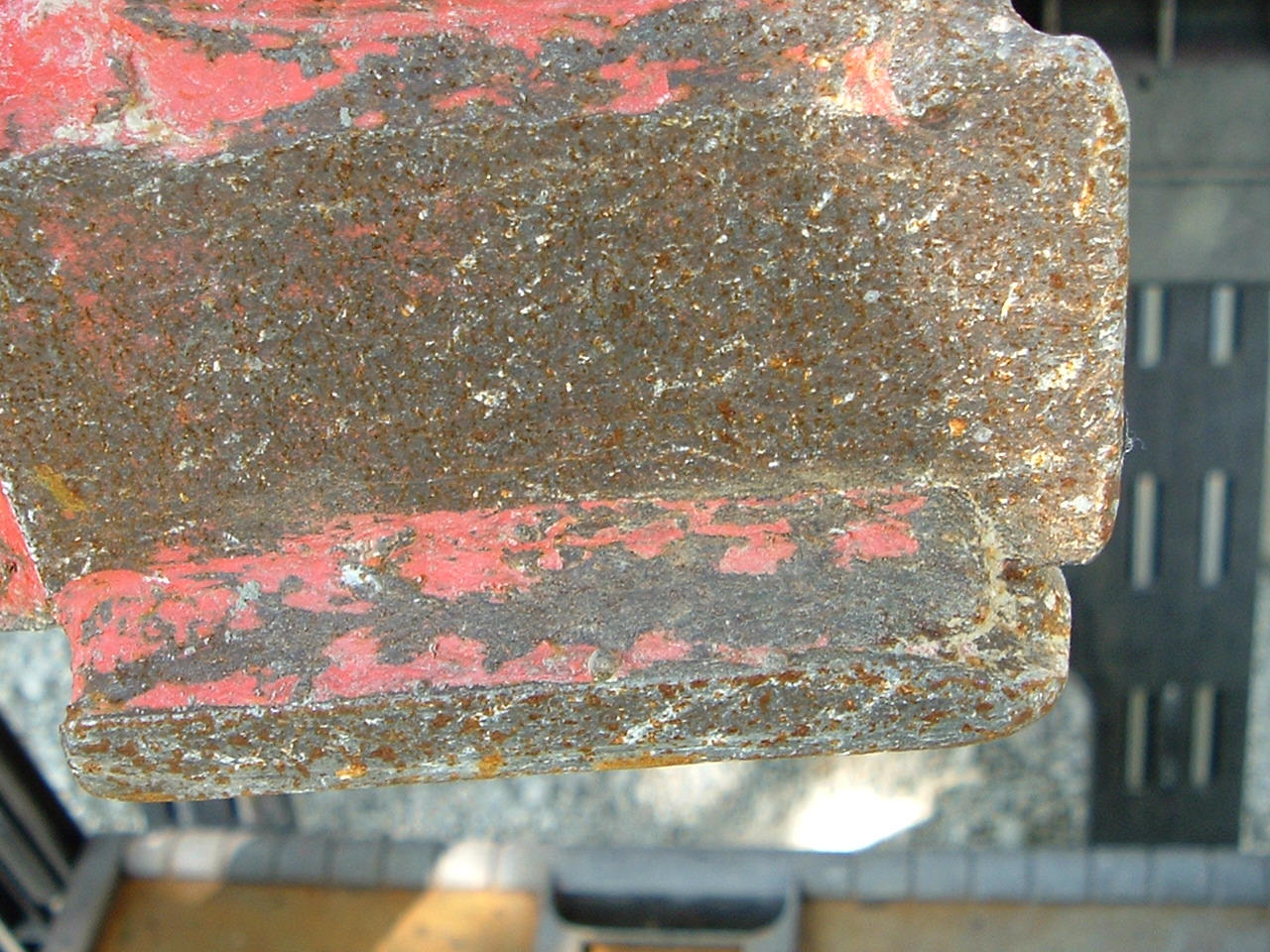

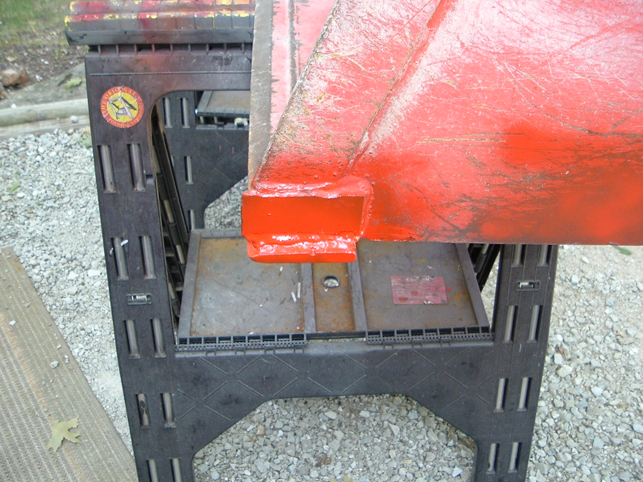

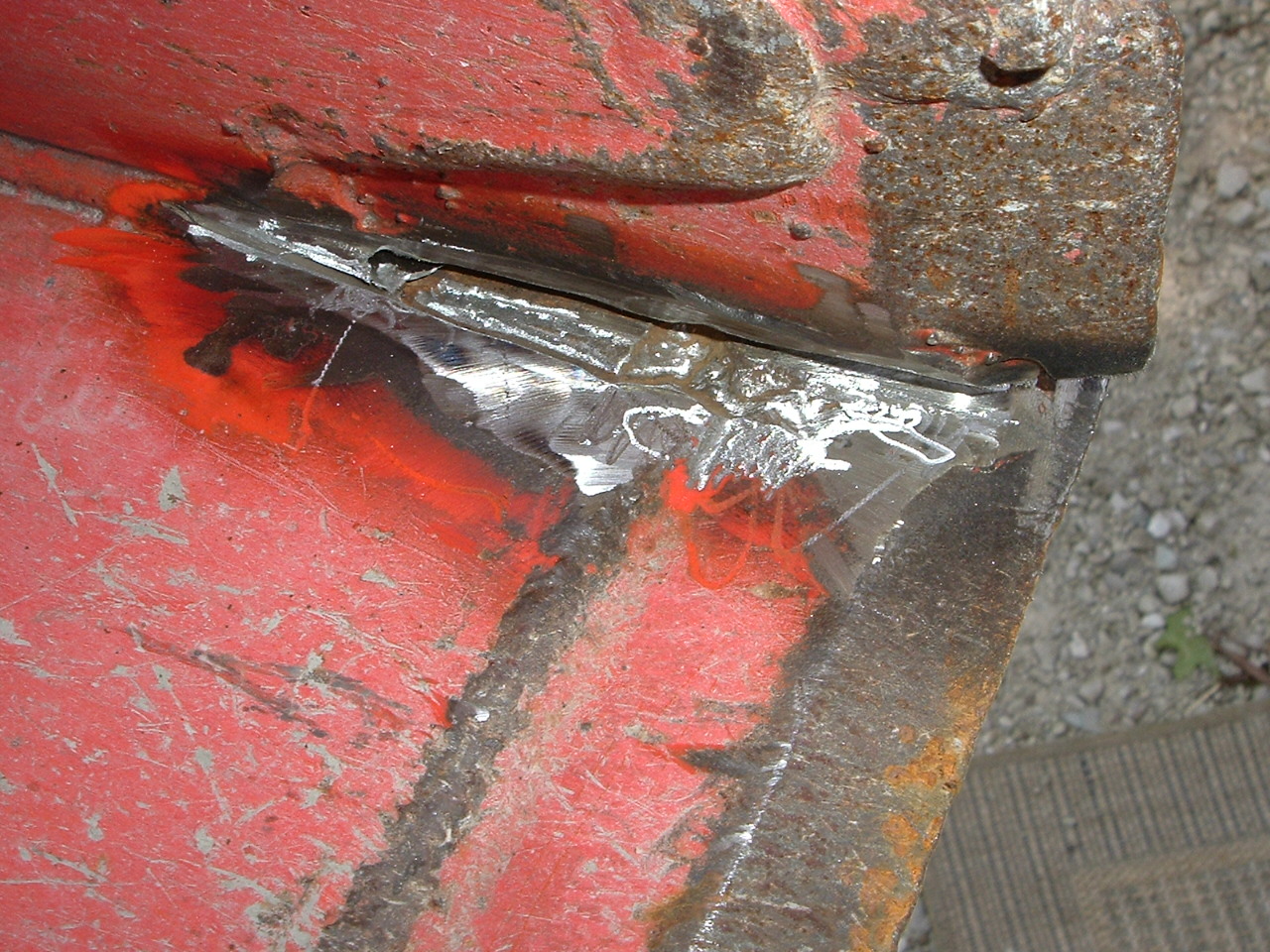

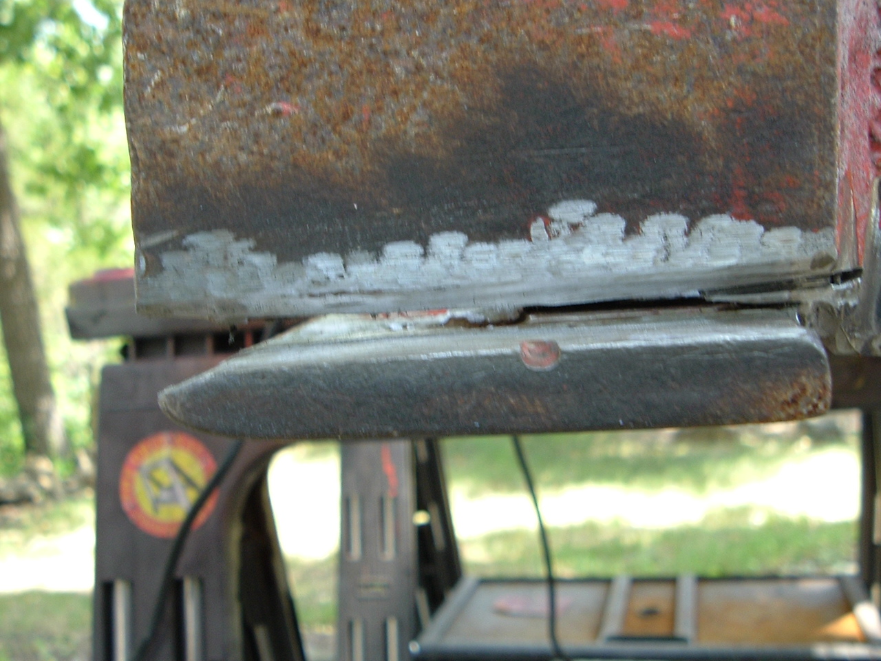

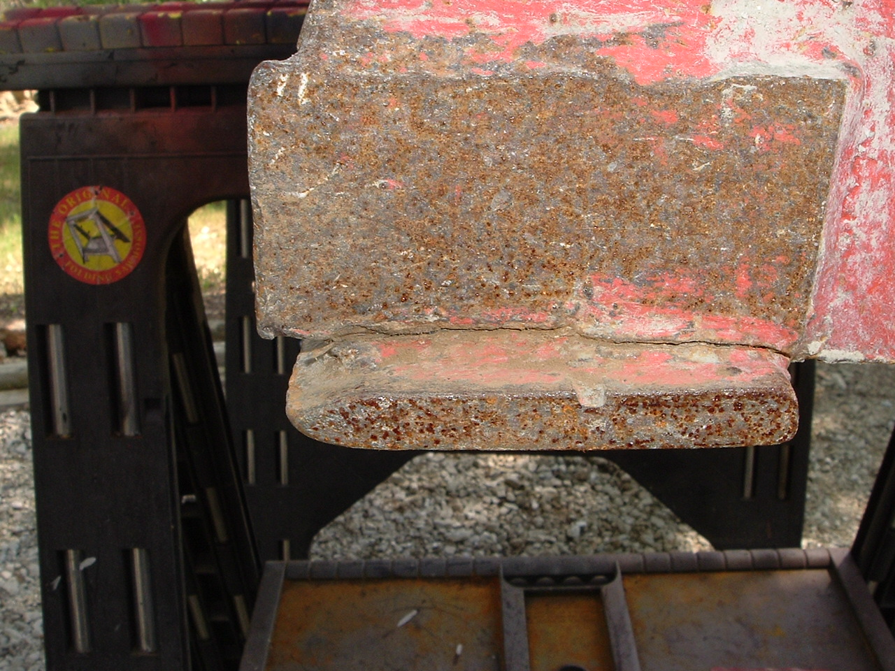

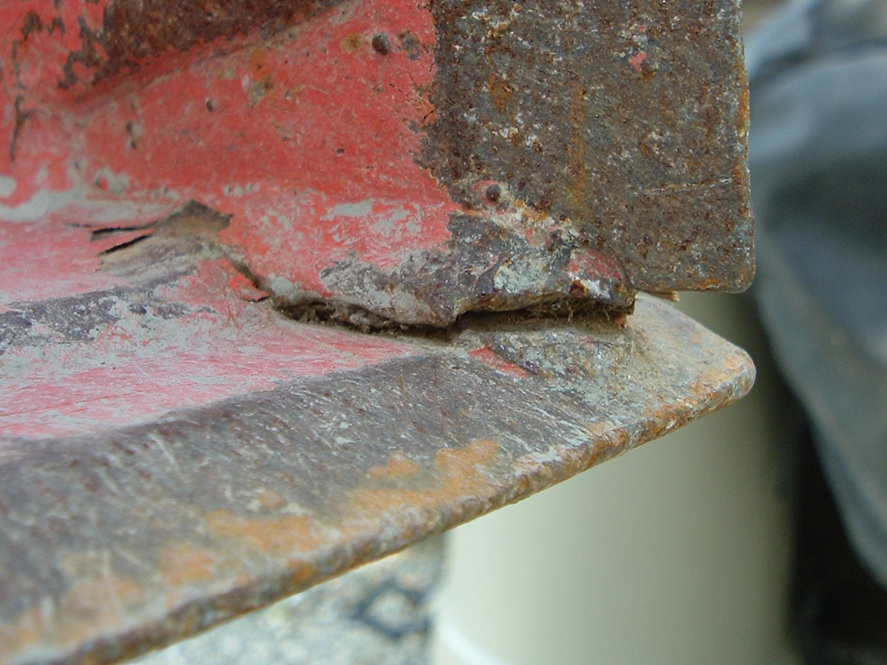

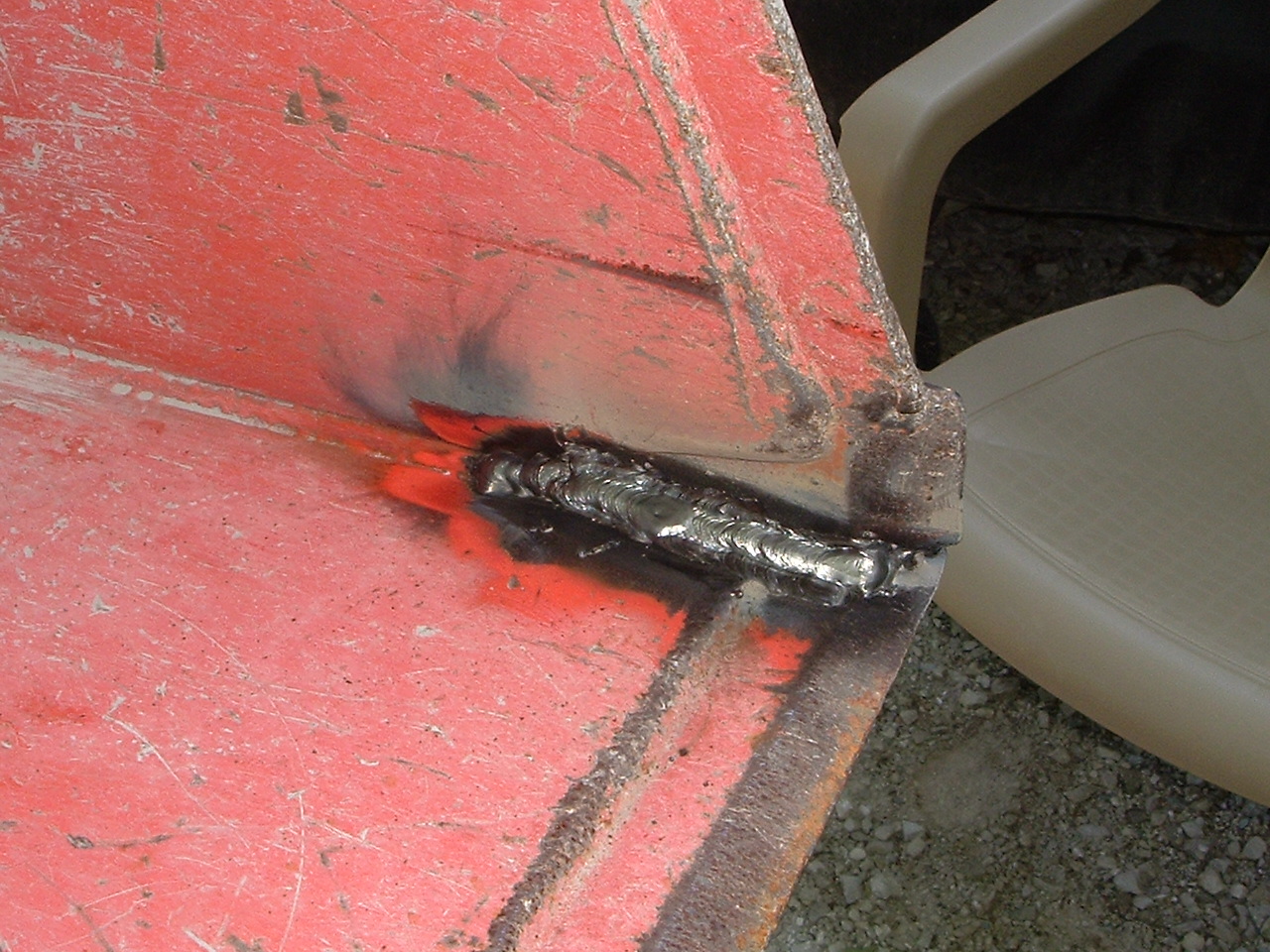

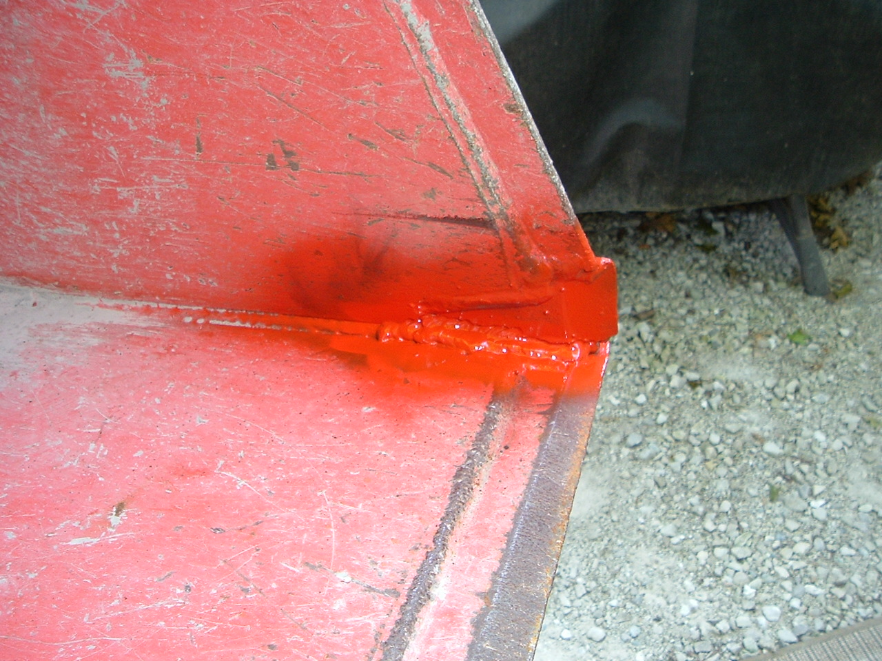

I noticed that the left side of my Kubota bucket (yes I use it sometimes on my new Kioti) had a huge crack all the way thru the factory weld where the horizontal cutting edge is welded to the vertical side cutting edge. When I examined it I noticed the factory weld was not very good compared to the right side see the third photo. Also noticed the crack was much worse than expected when I started to prep for re-welding. A lot of rust had pitted under the weld leaving a crater to clean out and put a lot of weld metal in. I cleaned it all up and re-welded it with 5 rods of 1/8 7018. Good as new... no better than new. Welds might not be pretty but there is a lot more weld metal on this left side than the factory put in. Time will tell how it holds up, but I bet it will. Oh I am not whining or nuthin, but it was well over 90 degrees in the shade, and this old fat boy was sweating.:ashamed:
