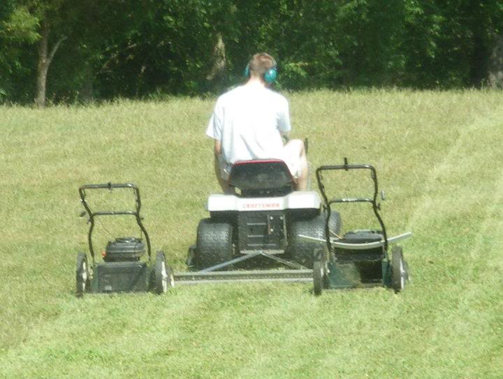

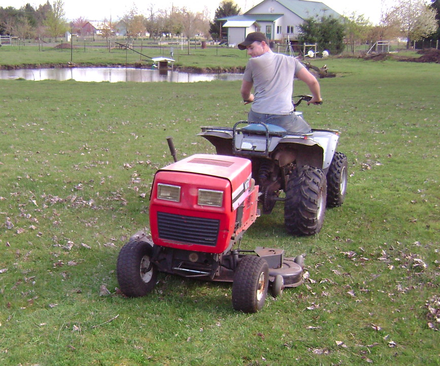

Some cheap ideas:
Use an old push mower, riding mower, or powered mower deck
https://www.youtube.com/watch?v=lvhQUWLlsrk
https://www.youtube.com/watch?v=tZV9CNJO5z0

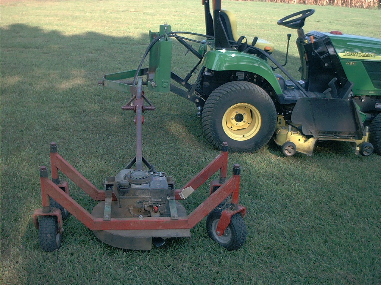

Bob this might give you some ideas if you haven't already seen it
http://www.tractorbynet.com/forums/power-trac/64961-side-mower.html
I think it would be easiest to get a cheap mower deck somewhere and put a pivot on one side. Then attach the other side of the pivot to an attachment plate. After that all you need is a hydraulic motor and hoses
