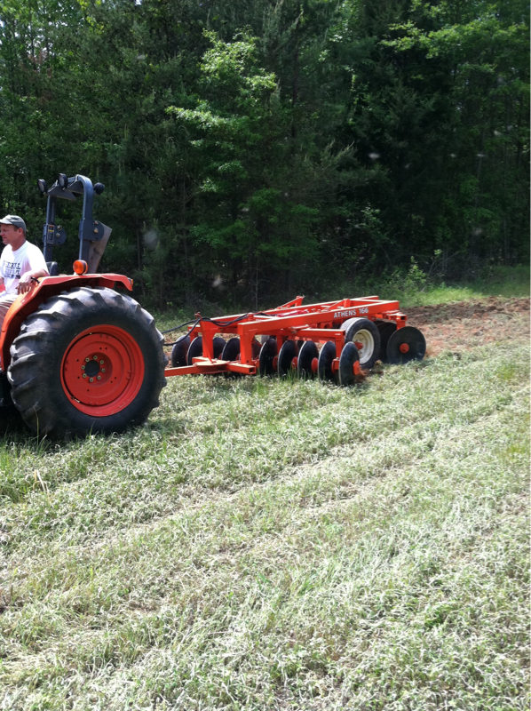

I have an old Athens. Its a beast, works great. But you need plenty of power. My 70 horse Kubota has all it wants when pulling it.

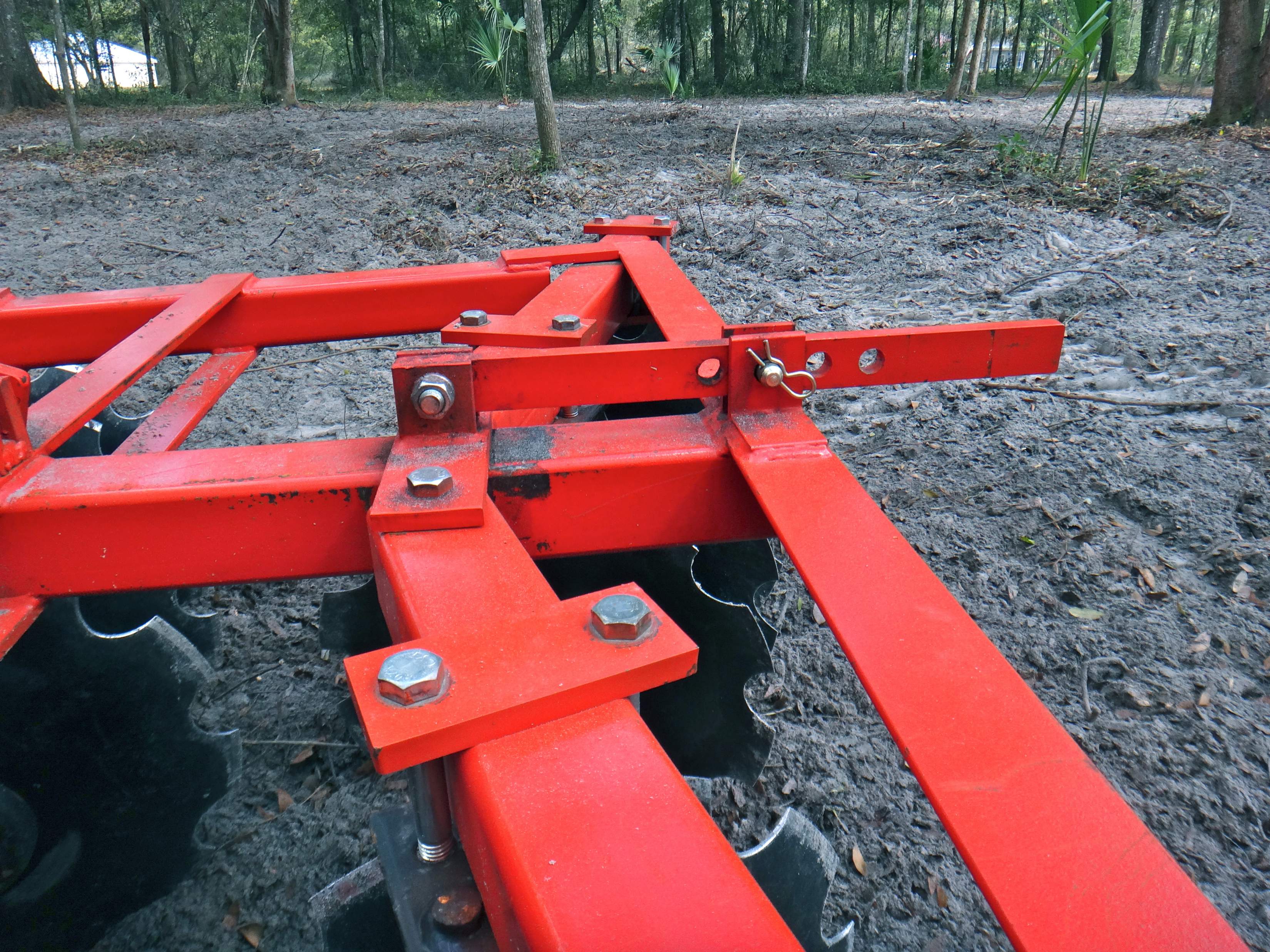

I have a Monroe Tuline 9"~7-1/2" spaced Disc Harrow. It has the adjustment holes in the gang lever and is quite fast to adjust; just one pin to remove to adjust the front gang and an identical pin to remove to adjust the rear gang.
Sent from my iPad using TractorByNet
That is a very nice disc.:thumbsup:
Guessing about 150 lbs. per blade that is what the OP needs. That would be a good size for the JD 5093E.
You describe it as an "old Athens" well a box tube disc frame really is not an old design. I may be getting old but I don't consider your disc to be old.:)
