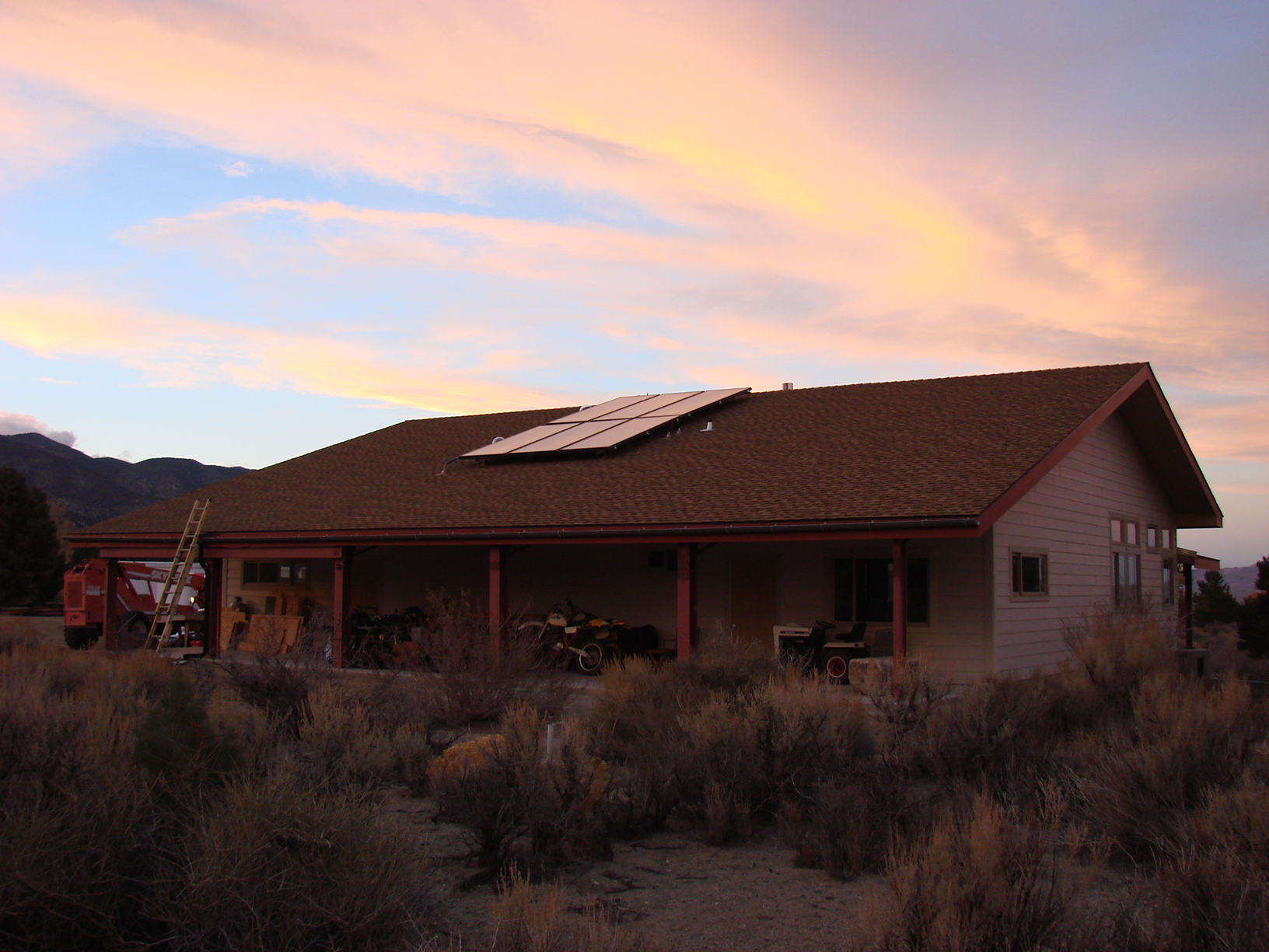

By all means add hydronic radiant in your slab!!! But drive it with thermal solar. Very low cost of operation, also does domestic hot water and there is no heating system more comfortable. Last winter we used three 70 watt circulators, running during the day, to heat our 2,800 sq ft house through the winter. No energy source other than solar. But I also have a wood stove in case we want an evening fire or to take the chill off a surprise cool morning. Now, in the spring, summer and fall months, we have 650 gallons of domestic hot water on tap for occasional bathroom floor heat and unlimited showers. I can't imagine a cheaper or more comfortable heating system! Then, if you need to, you could add a simple air conditioning system that is entirely separate from your heating system. I added a simple duct system and wired the house for air conditioning, but I doubt I'll ever install it.
My priorities in the house design included a steel frame, but most of the structure is 2/6 and 2/8 walls with blown in insulation and blown in attic insulation. Not the absolute lowest heat loss, but totally practical and a structure that is incredibly strong.
I don't like propane, so I only put it in for cooking with the rangetop. I installed a cast iron boiler that runs on oil for backup if needed. Then I modified it to be more efficient than originally designed. We also have an electric water heater that remains permanently switched off unless the solar is shut down for more than about three days or in the event of severe winter conditions for an extended period. In the end, the cost of heating is insignificant

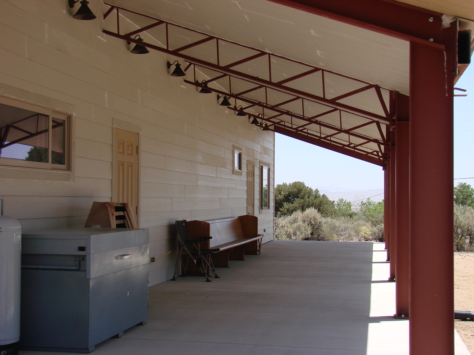

I dug my trench, installed the pull boxes and installed the conduit according to the power company's specs. These were minimum 5' deep to the top of the conduit, approved pull box every 100' and 3" PVC conduit with sch 80 risers. They also wanted a pull line installed in the conduit. Then they inspected it and installed the wire, etc.
My 48 X 60 steel frame came from Miracle Steel (now out of business) and was designed to be a steel shop building. I added overhangs and deleted the external steel siding so I could build it with conventional wood framing. The roof perlins are 2X10s sitting on 24" centers on steel trusses placed on 12' centers with a 4 & 12 pitch. Roof is double sheeted with OSB.
