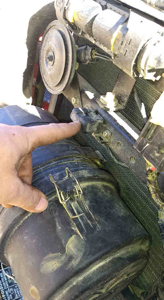

Sorry about bumping an old thread, but where is the obdii port on the 2555 hst? I bought mine second hand and the original owner lost the manual.

No clue on that machine but OBD standard would have access from the seat. So I’m guessing up high and back under the hood so you can read codes from the seat. A long shot would be on the back side of the firewall. I’d also look near the fuses.
I’m sure someone who can say for sure will weigh in- like I said just some ideas if you are needing to find it now.

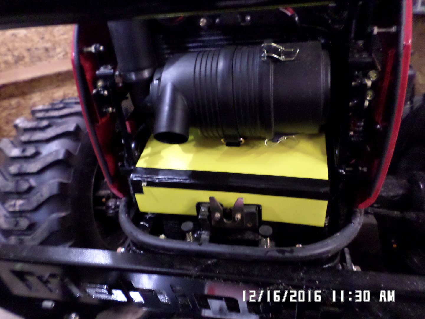

Open up the hood. OBDII port is dead center above the battery/air cleaner facing forward. Has a black cover on it and is a little hard to see if the hood is blocking your barn lights, and if you have 'old eyes'....... [ sniff, sniff-sniff ] :) [ in the below picture it is at the very top center... ]

That is priceless info. Thank you! Unfortunately the daylight disappeared before I returned home today. And, my barn isn't built yet (though materials are all here). This time next week I won't have that excuse! I'll post back tomorrow, if the process isn't overcome by other events.
/ OBD Code Reader #33
@jerryk - that was it! Right where you said it'd be. Now I have to find my BT OBDII thingy I bought over a year ago...
