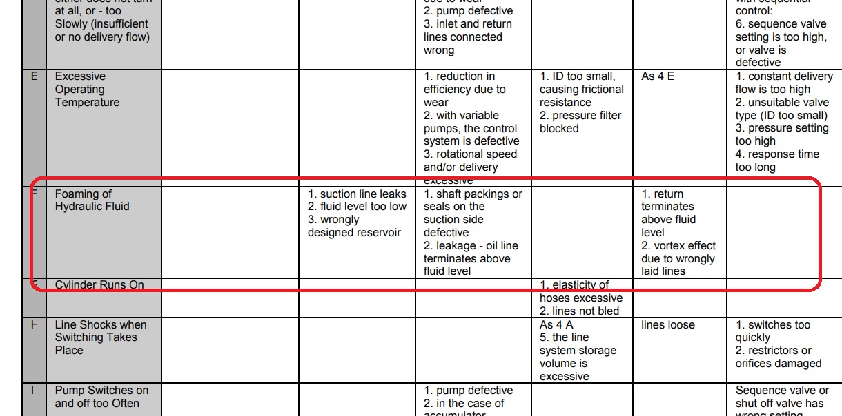

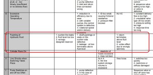

Justman777 is exactly correct here and may be pointing to the problem.
Hydraulic fluid return should not be terminating above fluid level in a reservoir. So this spraying noise in the reservoir that has been noted is suspicious, and could be a tel tail. have a read of chapter 6 here CHAPTER 6: Hydraulic reservoirs | Hydraulics & Pneumatics
and more directly/simply, this troubleshoot row from a different manual.
Standard practice to terminate below fluid level. Perhaps there is a blown o-ring or crack of sorts on the return line to the sump that is causing this spraying. If anyone had a sump drawing of this tractor, would tell a lot.
   / NX6010 suction side hydro leak #119
Thanks for the link plus the red lined info.
After reading the page
Tank functions
The main reason the reservoir exists is to store fluid. The accepted rule for sizing a tank is: the tank volume should be two to four times the pump flow in gpm. This is only a general rule. Some circuits may require more volume, while less fluid may be adequate for other circuits. A 25-gpm pump would work well with a 50- to 75-gallon reservoir for most circuits. With this general rule, the returned fluid theoretically will have two to three minutes in the tank before it circulates again. As Figure 6-5 shows, a baffle separates the return line from the pump inlet line, forcing the fluid to take the longest possible path through the reservoir before returning to the pump inlet. This arrangement also mixes the fluid well and provides more time to drop contaminates and de-aerate. In addition, the fluid spends more time in contact with the outer walls of the reservoir to dissipate heat.
So our NX has a 17.9 gpm pump system and the sump should be two to four time larger for reasons stated above. The NX has a 12 gallon or so reservoir. No doubt more then this basic premise goes into fluid mechanics for a machine. Thanks to this info am glad to have used NAPA's synthetic fluid.
But the table does reflect our issues rather well.
Will be sharing this thread to my dealer next month to help accelerate the learning curve.
