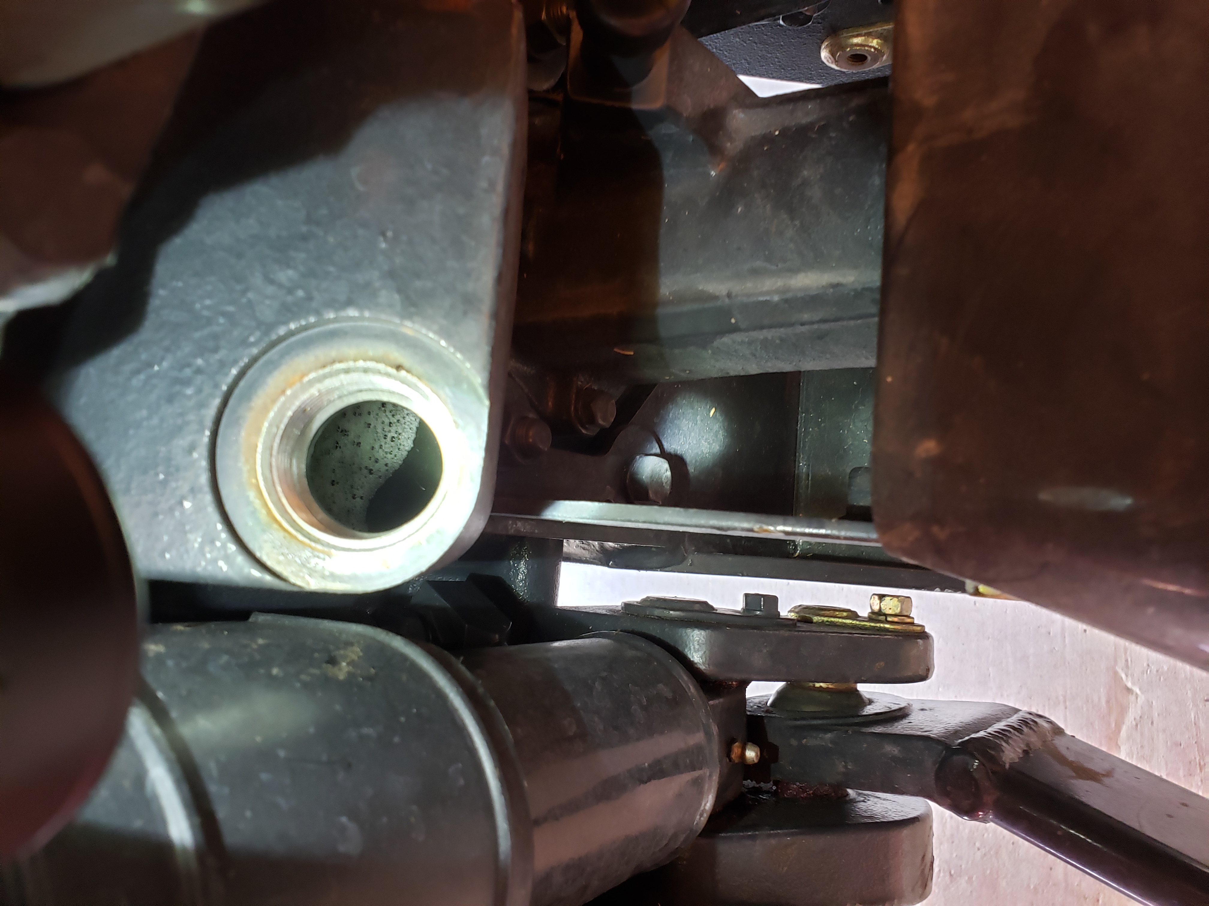

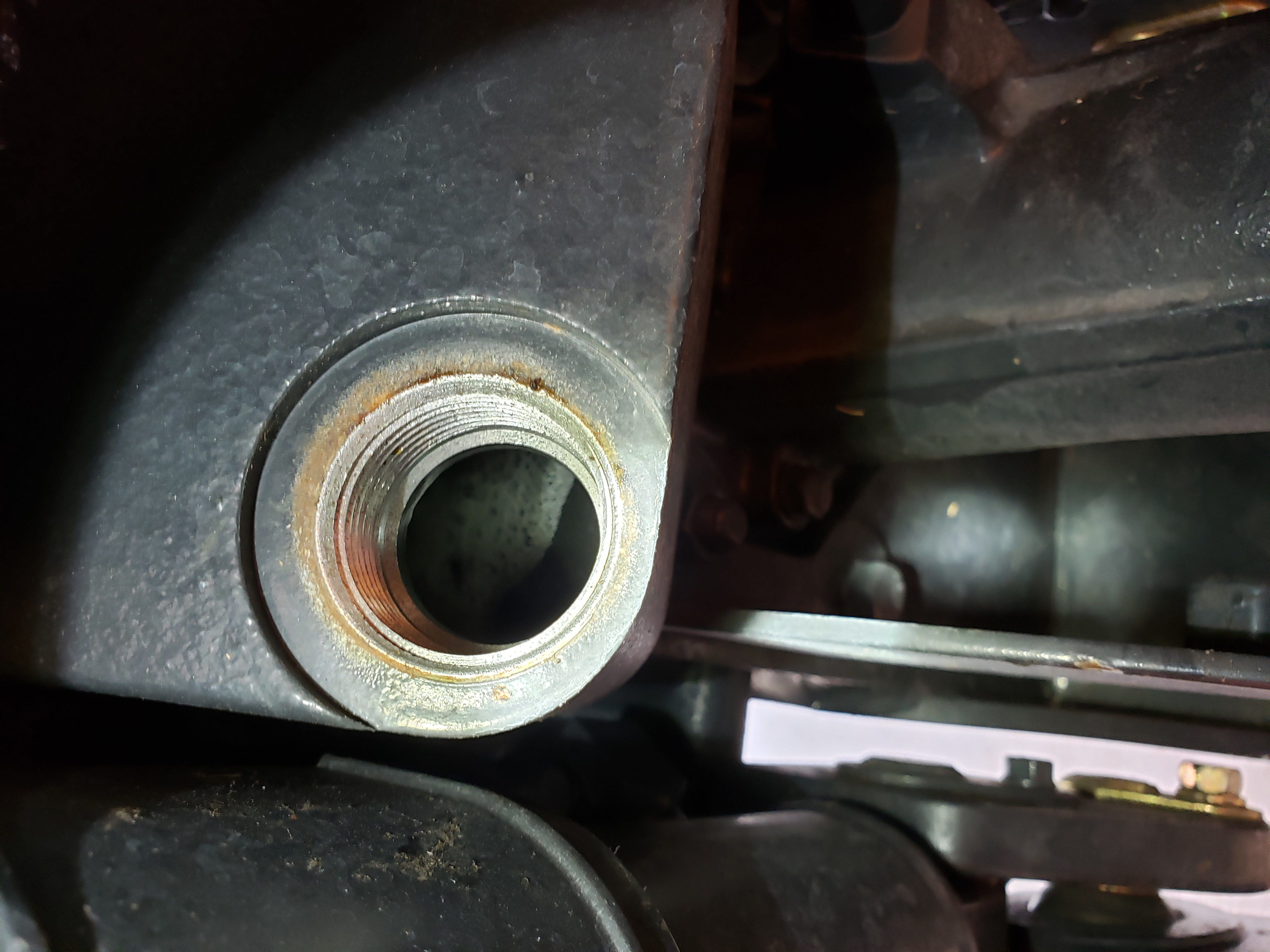

So hopefully I did not brain fart and miss any photos. here are a few revealing the foaming of the Hyd. fluid at the fill port.
So here is a short narrative. Drove it out of shop to under awning and let it idle.
Removed fill plug and one can hear a noise distinctly different then when simply placing the plug over the fill port.
Using a flashlight I can observe fluid spraying and creating the bubbles building to a nice head like on top of a beer glass.
Once engine is shut down the bubbles quickly disperse and goes to a liquid with no indication of any bubbles.
Well that's it for now. Have to remove duct tape adhesive from shop rubber flooring mats.
Stay in the (duh) shade folks....:drink:

Can someone who is NOT having this issue post your results as well, for comparison purposes?
Thanks YLee!
