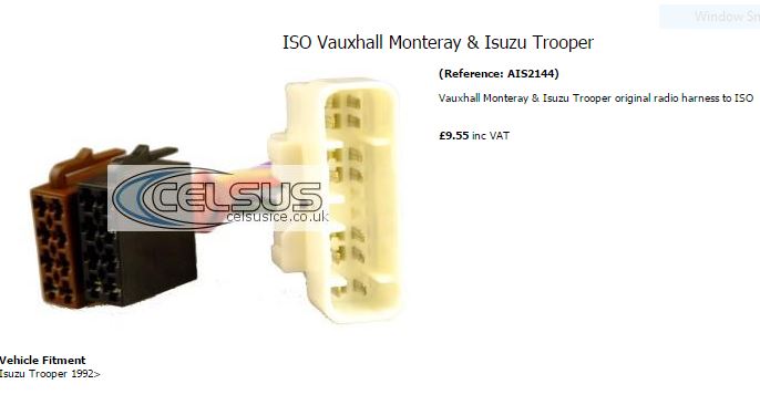

I know I'm coming into this thread - way after there have been many answers - but for anyone in Europe (and possibly the US too) looking for a plug and play solution, then the answer to convert the Original Radio Harness in the Cab version of recent Kioti Tractors To ISO connectors is the Celsus AIS2144 connector.
Just search Google for "Celsus AIS2144" and you should get lucky.
Mine worked like a charm.
If you can't find that, then search for "ISUZU RODEO, TROOPER 1995 ONWARDS ISO WIRING HARNESS ADAPTOR"
That should give what you need.
Below is a picture from the Celsus website.

Diesel, I just looked at the factory OEM connector that I snipped off when I hardwired my aftermarket radio. Comparing it to what you linked to, I can't tell from the picture whether it would mate up. Instead, I think I'd order one of these, which sounds more like what Mudplugger referred to: Amazon.com: Scosche Radio Wiring Harness for 1995-Up Isuzu/Honda/Acura Connector - Sport Utility Vehicles: Car Electronics It's for Izuzu Rodeo Troopers 1995 on. At $4.95 incl. shipping, you wouldn't be out much, and the reviews are better.
Can't help you on the speaker question, but I'm sure someone else can. I recall a TBN thread on it somewhere, awhile back. I think the stock speakers are fine for a tractor, even with a cab. Especially while wearing ear protection! But since you'll probably be removing the cab roof for access to install your radio, now is probably the time to switch them. BTW, you'll need a second person to lift the roof clear. It's heavy. You may also be able to get enough access, at least just for installing the radio, by propping up the roof. I did my install from inside the cab, but my radio is light weight, so I didn't need to use anchoring hardware on its backside.

This is what you need.
Celsus ICE - car audio accessories
This is for those in Europe - but it is available from Amazon... and in the US - search for "Celsus AIS2144"
Straight plug and play for me - a digital audio player/radio with ISO connections.
No wiring, needed, just plugged radio into the ISO connectors and then the main connector into the loom, added the antenna connection, and it worked fine.
It's lightweight radio unit so was able to do whole fitting in about an hour, no roof lift.
Hardest bit was accurately cutting the hard plastic cover to fit radio into that, because the stock opening behind the cover plate was just a bit too big.
Isuzu and Honda also used these connectors apparently.

mudplugger, that connector appears to be identical to the one Threepoint noted.:thumbsup:
/ NX5510 radio plug? #54
Yes it is.
The Celsus version had the ISO connections too - and correctly pre-wired, so even less messing about. :)

Finally getting around to install a stereo. Just parsed out all the wiring stuff and thought I'd add a note here on the Isuzu harness (IU02B).
Everything is a fit except that you have to connect the "Front" speaker wires from that harness to the stereo's "Rear" speaker wires. It's not an issue with the Isuzu harness but of Kioti's pin arrangement: from Kioti's schematics (mudplugger, once again, many thanks for the electronic copy of the service manual!) they put the rear wires in the connector where (by apparent standards) the fronts should go. If you were to wire the connector harness to the stereo according to the markings on the connector's and the stereo's wires things would work, but the stereo would only produce sound with the fader set to "Front," which would be kind of confusing (when there's only speakers in the rear of the cab), though it would still work.
I'm going to wrap this up and call it a success, though I haven't wired it up yet: I did test the wires with the connector harness plugged into the tractor harness and everything checked out.
Now I need to figure out how to physically mount the stereo! (and I thought the wiring was going to be the tricky part!) Going to start a separate thread.
