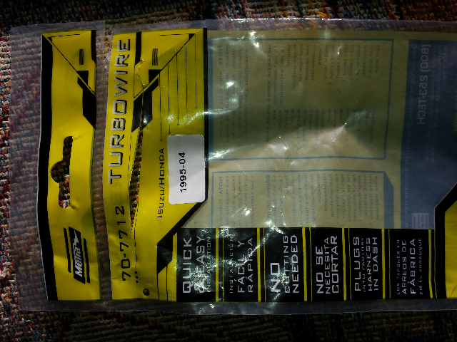

From Amazon I ordered the 70-7712 kit as well as the 70-7713 kit because the 13 kit looks like it may have the RCA wires on it already.

Received both kits. The plugs look identical, but the -13 kit's plug is ever-so-slightly larger.

AnyOne know if there is a wiring harness available that will plug into a factory kioti one? I'm just about ready to install the new stereo and hate to cut the factory plug off the harness if I don't have to.
Would that be on a dealer installed cab you are talking about, or maybe one from the factory? I just stuck a radio in my dealer installed cab for my new CK2510. I gave up on the store bought plug because after a search i failed to find one. I ended up taking the plug off with cutters. I would say whatever you do do not hardwire that radio in your cab. put those little individual slide connectors in because you will need to get tha radio out at some point for sure. btw ebay has hidden radio antennaes for under $4,00 that work fine and slide right up in that compartment. Also, you will need some 4" speakers from Napa or somewhere because those nice things that seem to look like a speaker in that dealer cab are covers only.
