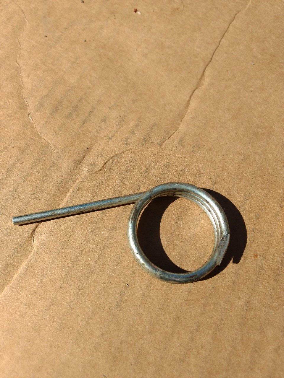

After a little while I found that, once again, the forward travel pedal wasn't properly returning to its neutral position. The pedal, however, wasn't hanging up (so THAT issue is resolved!). It's more like the return springs are weak. I continued to mow figuring that I'd look at it, again, later on. And then I stomp down on the forward travel pedal and I hear a popping sound and the pedal goes limp! Forward travel wasn't possible so I figured I could pull up on the pedal and use reverse to get myself back home. Nothing doing! NO TRAVEL WHATSOEVER! Grr! Got my wife to steer the Kioti while I towed it (in reverse) with the B7800 (almost 1/4 mile). So...

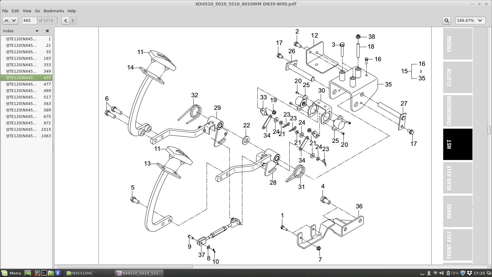

I KNOW that one of the return springs toward the back shaft is dislodged; no idea yet how I can get it reseated. But, not sure on the bits that work with the potentiometer, why, when pulling up on the forward travel, I couldn't get reverse travel.
Page 6-31 of the service manual has the diagram of all the bits. Item #28 is what I messed with (gapped it open a tad more). Item #31 is the spring that is no longer tensioned: hoping that the #17 bolt is the pin/stop and that I can back that bolt out, wind up the spring and then thread the bolt back in (to hold).
I think that shortening up the travel rod ("turnbuckle") should help the pedal to return to the neutral position: manual says it's supposed to be 171mm; wonder if the dealer messed with this? (I have not adjusted it.) I'm concerned, though, that the springs are still weak, and with the one popping out/off I don't know that it won't do this again.

Broken spring:
Looks like this was defective to start with as the break is dark like it's been fractured for a while and then finally gave up.
Getting at this thing is a HUGE pain. Have to disconnect connecting rod and the pedals and drop the assembly down (where it's still harder than heck to work on). Not sure how I'm going to get it all back together...

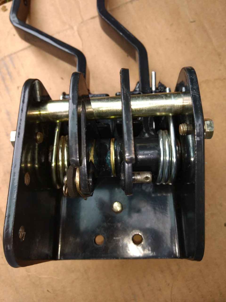

Managed to get everything back together. I wasn't able to figure out how to disconnect the wire harness for the potentiometers in which case I removed them as attached to their mounting bracket from the pedal bracket: doing so meant having to reattach tiny linkage bits (to the potentiometer); good luck if you have fat hands- ain't going to be able to do it! (pray that none of those retainer clips ever pops out!)
A few things I found troubling (well, besides the broken spring!):
1) The nut for the potentiometer linkage for reverse was loose (that linkage piece was bent, likely due to being loose);
2) Bushings that go into the pedal linkage sleeves are multi-piece, two of them, and they shift around: I thought that I as missing one (forward pedal), only to find that it was slid over toward the other side- this could provide for slight racking along the mounting shaft; I pulled it back toward the outer edge (will it stay there?);
3) The return springs wore grooves in the shoulder (outer edges) of the pedal arms (have to zoom in); I can only wonder whether the springs are binding into these groves (pinching between the arm and the bracket):
Here's the exploded diagram of all of this:
