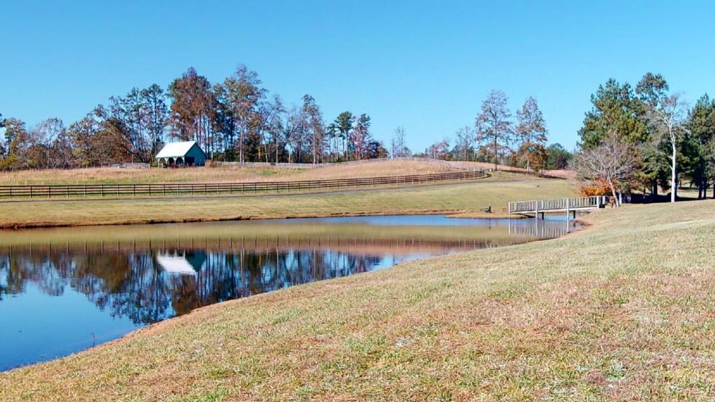

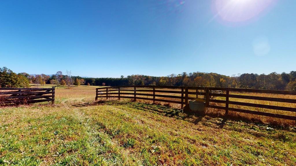

So my wife and I are moving to Tennessee. As many have done lately it seems. Problem is we went from .7 acre to 80 acres :eek: if the deal works out
Congrats on your new way of life! I made a similar transition nearly three years ago, from the Atlanta suburbs to a piece of land in rural north Georgia. The only way I'd go back is kicking and screaming.
I'm going to suggest a slightly different approach to the tractor question: Two.
1) An older, heavy, 2wd, plain old gear tractor mostly dedicated to bush hogging and anything that needs to be pulled and/or run via PTO (plow, tiller, etc). Something like a Ford 2810 or 2910. Heavy, with 35 to 40hp. Capable of handling a 6' bushhog.
2) A new compact or subcompact TLB (tractor/loader backhoe). Maybe with a mower deck.
Those two machines will cost about what a single, larger, new tractor will cost, and you'll gain a lot of versatility.
Also, based on the pictures, a lot of the property looks well tended. You might need a zero turn mower as the second machine.
Whatever you do, good luck with your new adventure!
