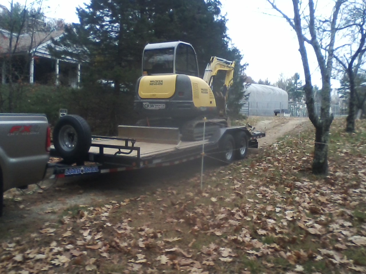

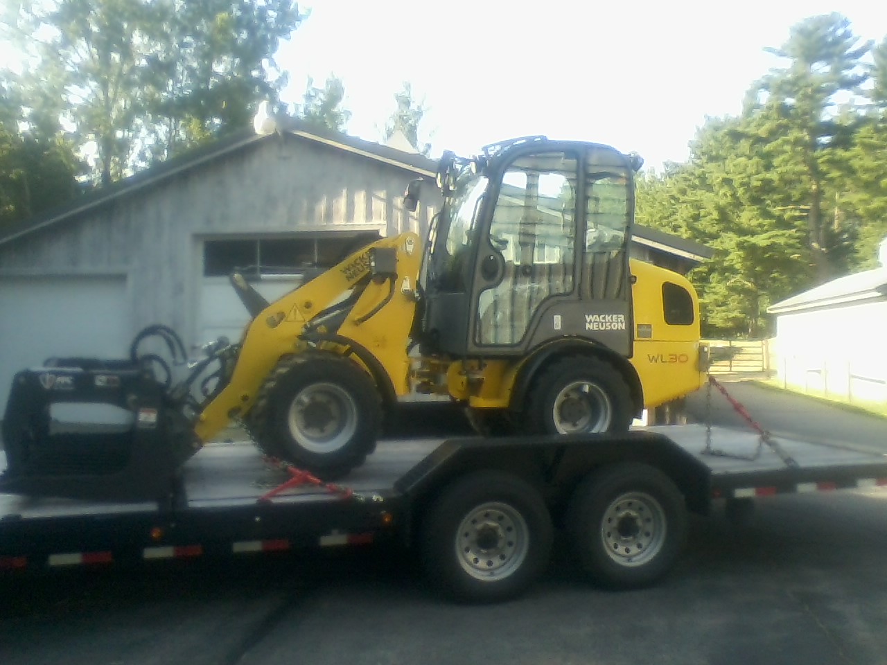

If and when I need a grapple I run to the wife's work and pick one up.............. 0828160917-00.jpg
