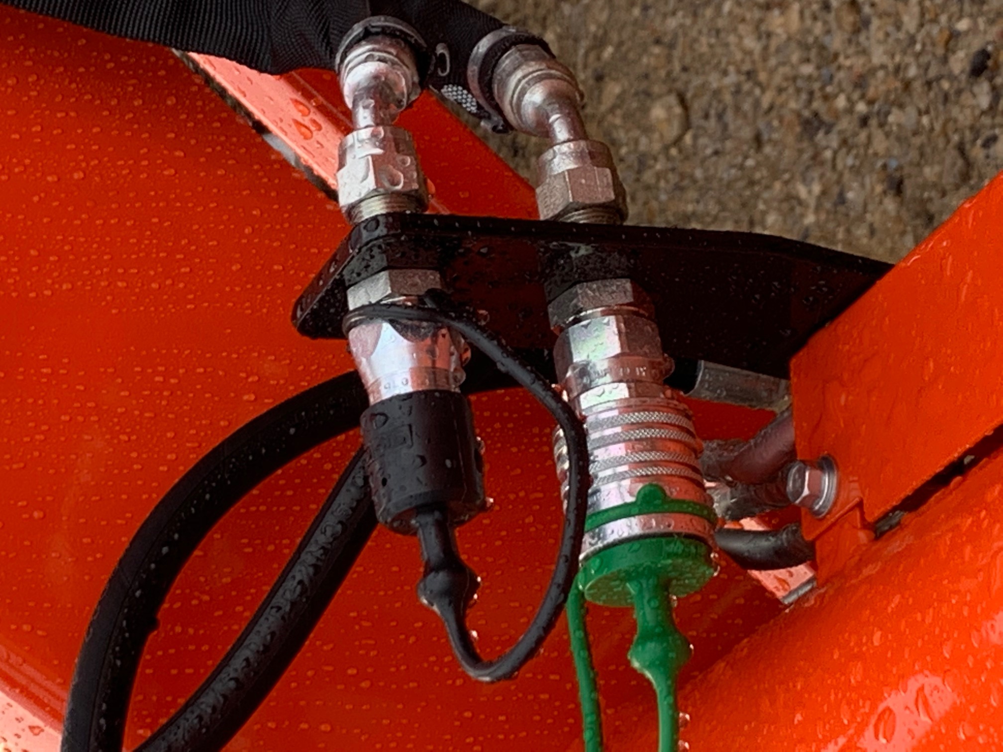

when my 3rd function kit was installed. Kubota dealer installed male fittings on the hoses.
When the grapple arrived. it also had male fittings on the hoses. So, I had to go buy two female fittings

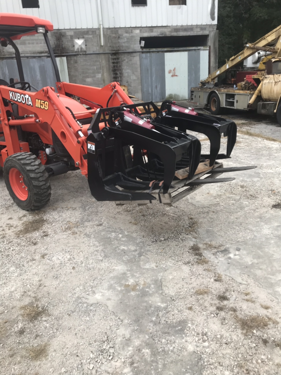

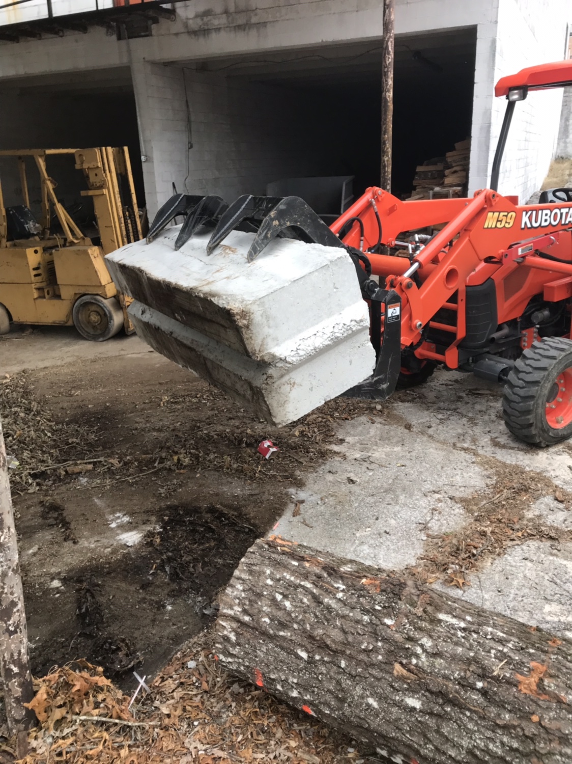

The grapple on my M59 is a Favor grapple. It wasn’t cheap either at around 3 grand but it’s high tensile steel construction and lightweight. It’s around 600 pounds and it’s rugged built. The M59 has twice the capability of the machine in question and it has no chance of damaging this grapple. IMG_7847.JPGIMG_7688.JPG

Boy Howdy I am really finding out things I didn't know, I didn't know. Here are the connections they put on. I am assuming these are the correct fittings.

Those look like the right ends, you just need to get fittings on your grapple to match.
The comment that Koua made about diverters is spot on. That's what I have and while it does work, I have to constantly remind myself that I can't curl and open or close the bucket at the same time. I'm constantly losing my load because I forget... But they came on the tractor, so I'm not complaining.
I believe that Messick's sells Artillian, if you think that's what you would like. It appears they may need more plumbing after all though... Artillian HSM-SPM4P-F This is the diverter kit which you're referring to.

Yep, those look fine, now just tell the grapple supplier you need a male and a female AG also known as ISO-5675 also known as Pioneer.
