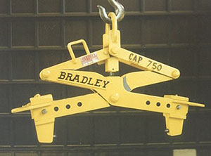

BradleyTong.jpgI know there has been much discussion on the best way to remove old fence posts. I have a big project planned for fence post removal. I was trying to think of a good way to do it. Has anyone ever used tongs to do so? I found this lifting apparatus. I thought it would work great if you could attach this to a FEL. You could probably pull up fence posts rather quickly. What do y'all think? The web site is Bradley Lifting - Material Handing Below the Hook Grab Lifting Devices.

Neat, but at what cost? Looks kinda expensive, especialy with the liability attached to a lifting device. If you can build one yourself...

I think you better have a big set of tongs to lift the bag of cash you'll have to pay for both the tongs and the tractor that can handle it.;)
Seriously...how many posts and what type? If you are talking T-posts and a few wooden posts, you don't need a device like that. That is for repetitive industrial lifting. Most any CUT can pop most posts out of the ground with the 3PH. I've pulled crossties down 3 feet and set in concrete with my FEL.
Sub-compacts might have some trouble with wooden posts, but they will also have trouble just getting that rig in your link off the ground.:rolleyes:

But you gotta admit. . .it looks pretty cool!!

Yep, pretty cool, but will require a second person on the ground to hook it up. I've pulled up old fence 2 ways, a) chain with a slip hook wrapped around the base of the post, b) if you dont want to save the old boards, take a chain saw and cut the boars off of each post so that you still have a piece of the board nailed to the post, set the lip of the bucket under one of the board pieces and curl or lift the bucket, works great, and you can do it by yourself. :cool:
