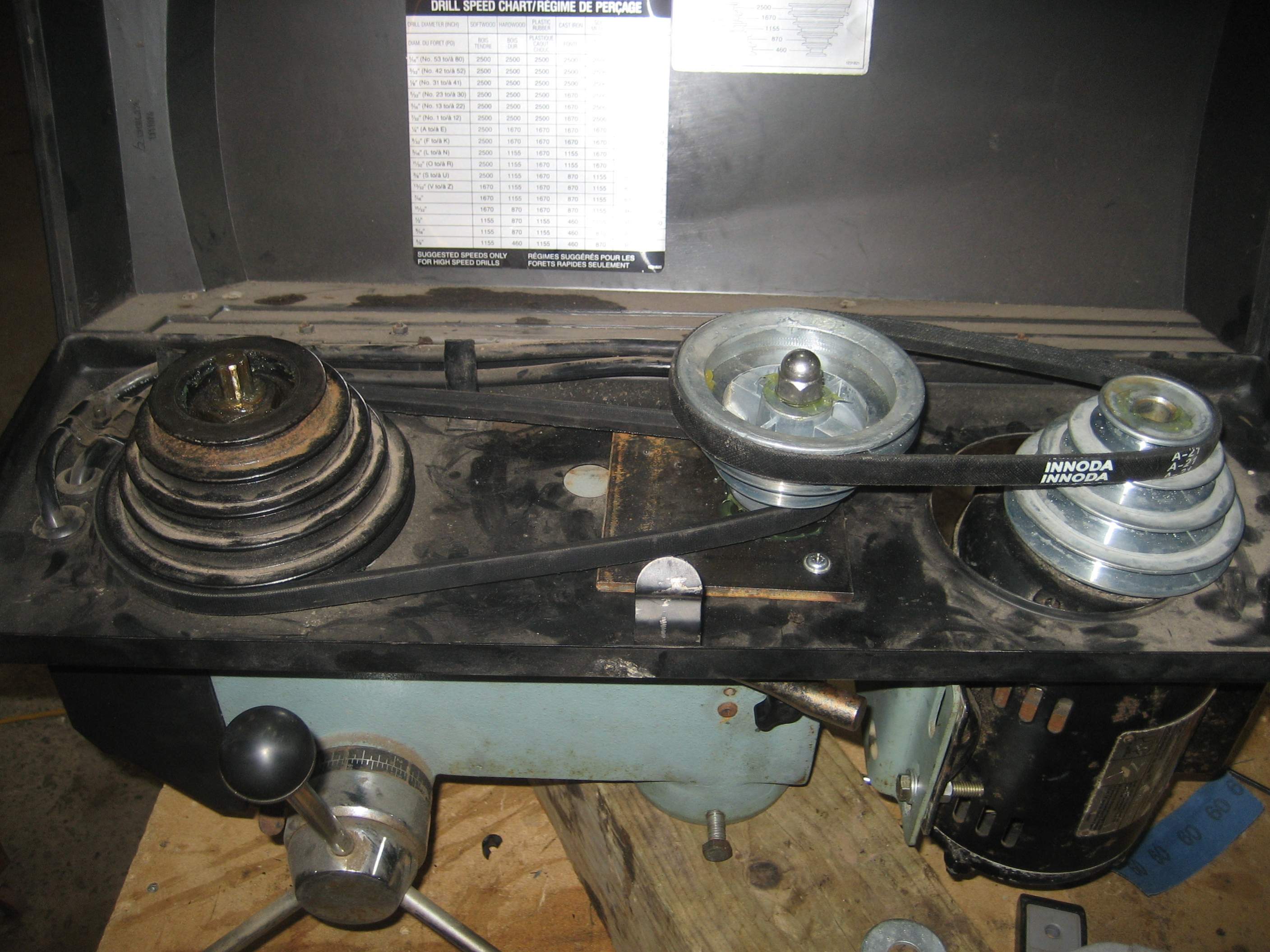

Is that a ball bearing pulley you are using for the additional speeds.
If it is, where did you purchase it ?
no it isnt.. i would have rather used one but was in a bit of a rush to rig it up and try drilling the holes.

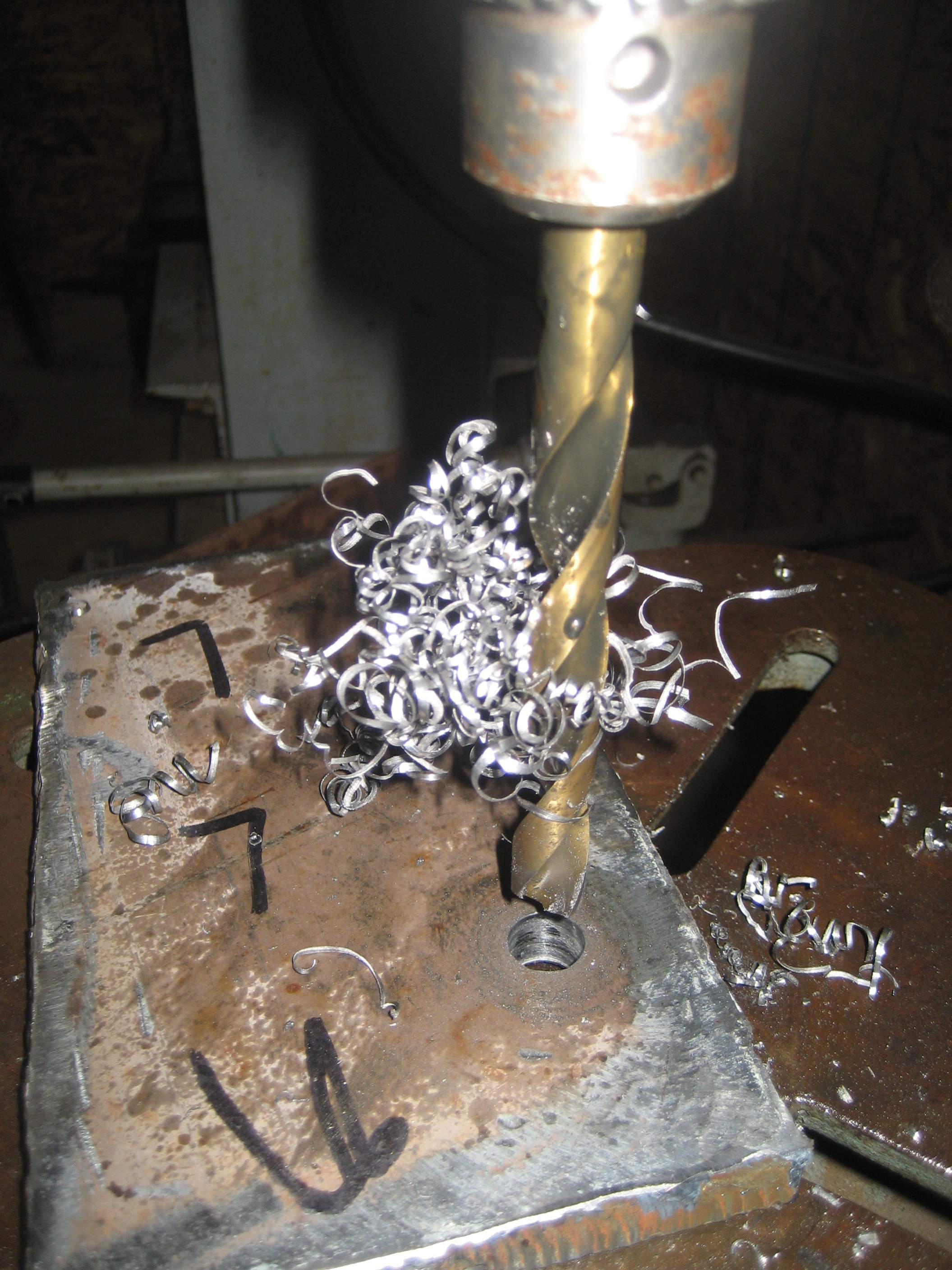

Drill press worked good in 1/2 thick material with the 1/2 bit..no problem, no smoke what so ever. I used chain oil for the lube..spray a little at the top of the bit and start drillin..sticky chain oil works it way down the bit slowly..I hate reaching for the can constantly while drilling.

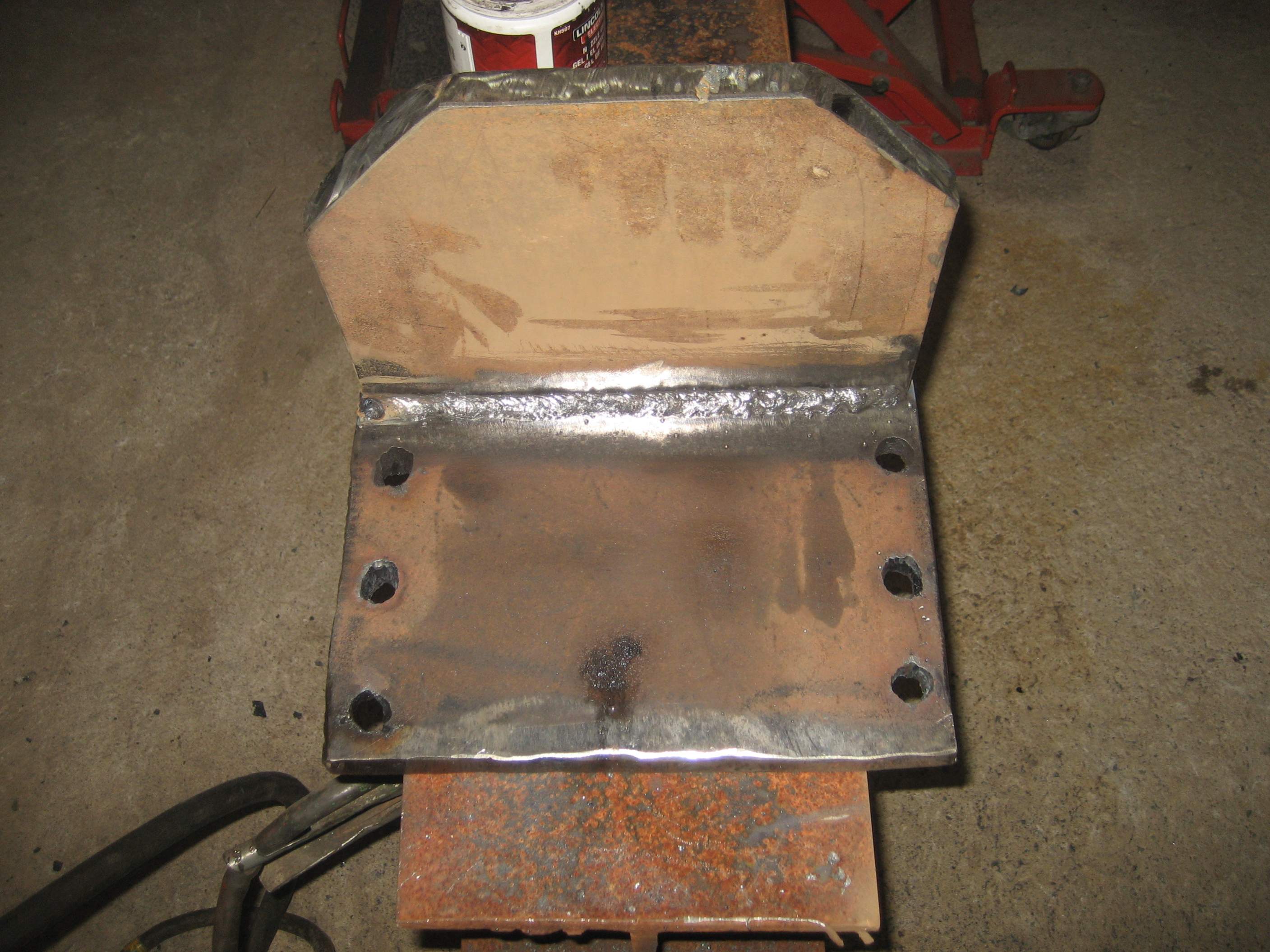

..Got all the holes drilled and pieces cut for pusher plate slide assembly..Know just need to get some grade 8 hardware to bolt it together..

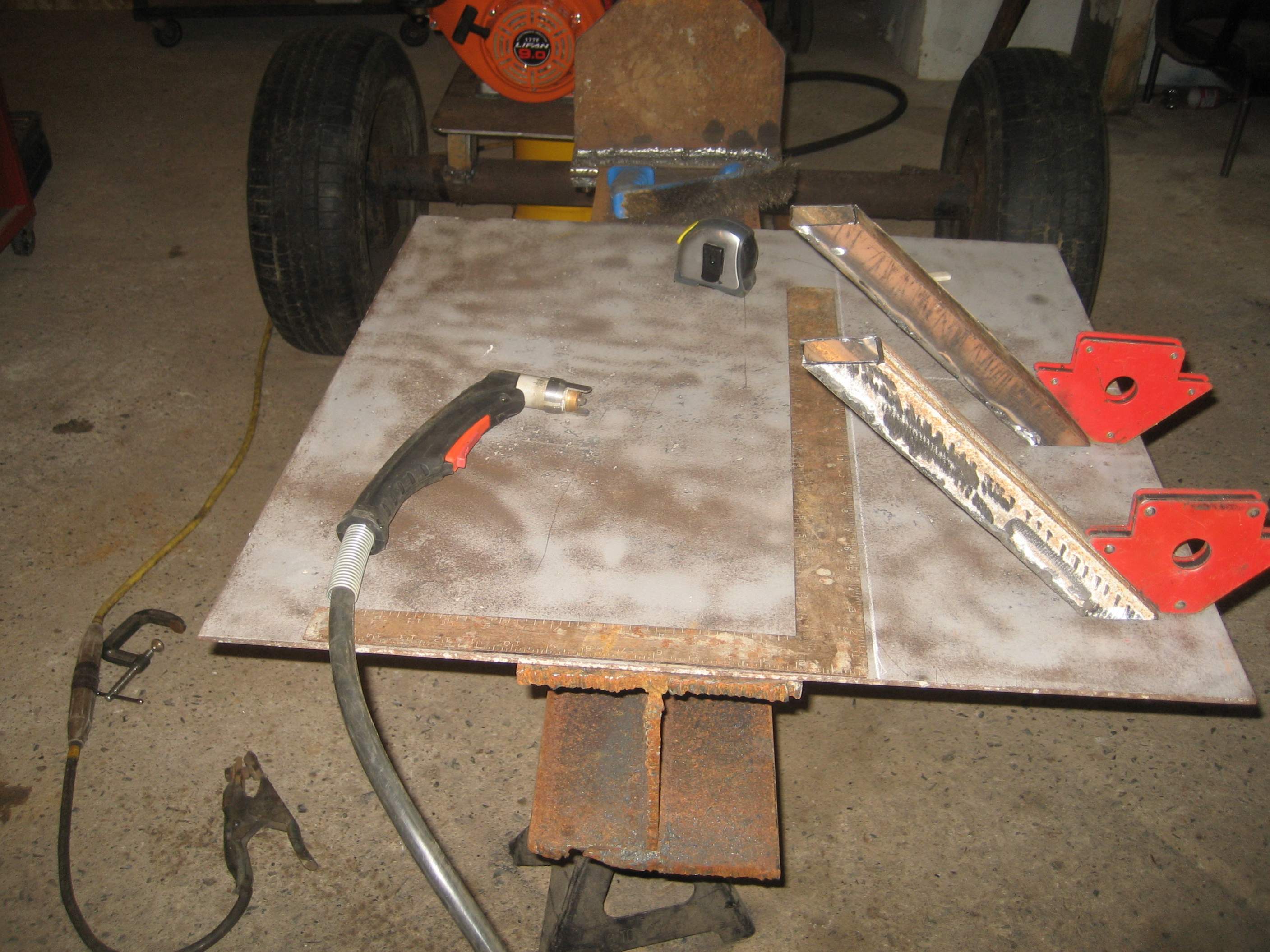

Finally got some time to cut down my axle but before i weld it up something occurred to me..I cut the axle down from 7 feet to 5 feet( these are inside the hub measurments so it will probably be closer to 6 feet wide once tires are on)..However it wont fit in any trailer or truck that i have( yet anyway)..That is ok tho because i want to tow this on the road behind a truck and the axle and hubs i have are definitly heavy enough to take..
OR.. Should i shorten the axle more so it can be placed in the back of a truck if need be..what are the standard widths for others splitters.. I am gonna hold off on welding till I see what average widths are..

i tow mine, but you have to go SLOW, like 50. Otherwise its all over the road, and its beating itself up. No suspension on mine.
As to width, id go the max that fits into your box. Id say mine is 5' maybe, but it'll fit on my trailer if i have to take it any distance (more than 30 kms.)

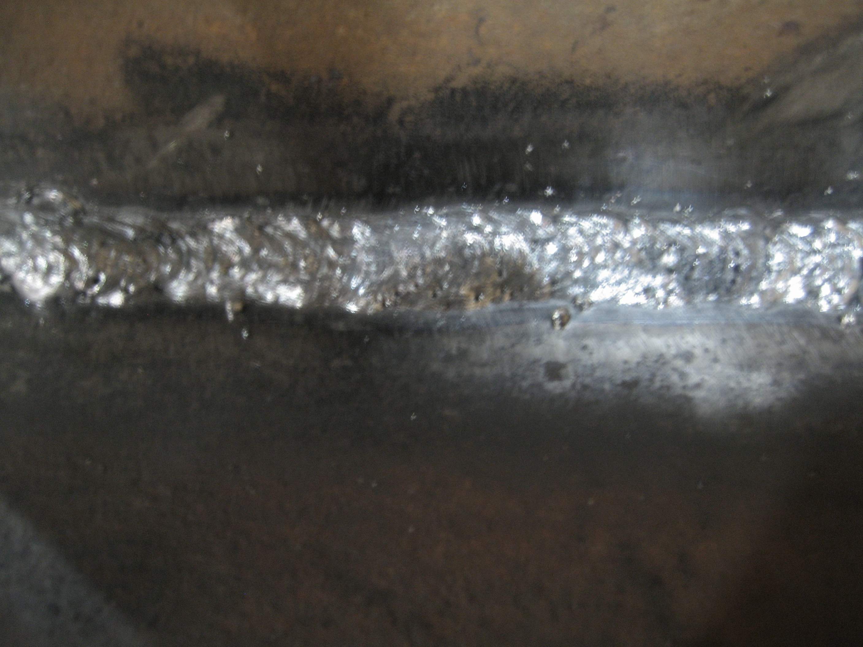

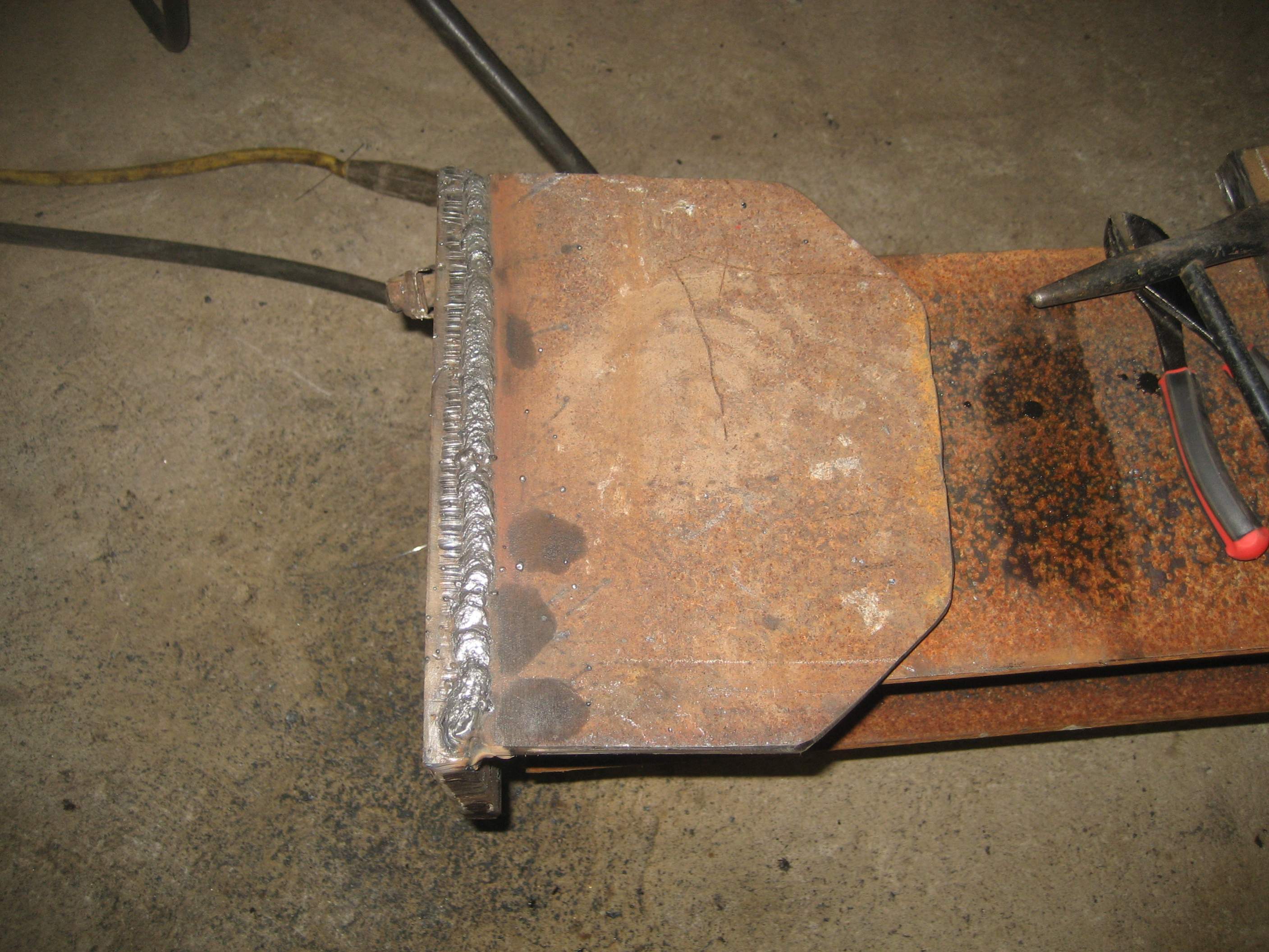

Lots of slag on that last weld but it was soild underneath..Those welds holding that square tubeing on where long hot welds at 400 inches a minute at 260 amps..Bacon baby..LOL

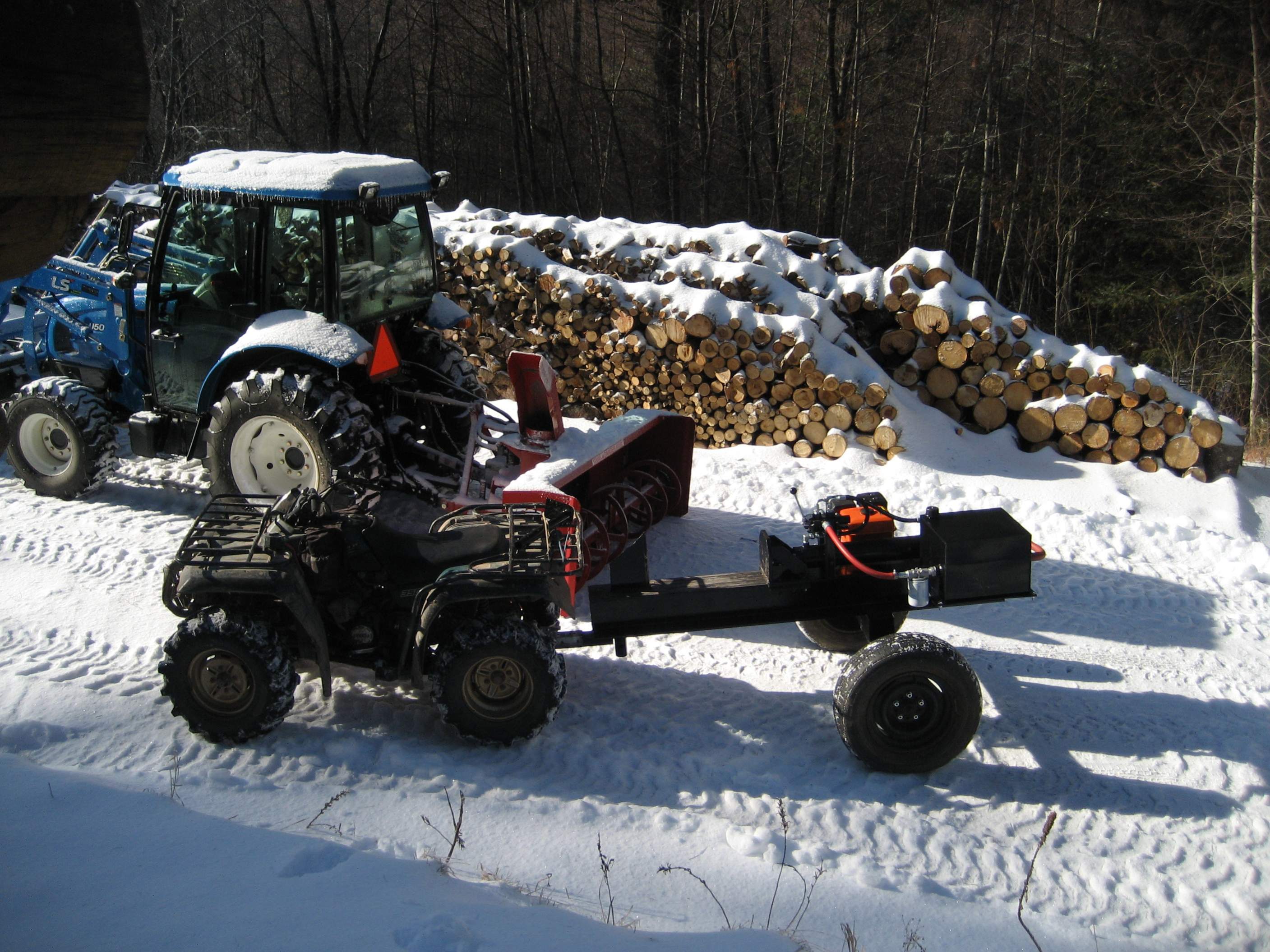

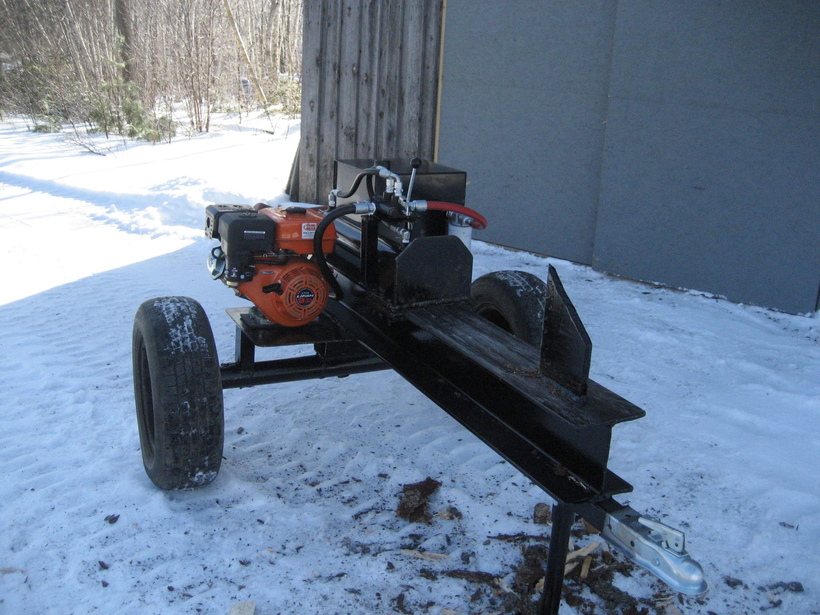

Done. Cycle time wasnt as fast as i wanted because of the bigger 4.5 inch ram.. It has a 10 sec cycle time as of now. Split 1/2 a cord today and no trouble..Made the hydraulic ram pin on my chochester lathe.
It was a fun project..Might sell it to buy a milling machine and build a faster splitter with a smaller ram..:thumbsup:

Modified 4 way splitting wedge.
   / Nother woodsplitter build #40
interesting 4 way.
You didnt go for a hydraulic lift for the 4 way eh? I have to say its one of the better features on mine.
Raise the 4 way out of the way when needed, yet be able to adjust the centre height when using it.
I use my 4 way 80% of the time. only on really gnarly or stuff in splitting into small pieces (like kindling) do i use the single blade.
