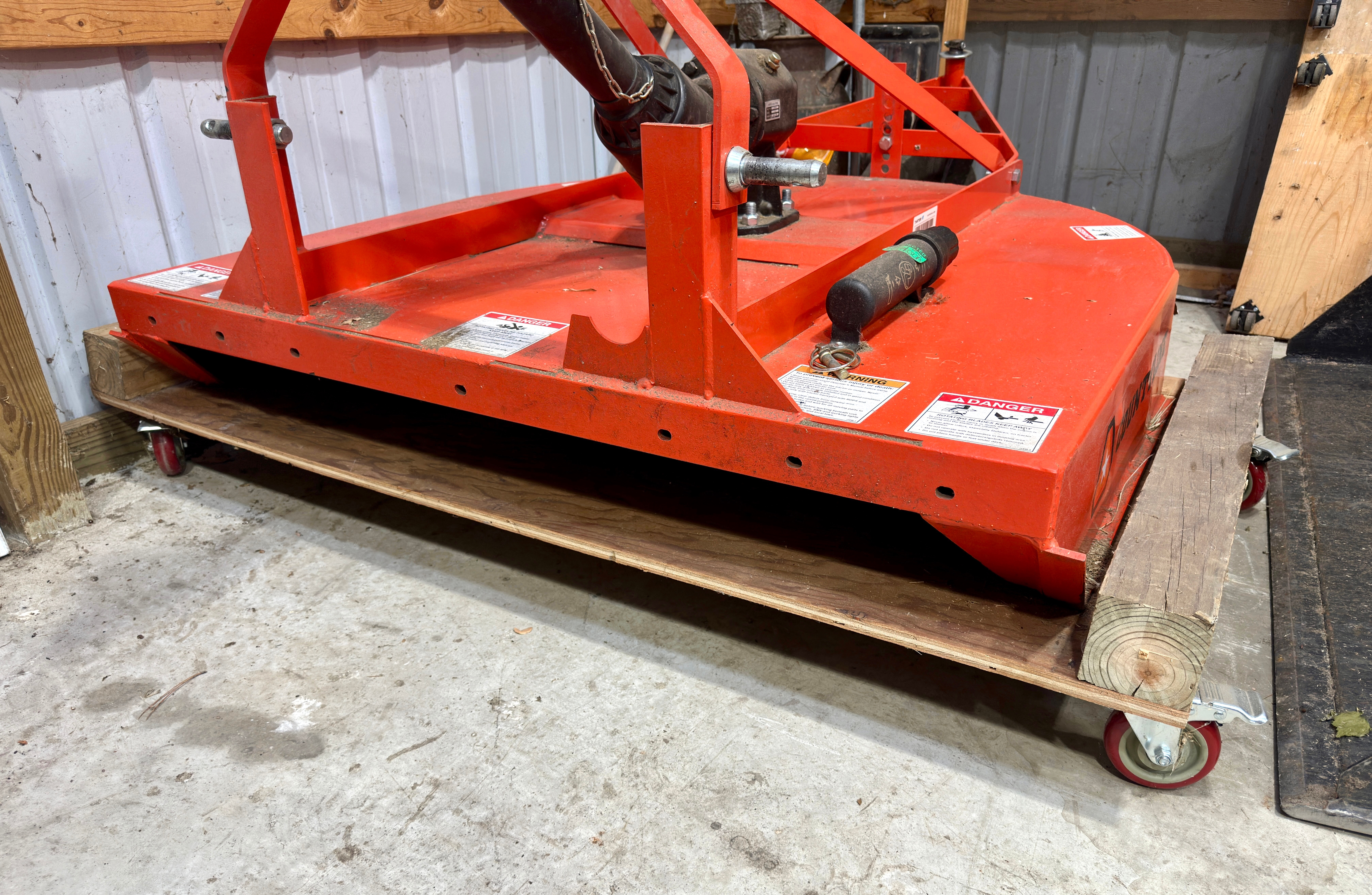

Congratulations! Do you have it on a dolly? I made one for mine and it's made connecting it much faster and easier. It's easier to move it to its storage location, too.
No dolly for mine. Can you post a picture?
Previous post with pictures here:

I rest the front end of the cutter on 2' 6"X6" blocks, one on each side, when I store the cutter. I can pivot it around to get the arms attached by grabbing the tailwheel to move it around. It slides easily on the wood. Then I use a small ratchet strap to hold up the PTO shaft level with the PTO stub. Run it under the shaft and hook both ends to where the top link attaches to the cutter. That way I can use all my force to slide it forward instead of having to hold it up.
