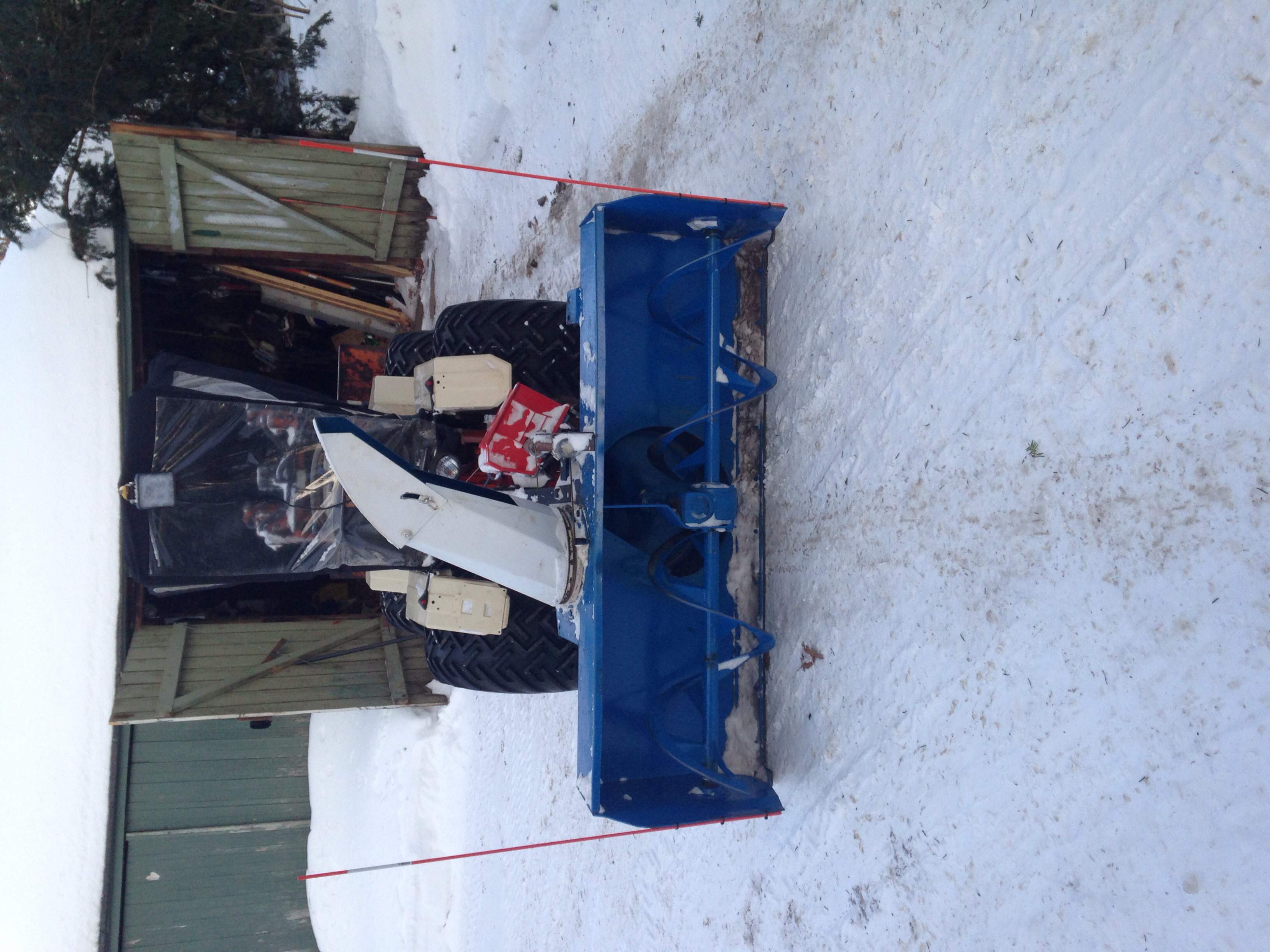

I just bought a n.h. tc18. It came with a aftermarket blower. The problem I have with it is its not blowing very far. PTO's say 540 on the tractor. Its only blowing snow 5-8 ft. Is this normal. Also should I leave the pto engaged on the blower as I pull forward. And one last dummy question.... how high should I lift my blower when its on. I have heard lifting it too high wears out the pto. Any help, advice or suggestions you can offer is greatly appreciated. This is my first real (well small real tractor) and I'm learning on the run. thank you. Any suggestions on where to get decals for my tractor. The pto' lift and 4 wheel drive don't have any decals left.
No, it is not normal. Some blowers are designed for higher-speed PTOs. You'll have to find an owner's manual for the model you have. If you look inside and there is any type of reduction from the shaft to the fan, it is a higher-speed blower.
Your tractor RPMs have to be at absolute full-blast for the blower to work properly - if you are one of those operators who like to keep RPMs down to be 'nice' to your tractor, that might be the problem. Your tractor wants to be screaming it's guts out (full PTO speed) or the blower will not throw very far. Also - do not play PTO engage-disengage games - just leave it running when repositioning. If you chop the throttle or disengage the PTO while there is snow in the blower, it can pack up like it is full of concrete, which will not only break every shear pin in the thing, but also requires 45 minutes with a pick-axe to clean it out. Been there, done that.
You can stress the U-joints on the PTO shaft if you lift the blower too high, but it generally isn't a problem - just lift the blower up all the way with the PTO disengaged and spin the auger by hand - you'll know/hear if it is hanging up.

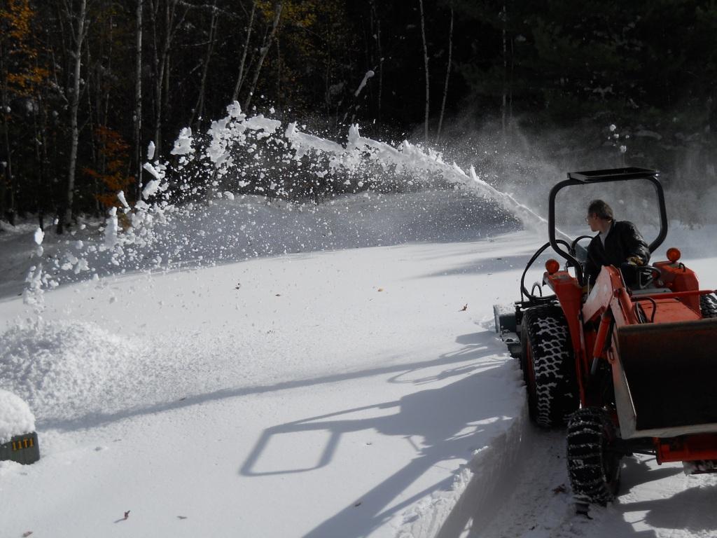

My blower doesn't throw particularly far compared to some I've seen: this are pics of my blower throwing 24" of wet mashed-potato snow (Freak Halloween blizzard of 2011). Yours should throw the same 20-30ft with normal snow.
