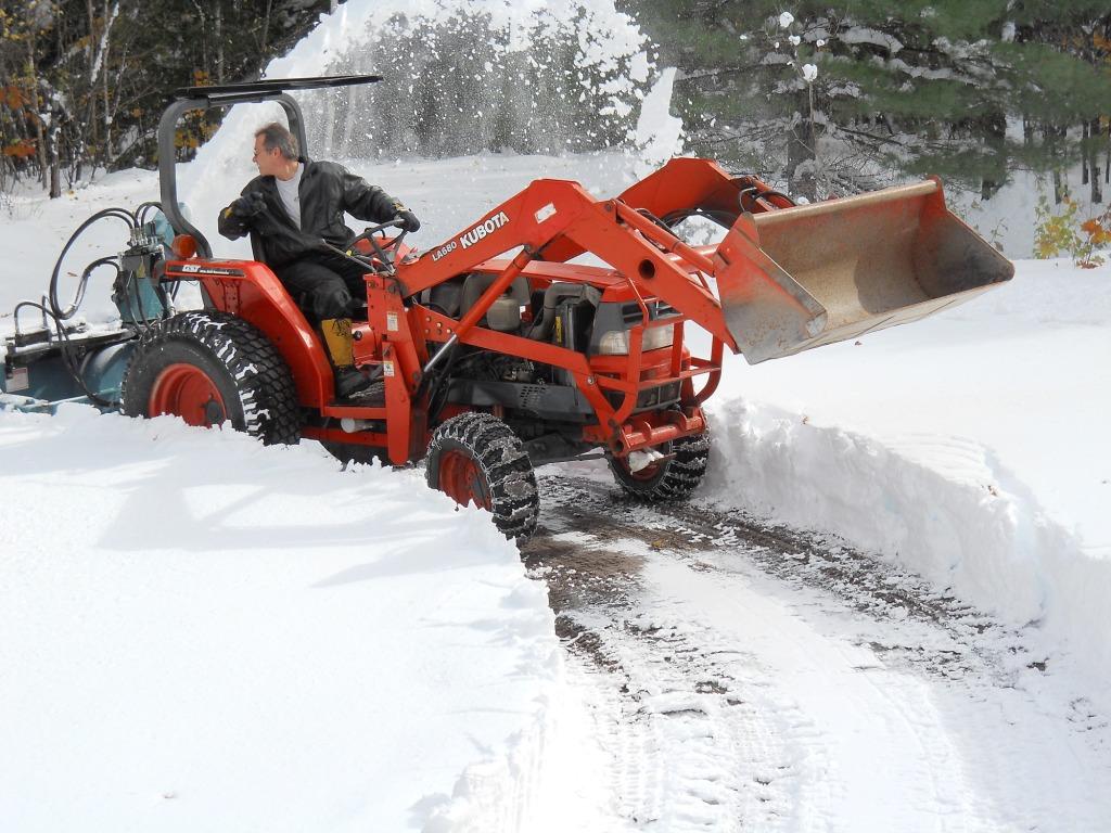

My blower doesn't throw particularly far compared to some I've seen: this are pics of my blower throwing 24" of wet mashed-potato snow (Freak Halloween blizzard of 2011). Yours should throw the same 20-30ft with normal snow.
