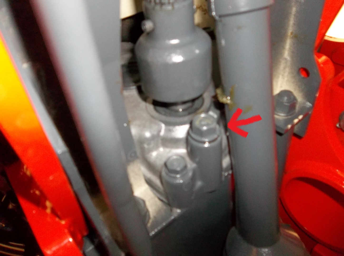

I'm attempting to change out the oil in my B2601
Pretty much F*cked.
There is nothing even close to this photo while looking about under the Tractor.
I see two flush Bolts.. Are they the ones? Hex Keys? I have over 6K worth of tools and nothing that will fit this.

Can you post a picture of that part of the tractor showing these flush bolts that you are talking about?

The oil drain plugs are hard to miss, since they are on the two sumps of the oil pan (with shaft in between). Post a picture if unsure and someone here can confirm. Be gentle tightening them back up -- you can strip the pan threads very easily.

Should look like this. And yes the manual is not accurate about location and number of drain points at all!!
I just found out there apparently is another one on the clutch bellhousing that contains oil also that I have been missing all along? I always thought it was just to drain moisture if you ever got into water the way it was described. I had no idea there was oil there.
Anyway here are the three I know for sure. The one by the mid PTO snub and the two at the bottoms of the sumps. They should be bolts and look just like the ones that bolt the casings together. But when you look close you can see the difference in that they have sealing type washers unlike the washers used elsewhere.

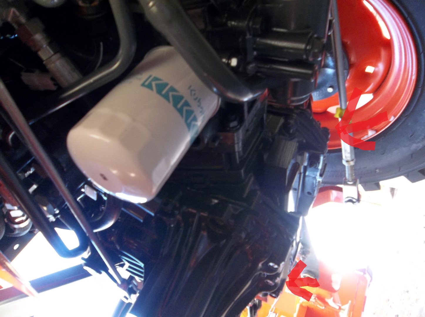

Okay, I'm all set.
I just drained the oil. " Photo "
First off, I'd like to apologize.
I'm feeling like a Troll right now.
Thank you " Everyone " for trying to help me out.
I've been cooking and drinking since last night, multi tasking with the Tractor, weekends are way to short trying to fit everything in.
To much JD right now. LOL.
I asked my wife to come out to the garage and showed her a photo in the manual of what to look for.
She immediately said WTF? Where are you?
The bottom of the engine is over here.... I was fumbling about underneath the middle of tractor.
Just say NO to booze when working on your Kubota.
Here's a photo of the Oil Drain... I only have 47 hours on the Tractor. Man, this looks like Mud. It looked pretty clean on the stick though.

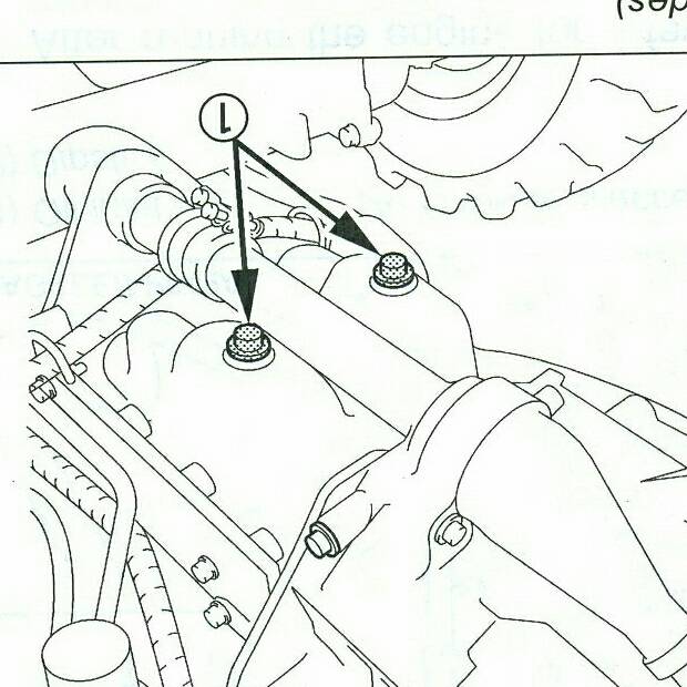

What guy designed this and what was he thinking?View attachment 601287
You know what's funny.....even though that is what is in my manual for this tractor, this model tractor does not have this, LOL. It has a normal single sump engine oil pan.
But many other tractor makes have an oil pan like this. Some are even worse with just a pipe running between them.
