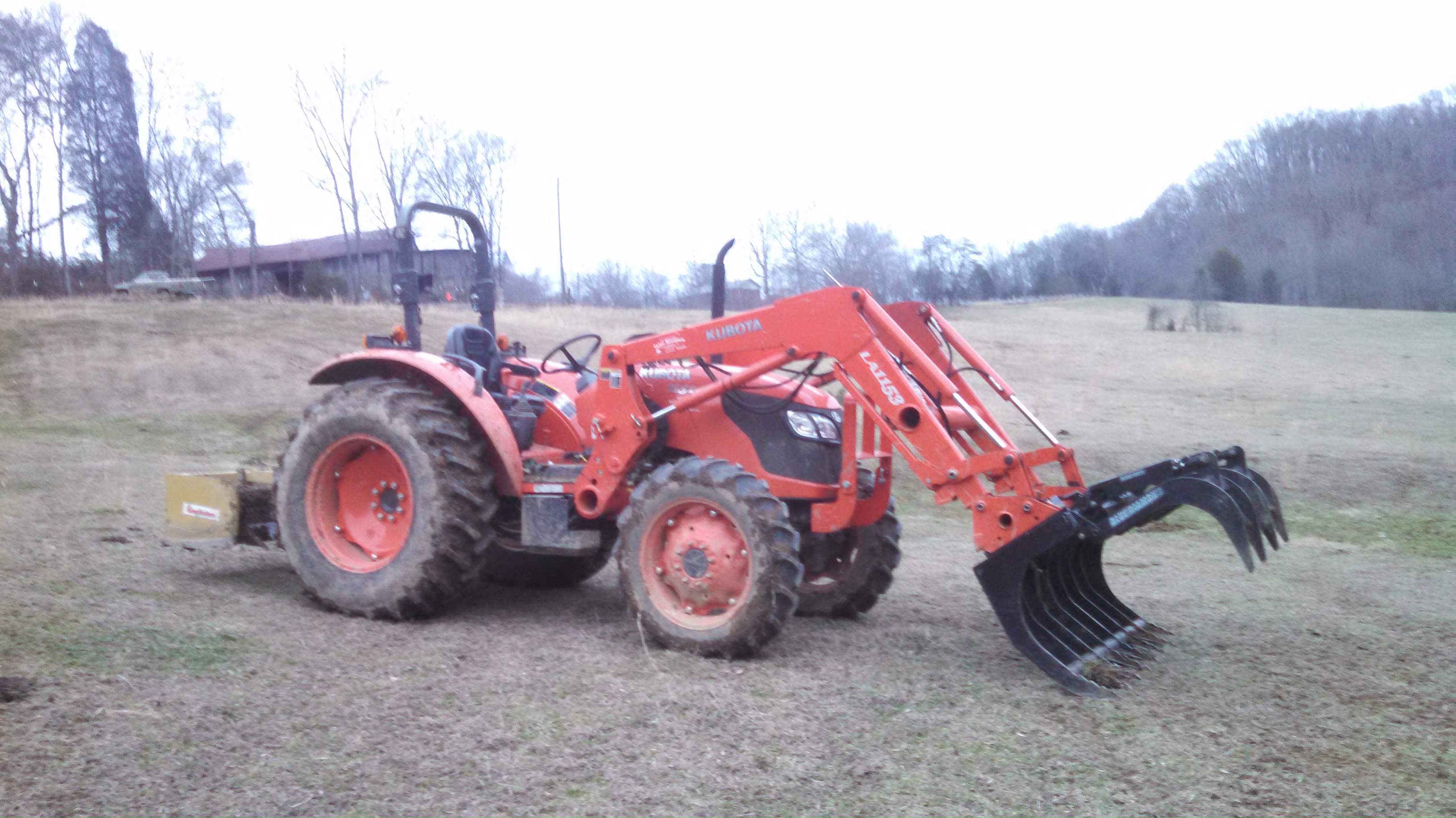

Thanks UT, for adding the pic... And thanks to all who contributed to this thread.
We spent the day cleaning up the mess left by a big stump removal & doing it all while trying to stay out of the soupy mud. It looks a lot better, but we won't be able to get it smooth & seeded until late spring.
The clay here is so heavy & sticky, we had to tow the stump out of the hole & remove about a ton of clay from the root ball, before we could pick it up & haul it to the fire pile. Even then, it was all the tractor would pick up. The back tires were bouncing off the ground a bit, even with 1,200 lbs of hoe on the back. Good thing we're retired & time is not a big issue! Still havin' fun!

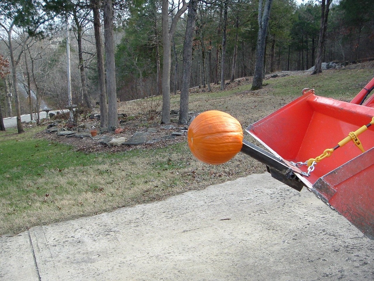

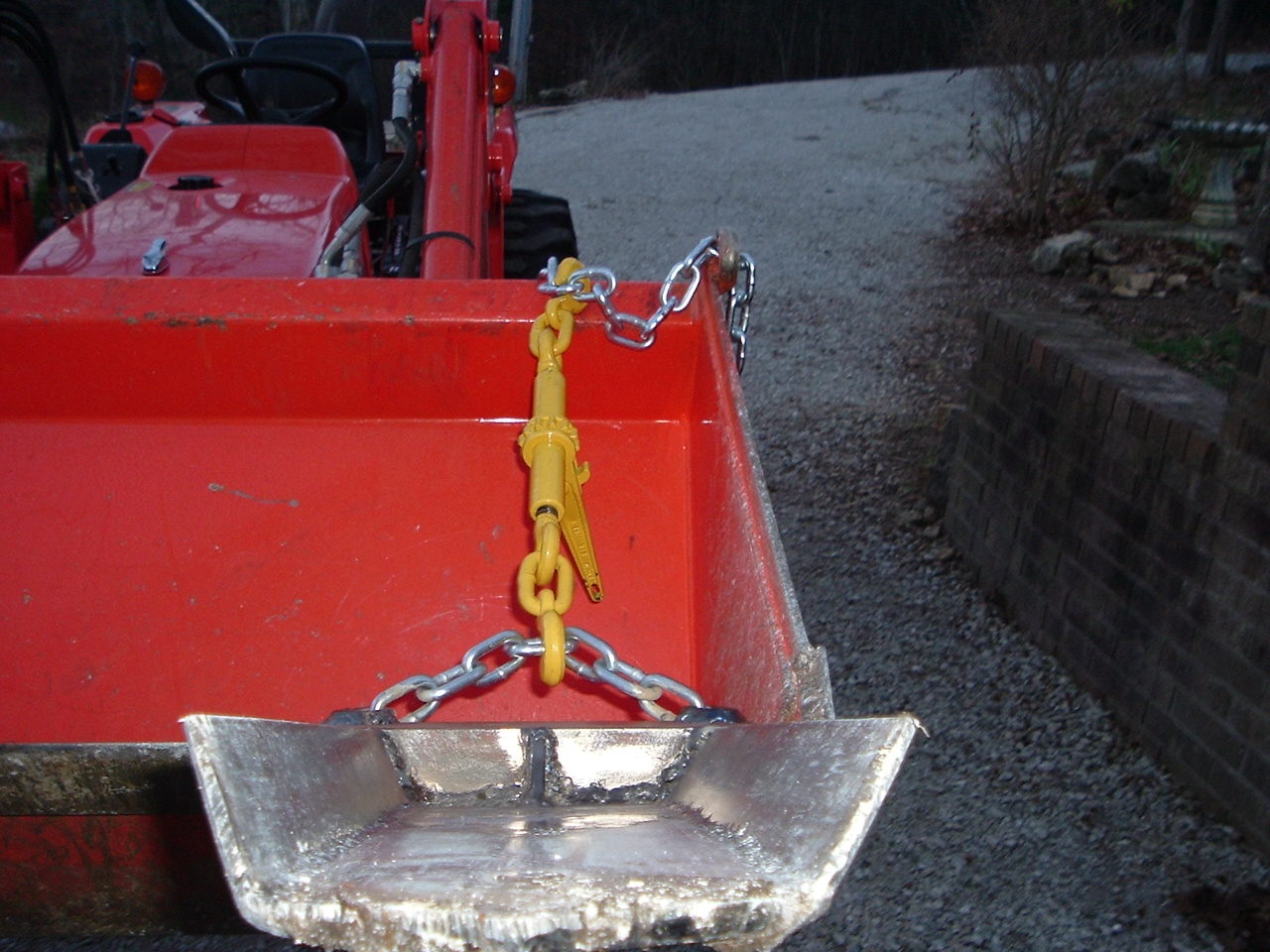

Another thing I have done is use my bucket shovel to scrape the dirt and rocks off of the rootball. I don't have a backhoe, but the bucket chain on "shovel" I made works pretty well to get a lot of this stuff off. It sure beats using a digging bar and a ordinary shovel to do it.

I like your home made shovel James. It seems that once you buy a tractor... Your next purchase should be a decent welder. I'm looking for a used one now.

Thank you for the great pictures Dan and sharing your post with us. Glad to see you are giving your root grapple a good workout. You will find the lower bar very handy at back racking.
This grapple is excellent at uprooting trees, and transporting logs. It is not performing as well as an "L" shaped open bottom for brush pile grabbing and moving.
Also, you will just about never have any sticks beeing stuck in it while dumping.
If your hydraulic hoses do rub on something, I may suggest to wrap that portion with plastic coiled hose wrapper.
Enjoy your retirement, and happy Tractoring!:tractor:
