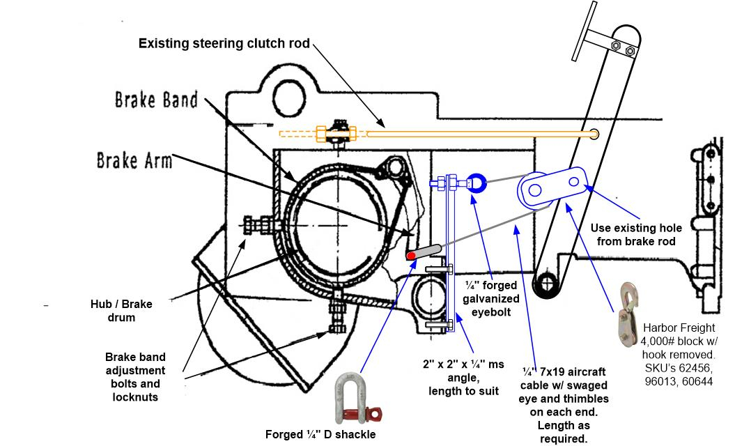

What seems to be an inherent problem with these dozers is the design of the sequential linkage for the steering clutch/brake. For the existing system to operate correctly the brake adjustment must be "pre-loaded" tight, meaning that the brake band will always be in contact and rubbing against the drum.
I don't mean to blow my own whistle, but I have re-engineered the linkage system to operate correctly, with significantly less pedal effort and no brake band/drum contact. Details are on the Yuchai/Guilin Community Facebook page.

It should be noted that the steering system on these machines will never be really great without a complete redesign. Even after Yuchai acquired the dozer from Guilin in the mid-nineties, the only changes have been to switch from an inorganic fibrous friction media to a bonded sintered bronze type disc.(They did try segmented lining on the brake bands but that was a flop). Because of the linkage design, pedal pressure requirements will always be high. The modifications I made to the system makes adjustments very easy, and significantly reduces pedal pressure requirements. The only caveat is that it will require considerable mechanical acumen because there are no step-by-step instructions. So if you want to reap the rewards of a challenging little project, I'll go ahead and recreate the drawing.

Here it is as best as I can recall. You will have to do your own measuring. This configuration allows the brake band to be completely slack along with some mechanical advantage. The take-up rate with the cable and block is approximately 1-1/2 times faster than a direct linkage pull. This brings the sequence more in line with what it was intended to do.
Just so you know, I did work up drawings for hydraulic, pneumatic, and electrical systems, and also hydrostatic drive from a skid steer, but those all got lost too. At least I was thinking about it.
Good luck.
PS: The left side is the easiest, suggest you start there and just do one side at a time.
/ Nortrac dozer steering problem #33
Good luck.

My Yuchai has also become problematic, as regards the clutch/brake adjustment, and despite attempting to adjust it per instructions, I really could derive no "feel" for what was going on, until I disconnected the linkage and manipulated the two components (clutch and brake) separately.
Then, it became apparent that the throw of the pedal is insufficient to effect the movement needed.
The answer, for me, was to install a pully and cable system which doubles the effective movement of the linkage, at the cost of additional pedal force needed:
a fair trade.

Correct, David. Hahahaha. Sounds like you adopted my pulley system. Glad to hear it.

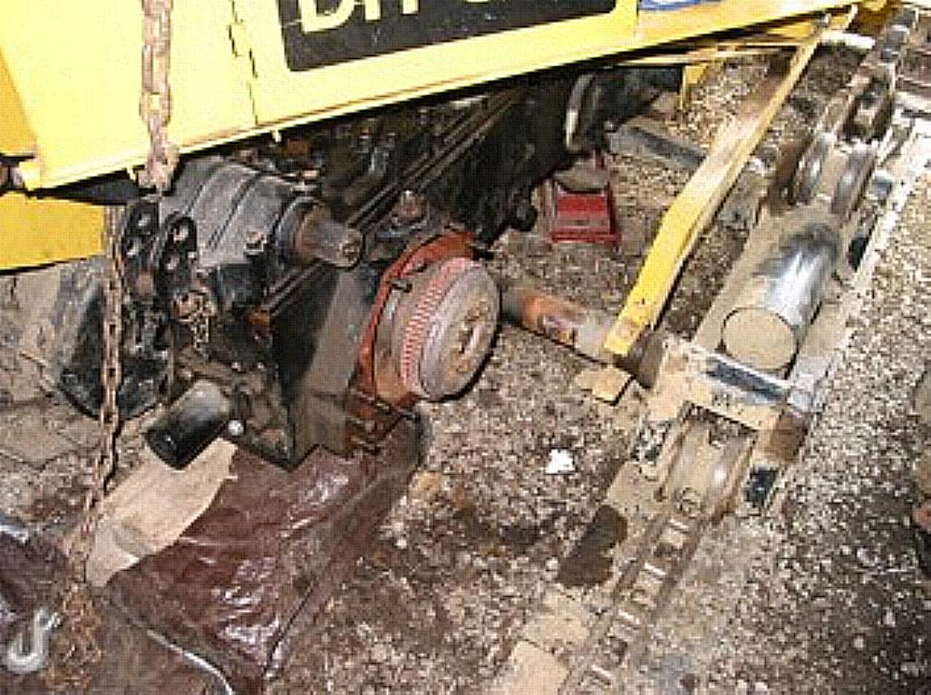

The only way to determine how much your clutch plates are worn is to compare clutch linkage measurements from new, like measuring track pin wear (which nobody here does). Clutch disc replacement is a time consuming task without a shop manual, to be sure.
