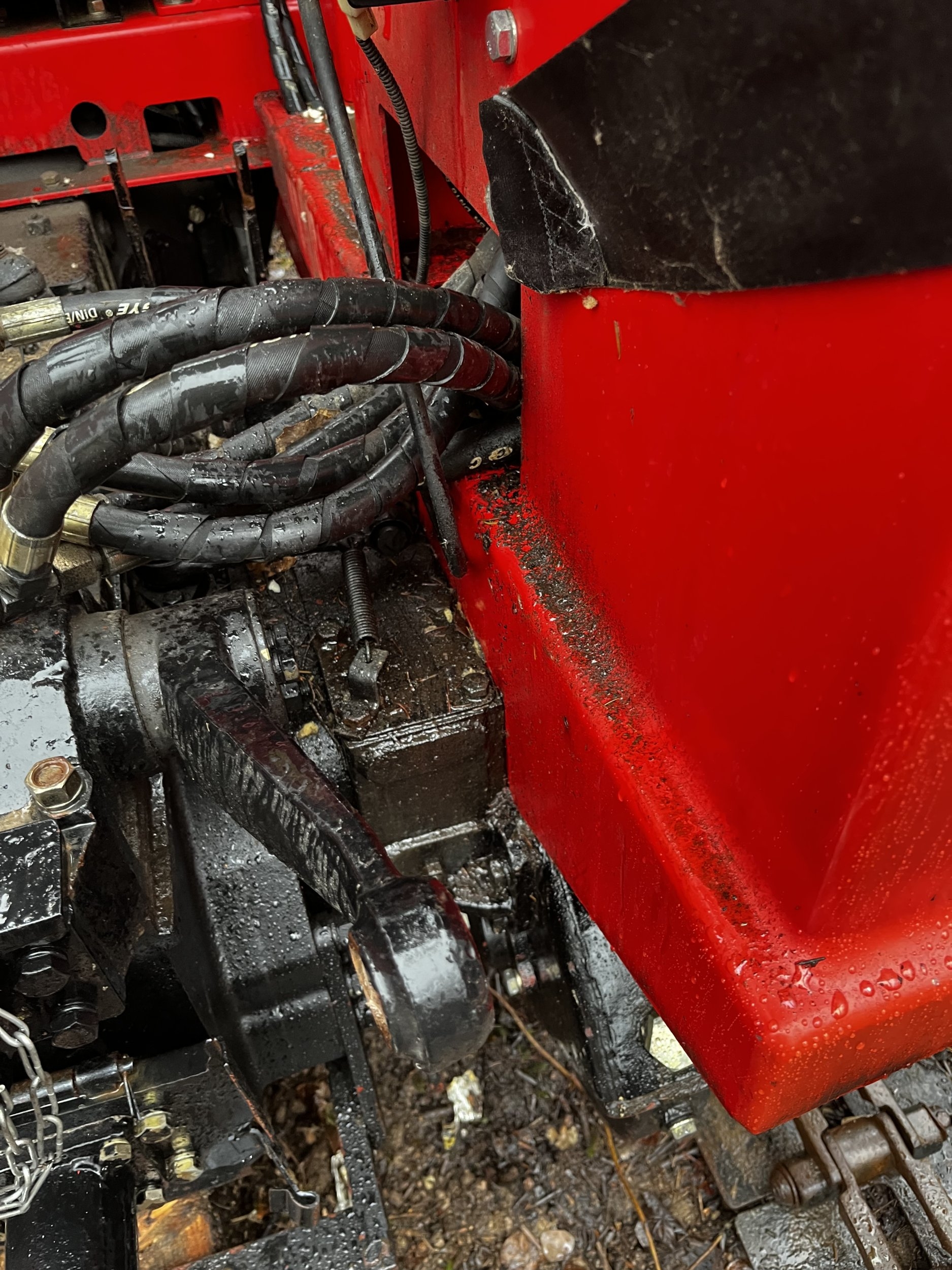

Hello All,
Long time reader 1st time poster.
I’m looking for some guidance on final drive removal on a Nortrac 35xtd.
I’m in the process of replacing the Bull gear, axle and semi gear after the PO ingested a Rock in late 2019 and parked it.
The semi gear is pretty short and the way it looks it only reaches back into the rectangle cover area so do I have to go far enough back to just remove the final drive or do I have to go deeper?

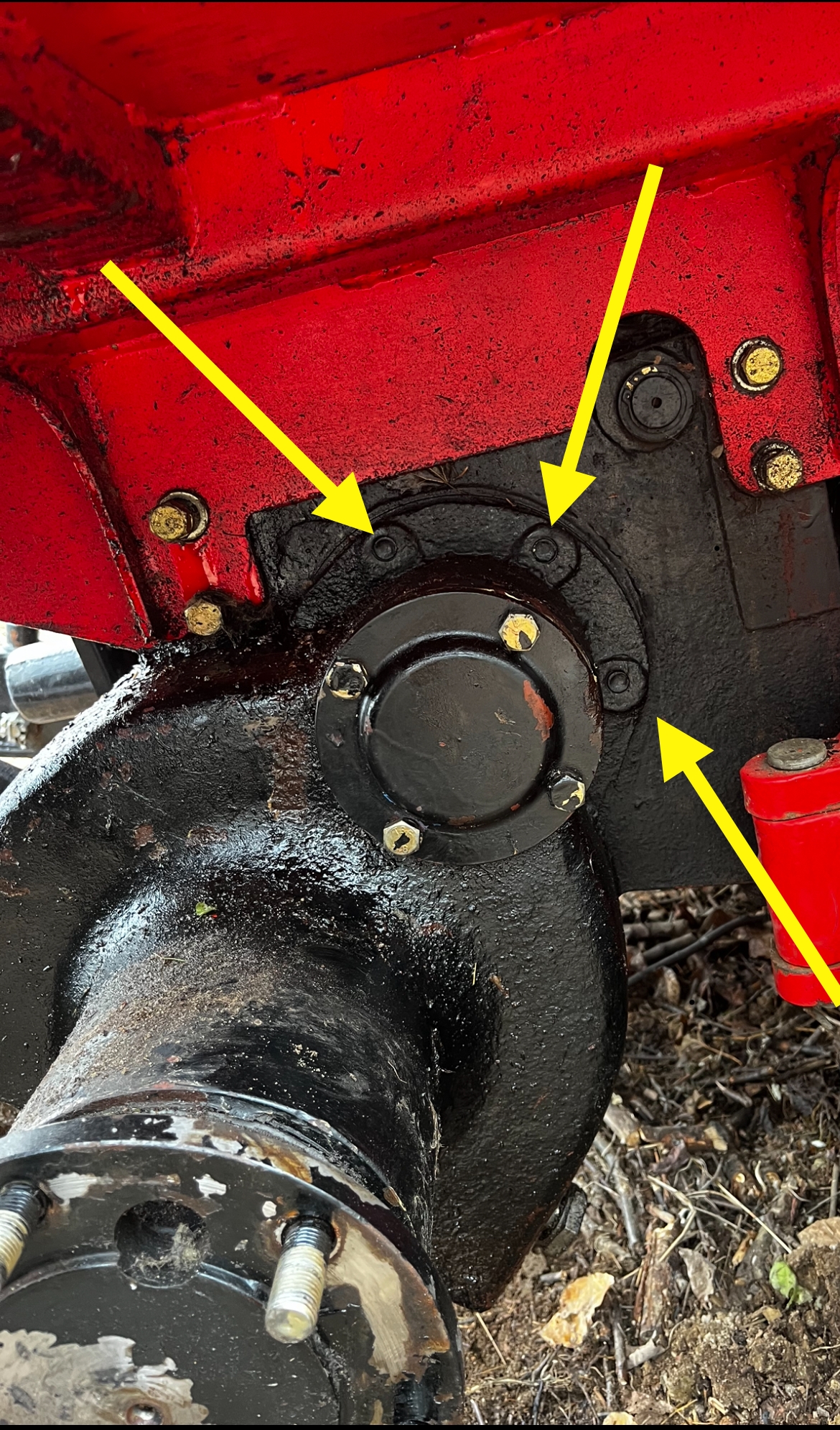

So after checking with my manual none of the pages or items align with yours. See attached pic. I drew arrows pointing at 3 of the 6 bolts that needed to be removed from the inside of the steering housing and is the wishbone the item in the lower right of the image attached?

The bolts you pointed out are inside the steering compartment. This is how far in you need to go.

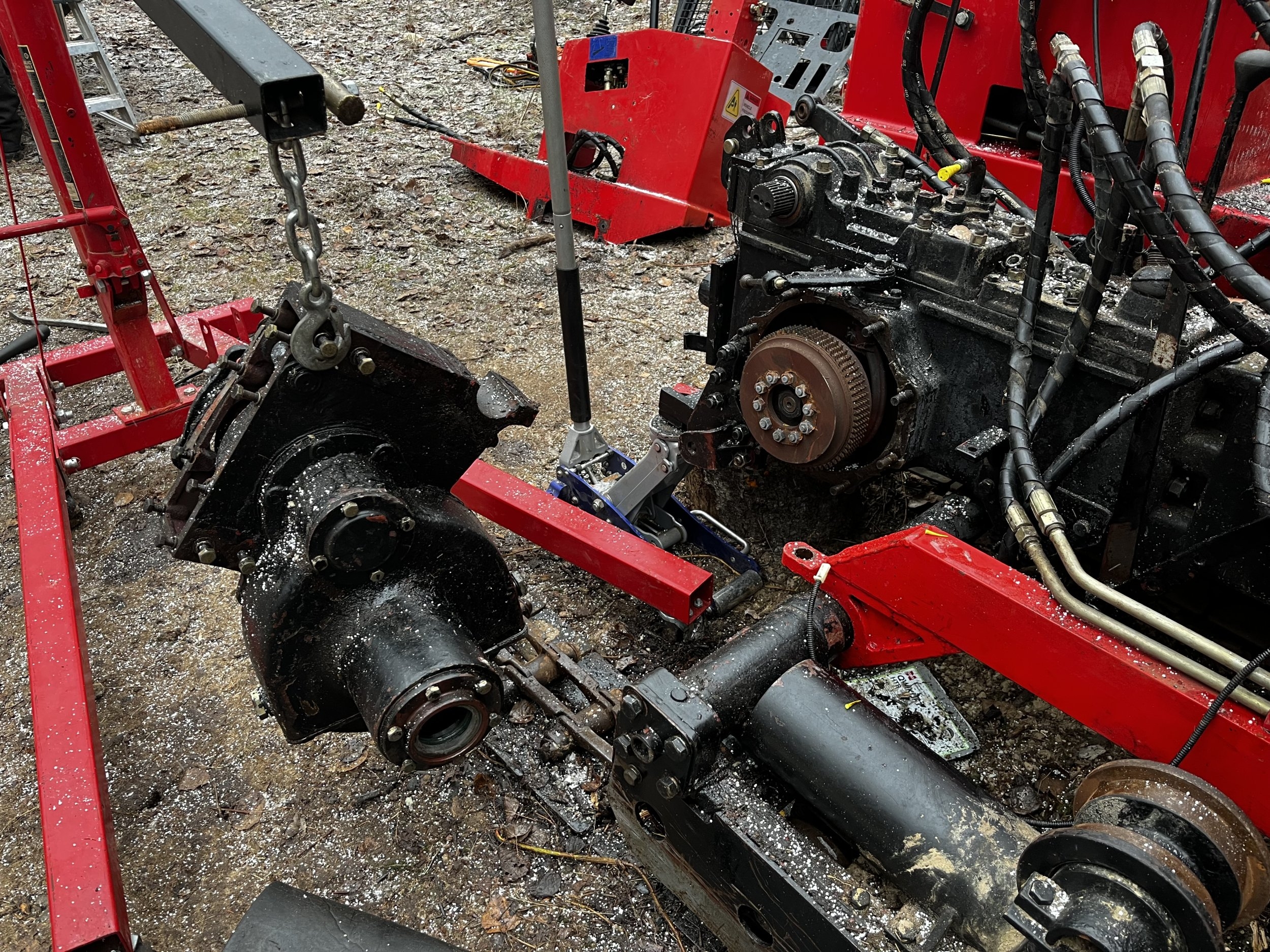

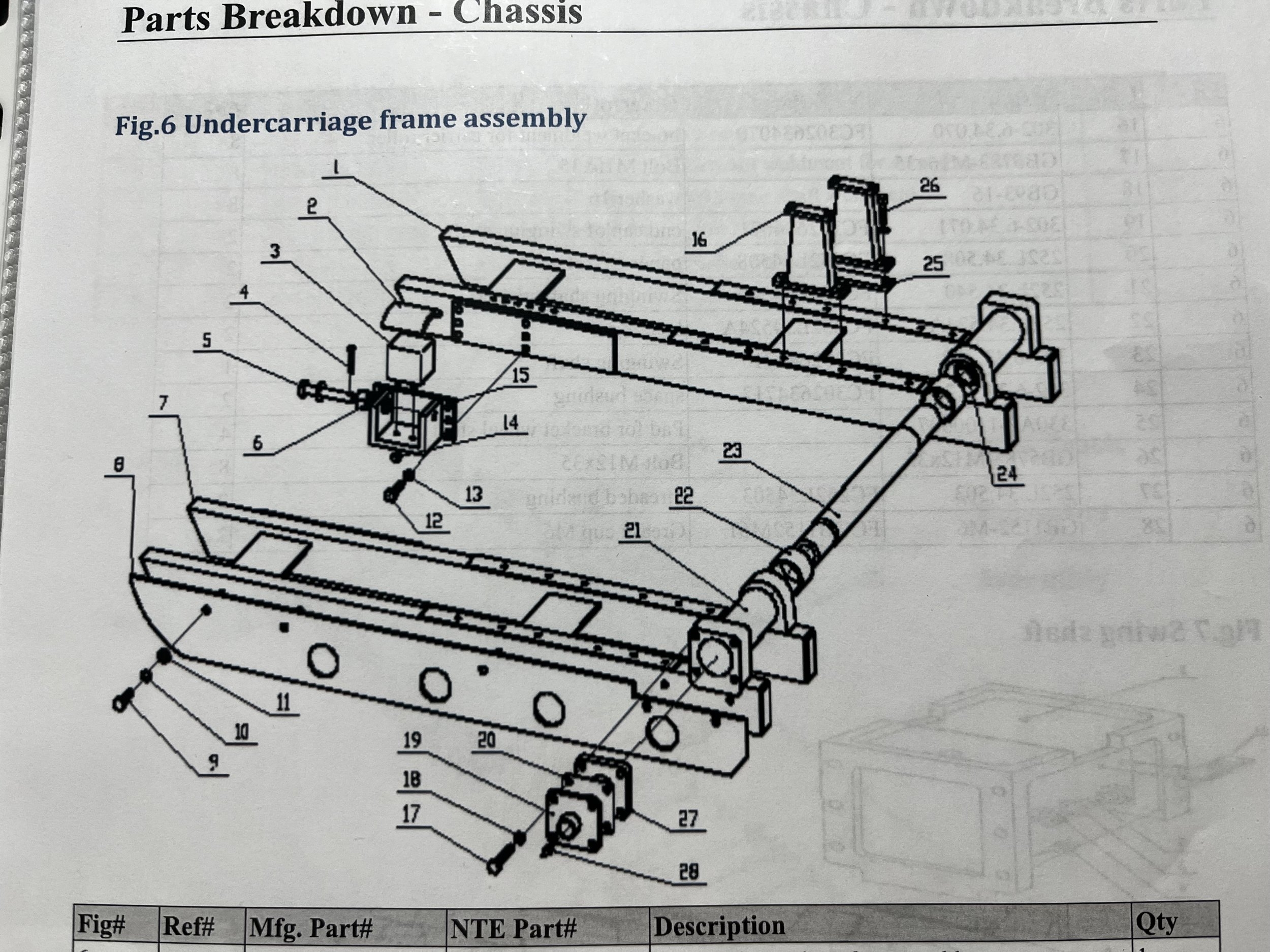

Update:

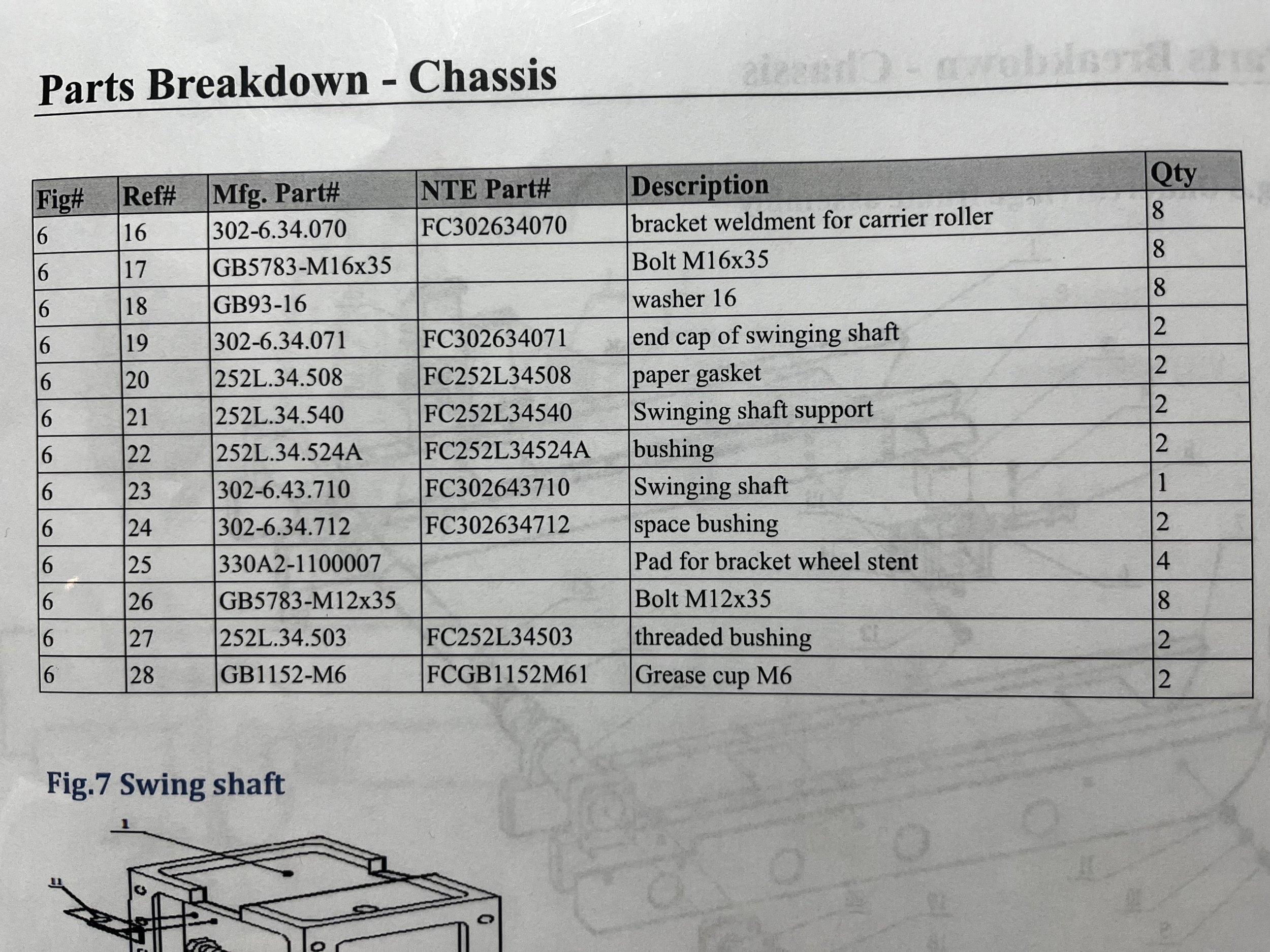

FD is off but it was a challenge. So I have a question. Does the undercarriage frame rail stay attached with part 27 in attached image? Is part 27 internally threaded? I was able to loosen the other side clamp for the swing shaft and get enough movement to get the FD removed but it was a challenge.

/ Nortrac 35XTD final drive removal #11
Hindsight being 20/20, it may have been easier, and even faster, if both tracks were dropped and both swing shaft caps dropped, and just rolled the whole track frame assembly forward, with the wishbone still connected. This came as an epiphany while looking at your pic :LOL: . No, item 27 is not threaded.

#12

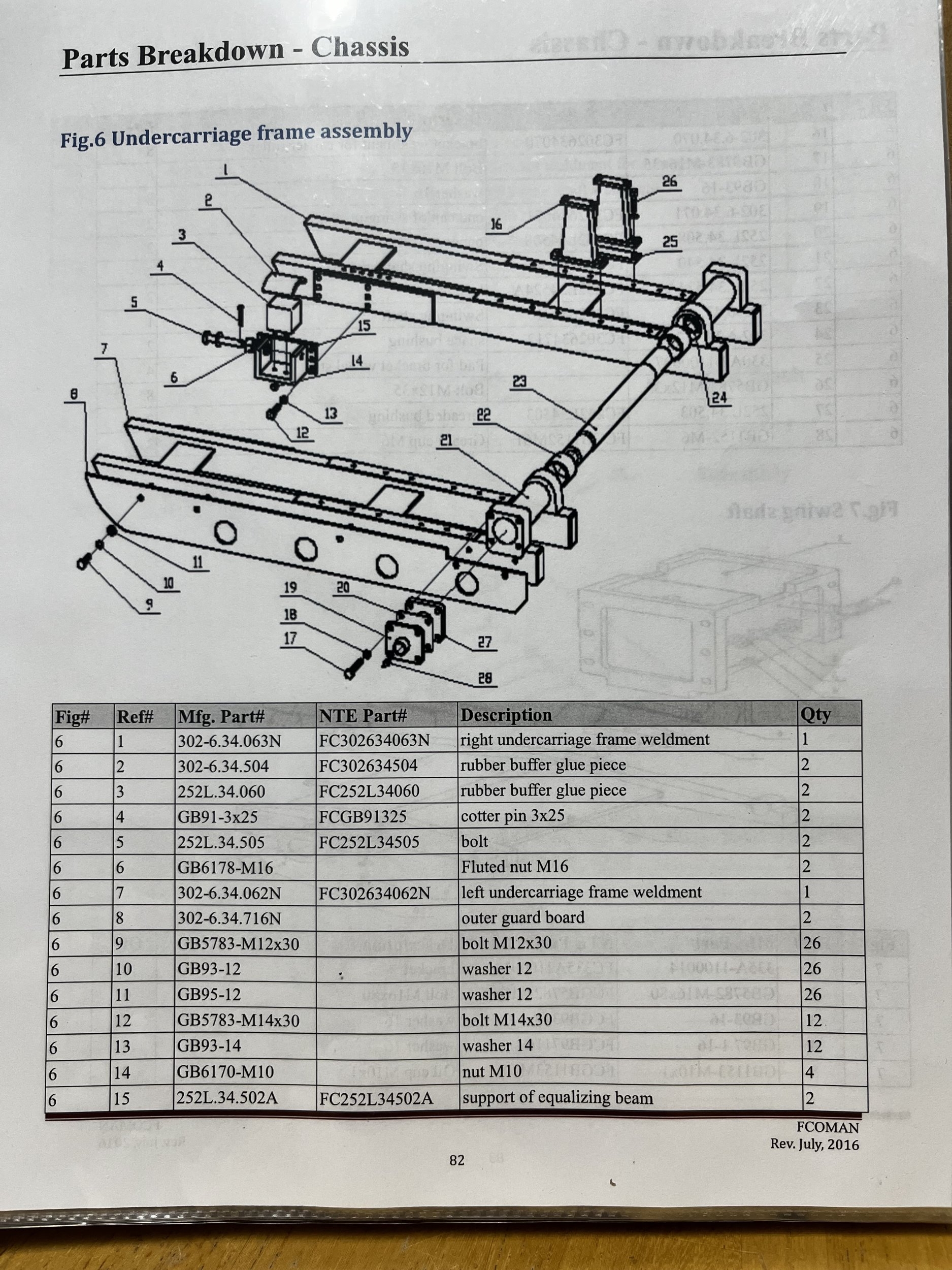

I dropped both tracks to get as much slack as possible. How do the swing shafts detach from the under carriage frame. I pulled the 4 bolts in the cap and only saw grease inside. Manual doesn’t show a snap ring or key so I’m stumped.
/ Nortrac 35XTD final drive removal #13
I have never pulled that shaft, so can't say. But my parts manual suggests they are threaded in.
