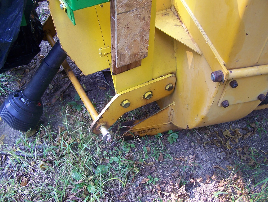

Need help on color, The closest thing I have seen in the stores to match this is "caterpiller" yellow. Anyone have a suggestion of a better match or a place to look, I took home a couple rattle cans of New Holland yellow and sunburst yellow and John Deere yellow (didn't know there was such a thing).
I didn't even take the caps off the paint. they were obviously not a match.
Here is a picture in the sunshine.View attachment 598392
I found that Ace brand "Sunshine yellow" from Home Depot is almost an exact match, at least on my far-from-new Valby. The paint was used on the mounting plate I installed which holds the plywood chainsaw carrier
