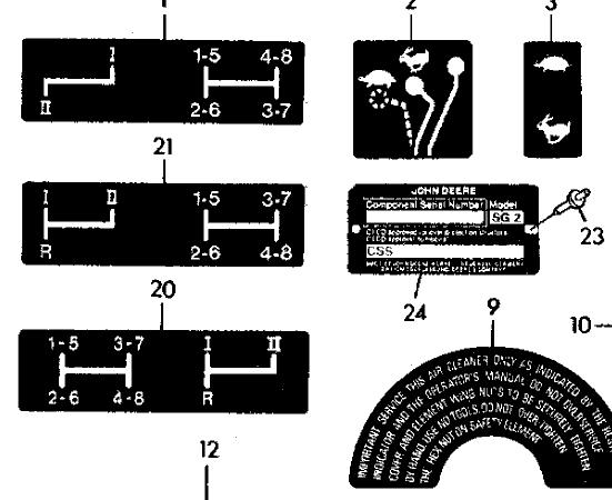

I found the shifting decals in jdparts and show here.

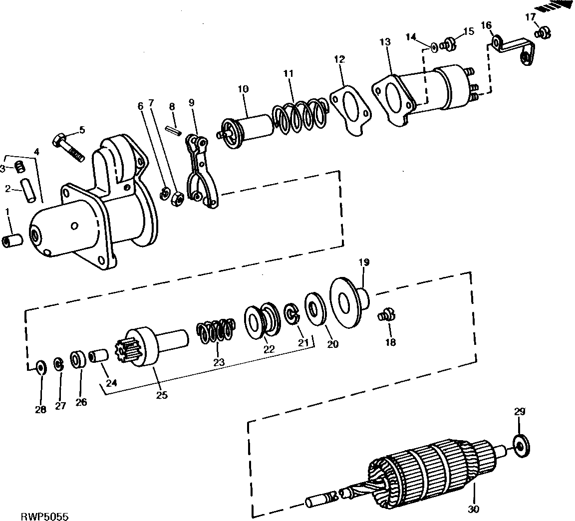

This may be the solution for my 2030! The starter does not always engage, (spins, but does not turn engine). Dealer said it needed a new solinoid. I replaced the solinoid and no change.
I had been thinking of running a jumper ground wire from the battery box ground mount bolt to the starter mount bolt. TxJim do you think this will help?
/ Normal start JD 2550 #5
If starter spins but doesn't engage flywheel gear I'd suspect either the starter motor drive(parts key #25) or something binding in parts keys #9 &/or 10. Or possibly bad teeth on flywheel ring gear.

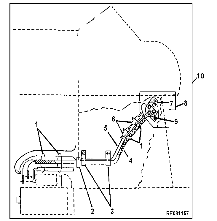

Another thing that can help poor starter engagement is this relay kit(part #RE170320).

Thanks, everyone, now I know the shift pattern. There is a black rotating switch with a paddle knob and three positions on the left side of the dash and an orange knob that pulls in and out. Do you know what they control?
