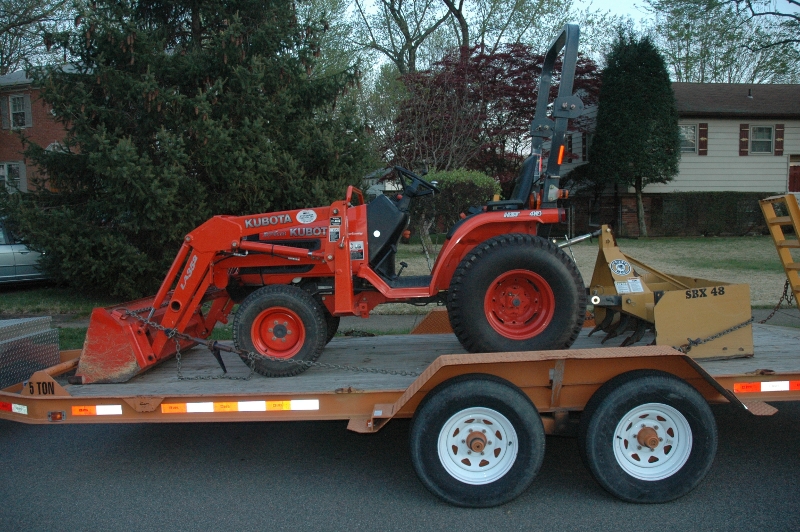

Well, thanks so far for all the info this forum has provided.
I finally got my first date with a tractor. Just got it home. Unlike my wife and most of my cars I don't expect this relationship to last. I'm already figuring heck I've got the trailer, how big can I afford next year?
It's a cute Kubota b7610, with 246 hours, it came with a FEL, boxblade an 18' 5 ton Hudson trailer and chains, all made in 2007. On the way to look at it I found a lightly used Woods 6' BH with 4 point hitch.
Rolled all together it'll be about $16K.
Already I know I need a grapple and bush hog. Tractors seem to suck money. :)

Congrats! Looks like a real nice package and a darn good price! Your patience has been rewarded!
Should make those retirement days all the sweeter! :D

Nice little TLB package you got there. And, you are correct that the trailer gives you room to grow. Spend a year or so using the 7610 and figure out if you really do need anything bigger. It will do a lot of work for you.
You might consider a grapple bucket and a set of rear remotes to control it. If you can do your own work it shouldn't cost you more than $700-800 to add a grapple arm to the standard bucket and run some control lines to the remote. Your loader is not terribly powerful but should work very well with a simple grapple bucket. I'd hold off on QA adapters, third function valves and "real" grapples if I were you as those add more cost than could be easily justified given your 700lb or so loader capacity.
