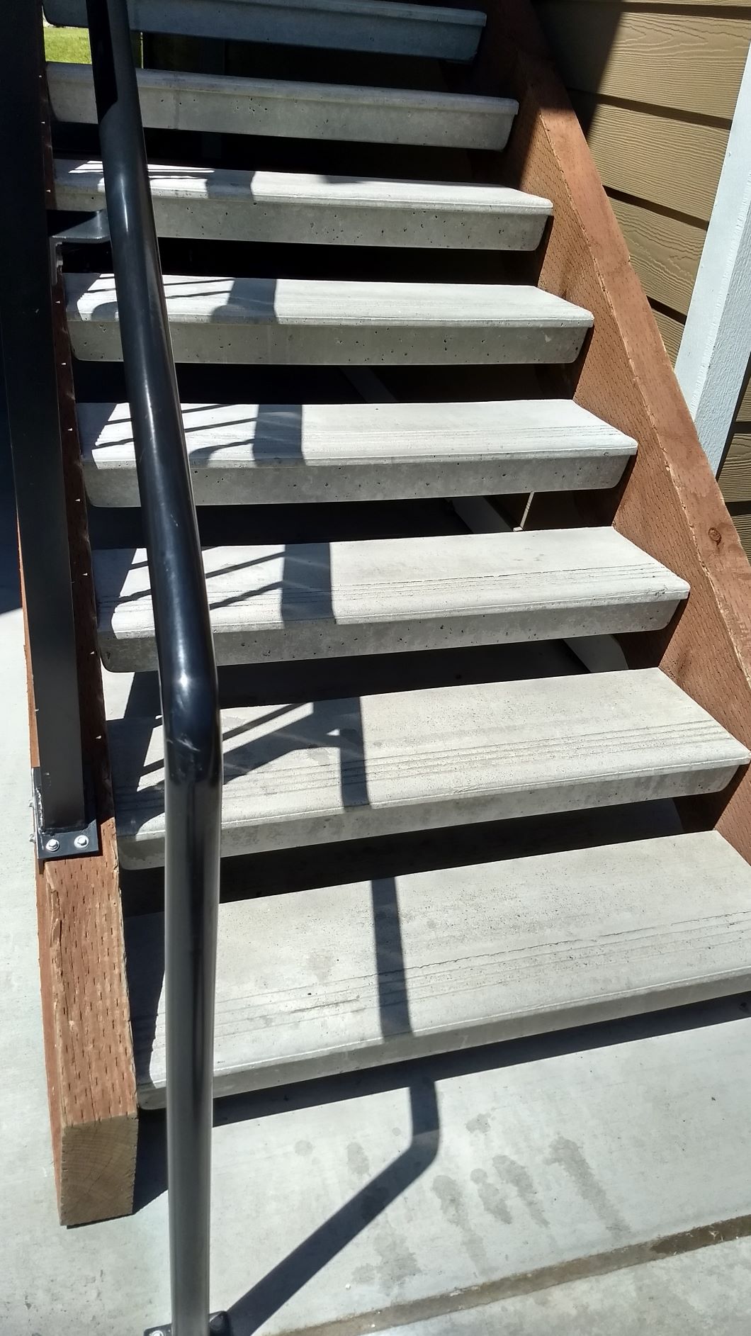

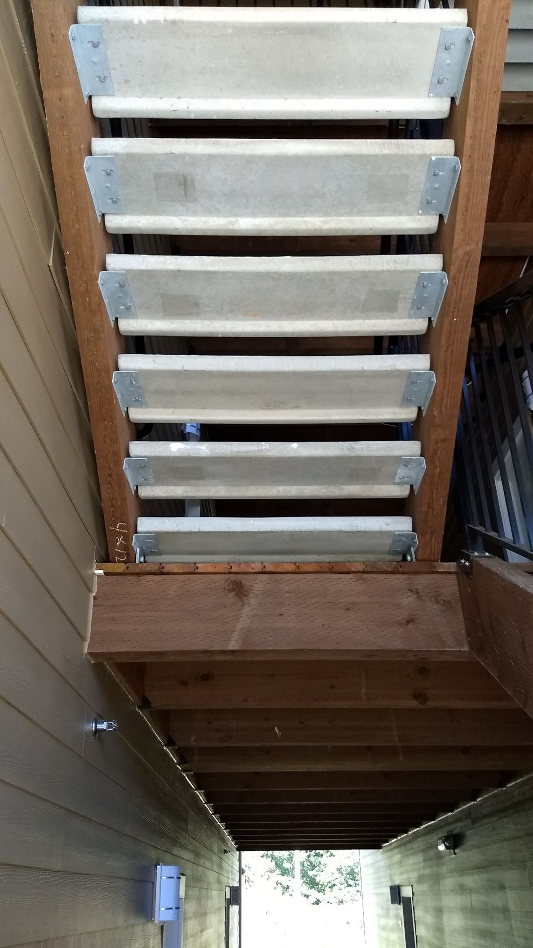

Anyone used Deckoratorsョ Frontier decking?
It is water and ground rated with a 25 year replacement warranty.
Met a deck contractor and he uses this on a lot of his PNW jobs.
Frontier Composite Decking - Deckorators
Also thinking of doing the stairs to grade this way as the stringers are not cut and the treads will not rot and can be reused.

According to my Thurston County Builder he uses the same Frontier Composite for docks without issue... at a $100 a 20' plank it should be good.
The company my brother works for builds a lot of commercial and multifamily... the picture of the steps are what they used in Lacey... 4x12 pressure treated Stringers with galvanized angle brackets instead of the birds mouth cuts...
I have lots of steps to the water to tackle another time... even when the steps were brand new... they would be slick as all get out... anyone using needed the hand rail for safety... the wood was almost never dry...
