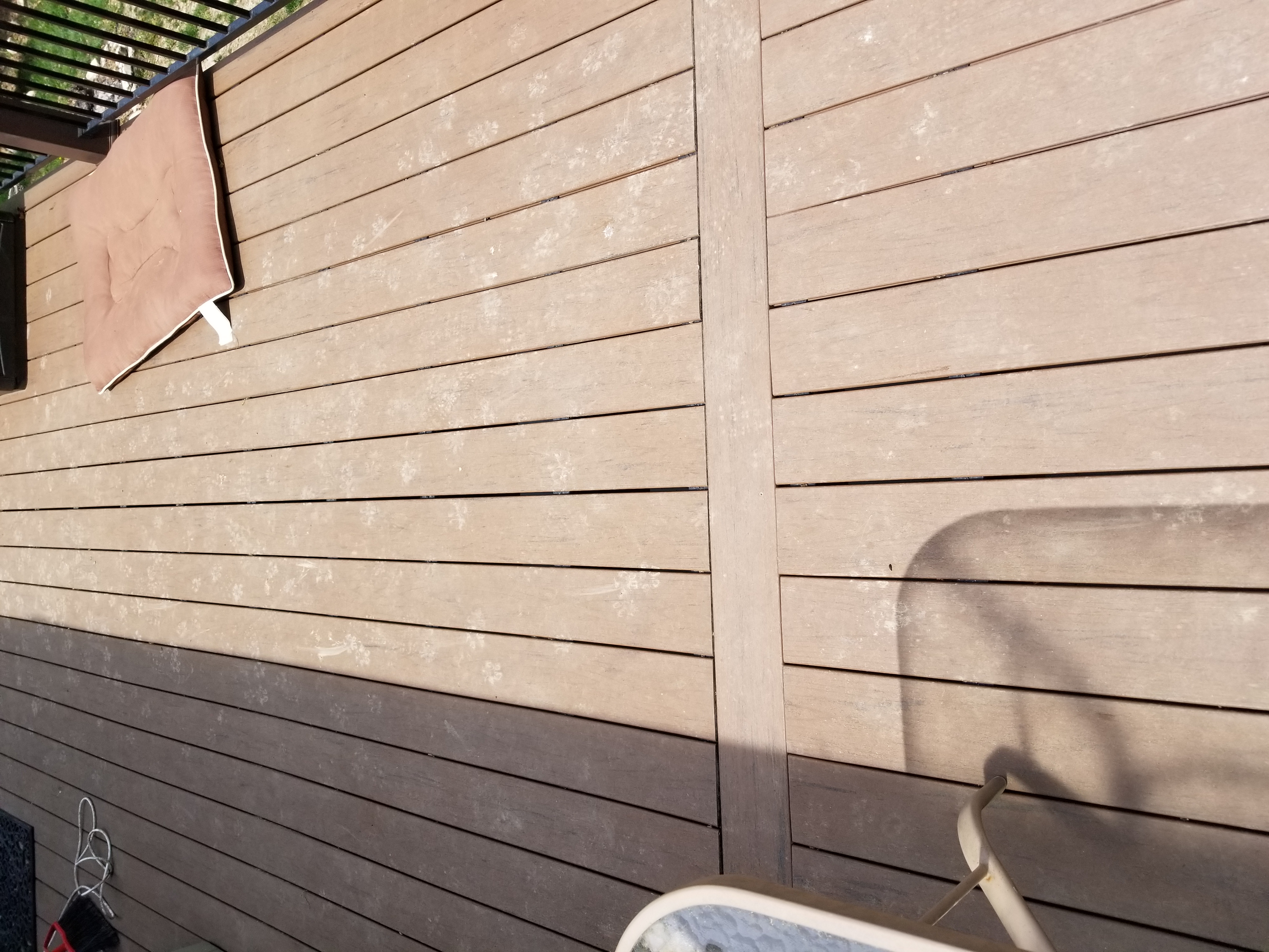

the aluminum deck has a special bracket that fits between the planks and has 1 included stainless steel torque head screw to secure. there secured every 16" as i spaced my joist at 16 on center. the screws and brackets disappear into the grooves. 20180509_182047-0.jpg
