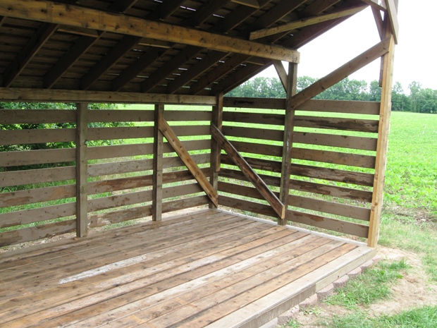

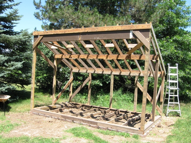

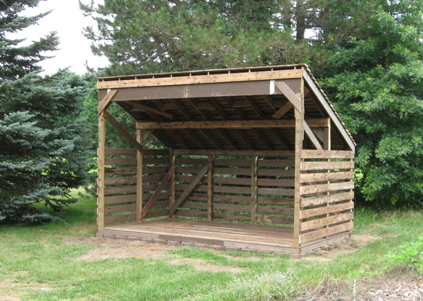

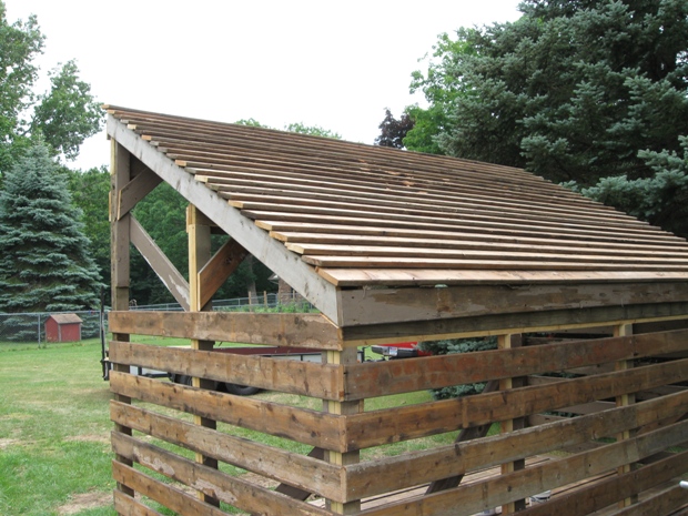

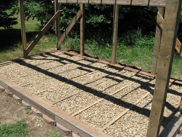

For a while I've wanted a wood shed instead of just stacking firewood, but it's hard to justify spending money on a wood shed. From other projects I"ve collected a lot of salvage that I needed to get rid of so I came up with this idea. I have a lot of retainer wall blocks from some landscaping I ripped out. Part of my cedar deck went bad and I replaced it with composite, but I saved the better portions of the cedar. When I rebuilt a bridge I salvaged some treated lumber including some doubled 2x12s over 14 feet long.
I laid a foundation of concrete block, topped by 4x4s. I ripped down some of the 2x12s to make posts, beams and joists. I used the cedar decking for various other parts, including the roof and the roof joists. I reused a lot of deck screws I pulled out of the old deck but I did buy a box of deck screws and a box of galvanized nails. I also bought some rock to fill under the floor to discourage the groundhogs from taking up residence. Cost came in about $50 but I may splurge on a gallon of waterproofing for the roof.

Very nice wood crib... put some stain on it and a hammock and I'll move in!
/ $50 Wood Shed #3
Very nice job! Love the look and the fact that you were able to recycle materials.
/ $50 Wood Shed #4
That's nice and a good way to be thrifty, give me some ideas for my own wood shed also! Now you just need to fill her up! LUTT
/ $50 Wood Shed #5
Awesome! I have a nice pile of used treated wood that I need to do something with..........

As for the woodshed, I've often wondered if blowing snow accumulating on the stored wood is ever a problem in an open-sided shed like this. I used to store my wood outside and always had to knock a lot of snow off the wood...and later in the season some of it seemed to have absorbed substantial moisture from the melting snow. Has anybody else seen this as a problem? Is the solution wider eaves or just close in the sides more but provide indirect ventillation or what?

The snow issue is a good question. I've noticed that the snow covered wood "feels" wet, but I don't think the moisture penetrates. It seems to me it still burns well. Once I get the shed filled up I don't think I will have much snow in it. It faces south and is sheltered by close trees on the west and north which should eliminate most of the drifting issues. I'll get back to you in 6 months on how it's working out.
