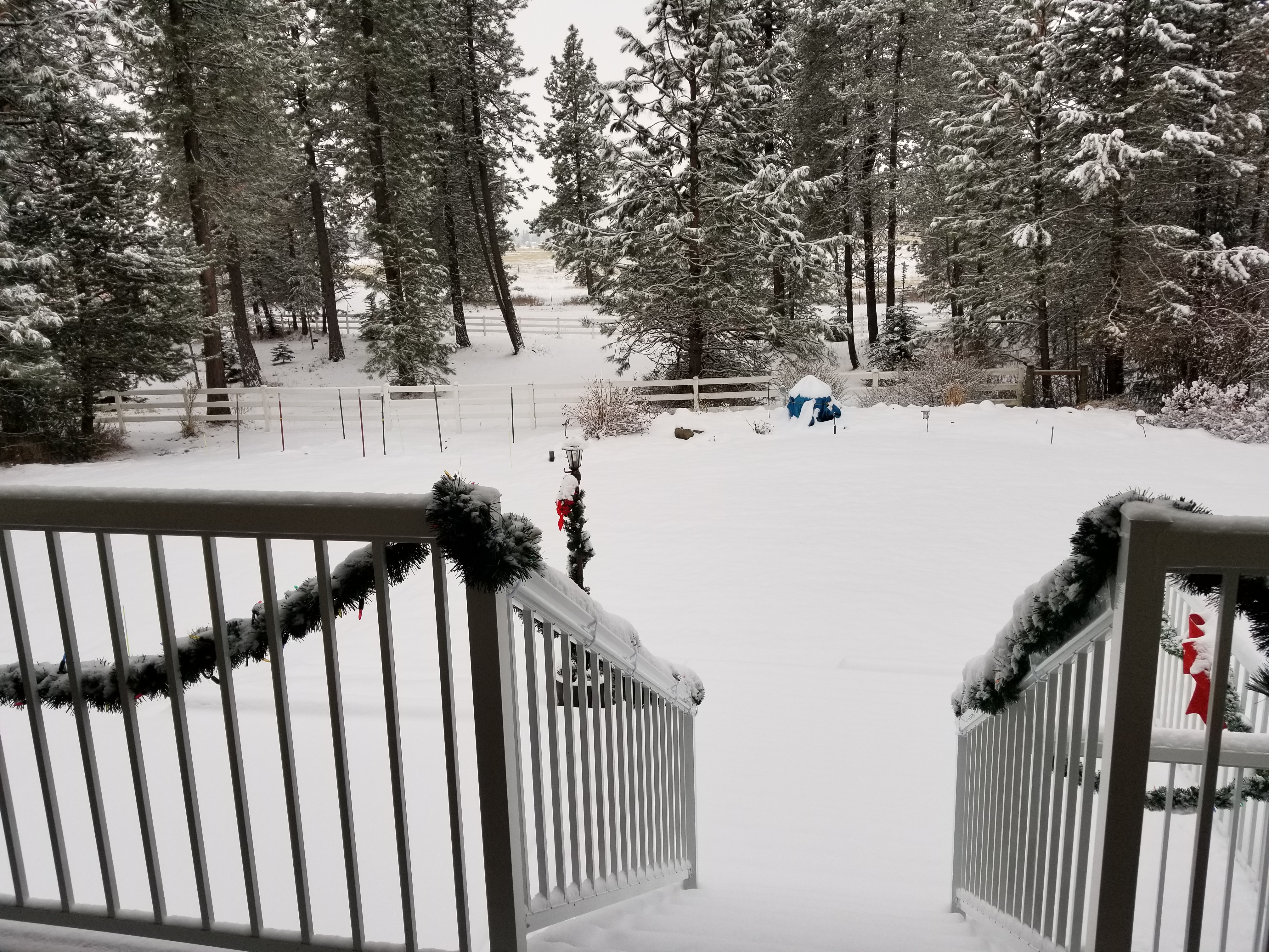

I have only gone thru 1 winter, but it is not slippery in the least. In the heat of tge day the deck stays pretty cool, almost like the old wood deck. The aluminum disapoates the heat. Ive been wirking on composite decks in summer and believe me they get hot.

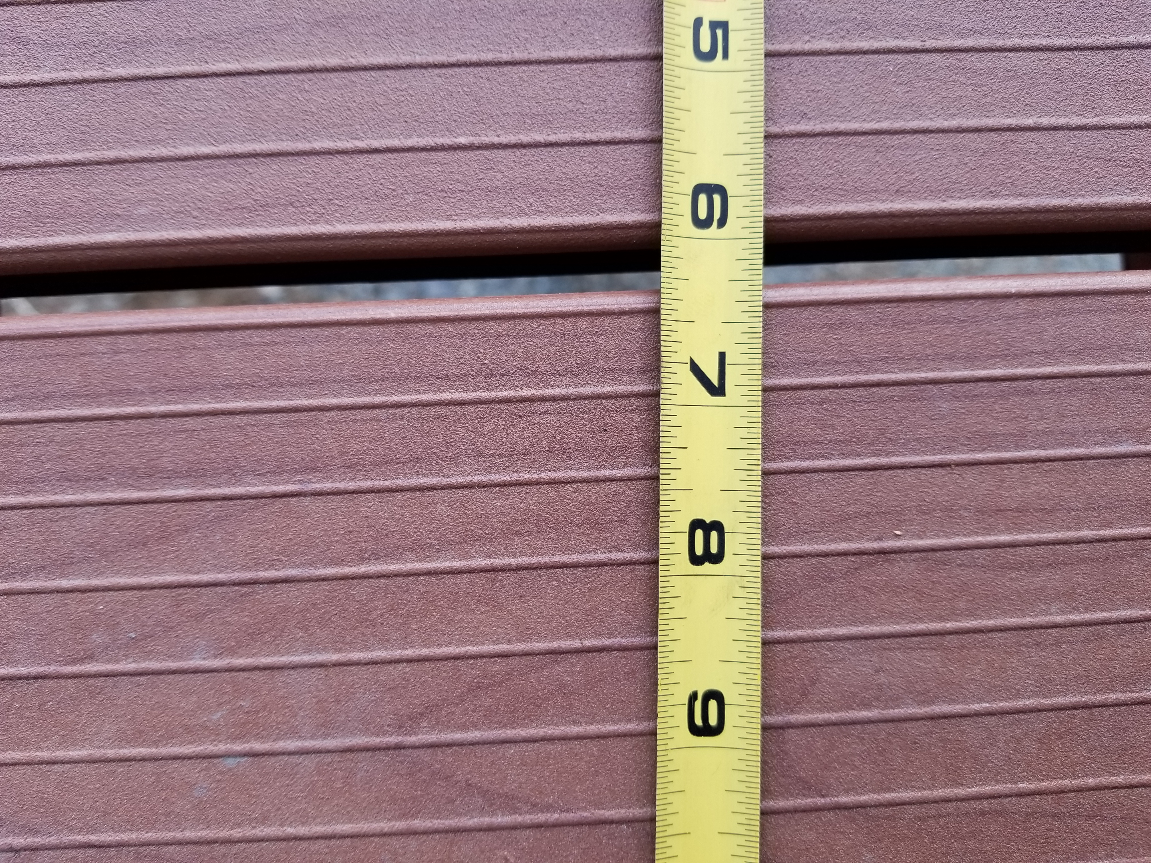

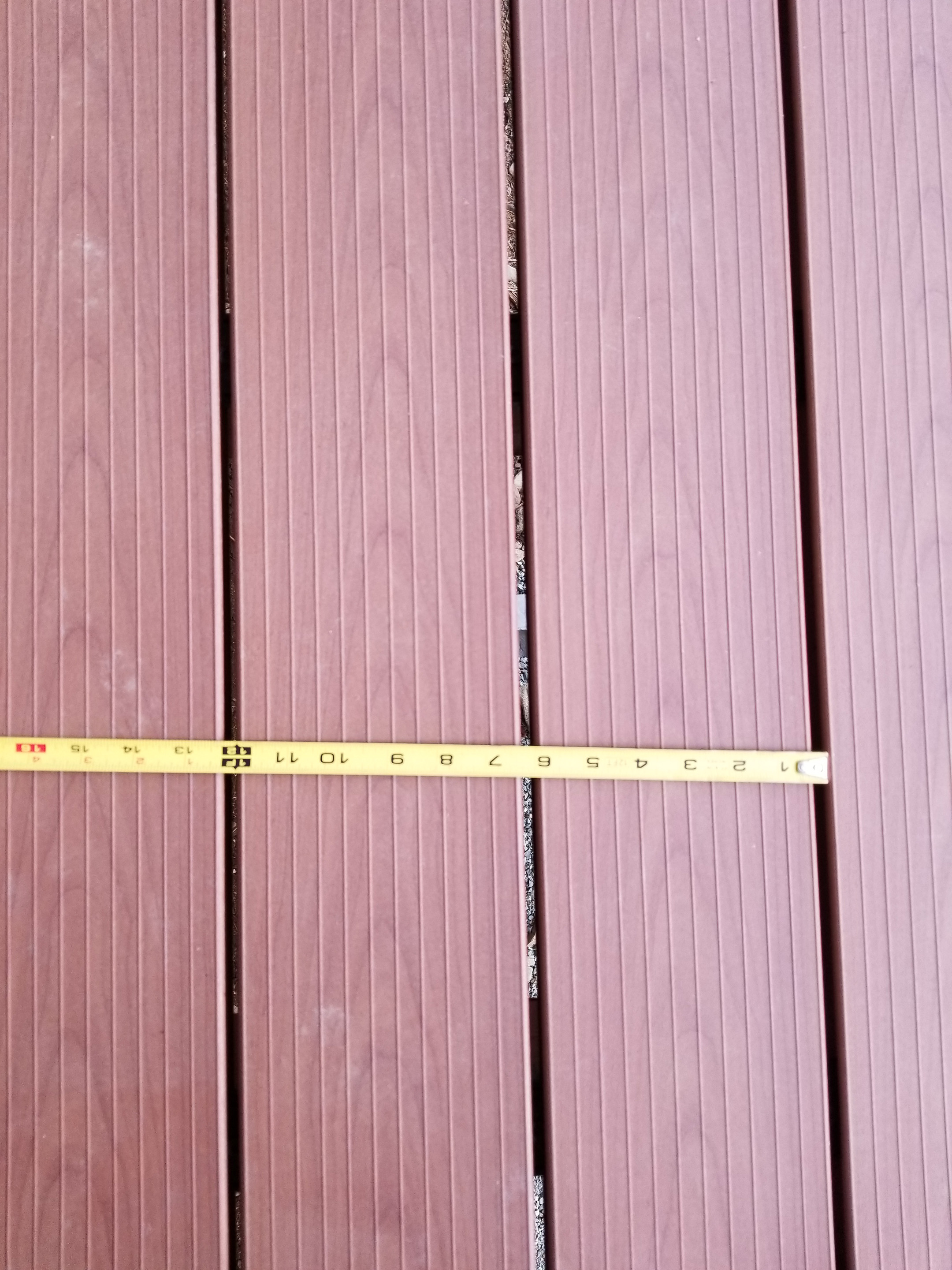

heres a few close up pics showing gaps. i dont have any trees near mine so i cant tell you about needle cleanup.View attachment 552725View attachment 552726
i can assure you that this deck went together in the same amount of time as a wood deck would. there are no face screws in deck, only in the trim. it comes with spacers that screw into joists. Nextdeck will send you a free sample package showing all parts and colors
