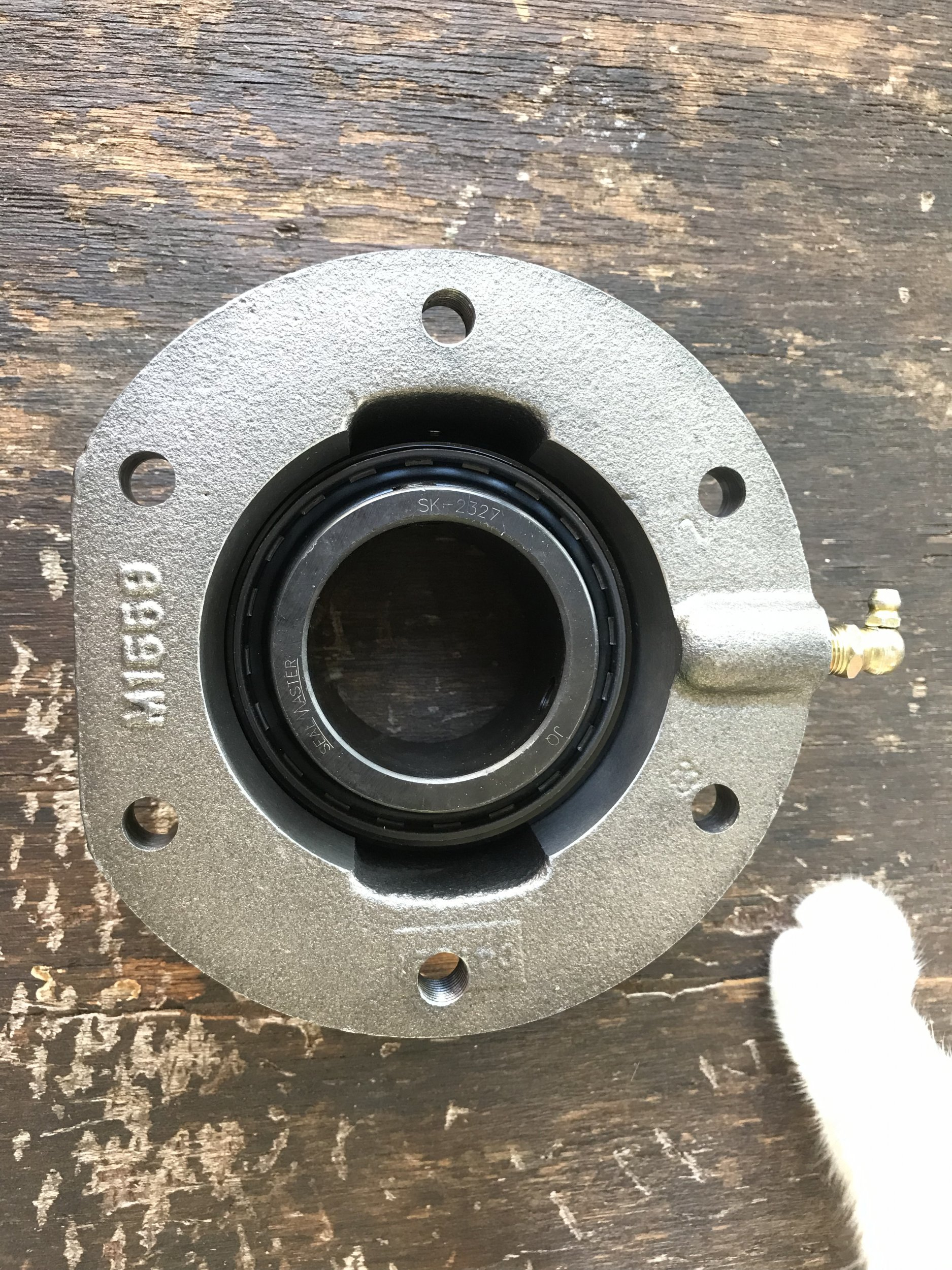

I just bought the bearing with the housing for non-drive side and it was $185.00.
It’s supp to be here tomorrow and I plan to do it on Saturday.
The manual says to support the cutter shaft and use a tool to push the bearing back off the shaft.

You can see that two of the holes are threaded to allow for pushing the housing and bearing off the cutter shaft.

The threaded holes are 7/16" x 20 (NF) Thread and the set screw takes a 3/16" allen wrench.
It was really very easy job even without having any 7/16" x 20 (NF) to push it out.
I think if there is a next time I may try buying just the bearing as it is quite a bit less money.
