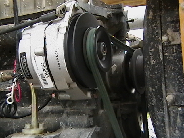

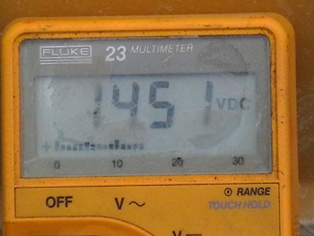

Great, I will check this and let you know what I found out. As for these new alternators, are they still readily available. Up here we have partsource, canadiantire and of course gm dealers. I've seen a picture of the alternator, does it fit in place of these factory alternators or is there modifications?
Thanks
Yes, it's a direct drop-in - same footprint - even uses the same pulley, you just have to put the lockwasher on the backside of the pulley and use locktite on the nut. They will come with a wiring diagram.
I suggest you get the model with the closed face fan because this model draws air in through the rear which is cleaner - doesn't get the direct blast of crap from the radiator. You have to give the Chinese credit though, for installing a TEFC alternator in the first place. A Prestolite 65 amp TEFC alternator will run about $360.00 US.
This is a pic of my installation.

Hmm interesting, I went to partsource and they have a 10 and 12 si alternator but the footprint looked different being the mounted bolts were futher speaced apart from one another and bigger than my stock unit. Also the pulley's were different size but that could be swapped between the two. I'm not giving up though but I think there is some adjustability with the mounting bolts to make it fit.
Thanks for the pics!
/ Noise in transmission #8
I just did a 10SI on a JM 354 Jinma and put the wider pulley on and it took a long neck nut (special). The new pulley is counter bored and is the reason for the nut to fit inside the counter bore. Get the pulley and nut together as a "kit". I'm still tweaking alignment though. It looks like the new alternator needs to be moved forward about a 1/4" to get the belt to run true. bjr
