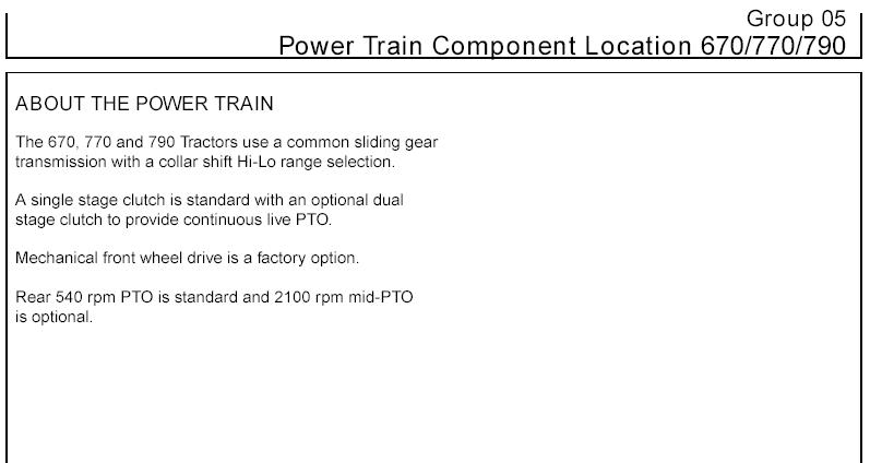

Do you have the power train double-clutch (two stage) to allow operation of the PTO continuously?
And, to be sure we know what "slows down" means, does it appear to be within the tractor or at the finish mower?

It is definitely the PTO shaft slowing down and I do have the two stage clutch but I don't have any of the manuals

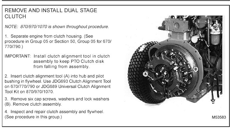

Any signs of oil dripping out of the clutch area? It would be an indication of a crank seal leaking and maybe getting on the clutch.
If interested in tackling the problem yourself, I'd urge you to get the CD tech manual. Not that expensive and very informative on the R&R repair with good illustrations.
Here is a pic showing the dual clutch. Appears there are special tools needed to keep the package together when removing, and for sure, when installing.
