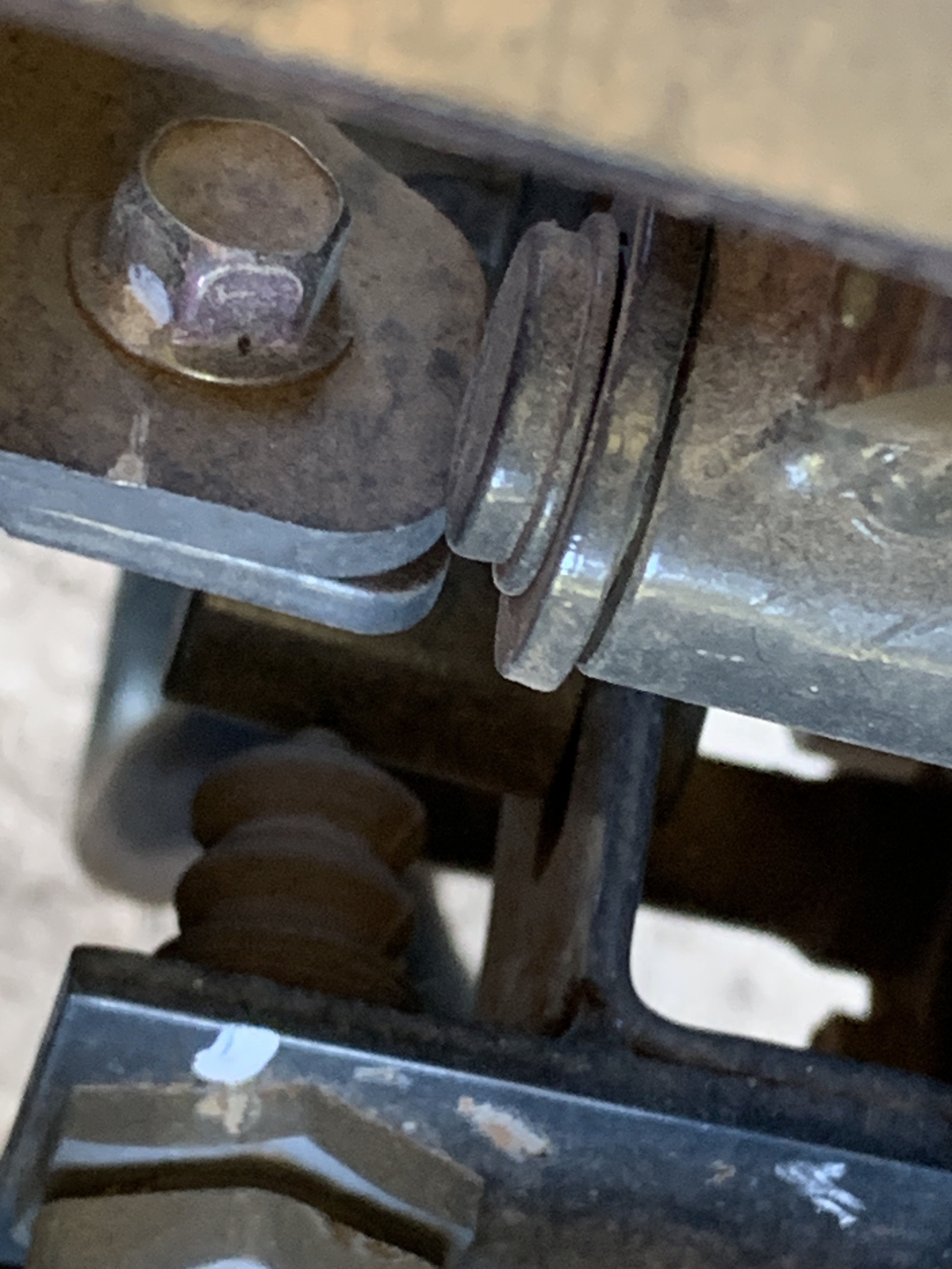

I was able to crawl around the tractor today in order to look at switches. Everything seems fine with the switches unless something internal is wrong. No debris was found that could block anything and when I moved levers back and forth the switches appear to be moving back and forth without any issue. I have a couple of pics to make sure I'm looking at the correct parts. First pic is of the PTO switch. The second pic is of the clutch switch. One thing that did change is that today when I turn the key to the first position I now hear a loud click coming from the starter. When the key is turned to second position nothing happens. Yesterday there was no noise when I turned the key.

Dumb question but you're certain the PTO lever & switches (whatever the machine has) are disengaged? Just thinking if he shut it off in a hurry maybe something didn't get turned off.
/ Starting Problem with Branson 2400H
To the best of my knowledge they are disengaged. When I pull on the PTO lever I can see the metal bar push up on the switch. The switch is housed inside the rubber boot so I can't tell what is going on mechanically on the inside of the switch but from the outside it looks like everything is functioning correctly.
/ Starting Problem with Branson 2400H #9
To verify switches are operating you would have to unplug the wires and confirm the contacts are opening and closing. The switch on my clutch got water in it and froze first year I owned so cut the wires off the switch and wire nutted them together until dealer got a replacement. They kept my jumper to to use for testing failed switches.
Key switches do fail but usually not suddenly like this.
Since it now does different things when turning the key it certainly points towards and electrical problem. I believe there is or was a post with service manuals for Bransons on this forum. It was in Branson section and if memory is accurate was started by Asteral.
