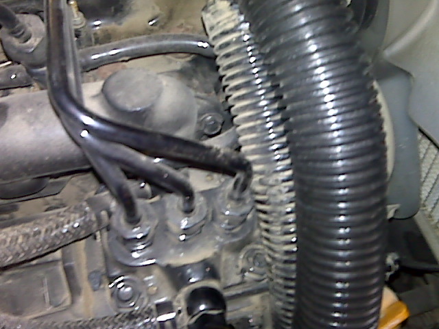

Well, I got my tractor back this evening. A wire worn through about a pin hole size hole rubbing against the Injector tube under the hood. It was inside the large harness with the corragated tubing. The corragated tubing was worn thus exposed the wire to the tube. WOW! I looked and traced every wire off that circuit board and missed this. Cost me a new Ignition Switch/module and a few hundred dollars labor. Live and learn!!
So the lesson is to check and double check the harnesses if you have a Module issue that repaets itself.
At least the mechanics at the dealer stated that this was a real difficult find and they have never seen such and issue on this model tractor, especially where it was located.

OK I have mowed the front three acres and so far so good. Rain and cold weather stopped me from finishing. I took some pictures of the location of the harness under the hood and attached them. Inside the harness there is an Orange wire and that was the culprit. It is part of the safety system related to the PTO circuit. It all makes sense. Hopefully It is solved and there will be no more issues. Anyone with similar equipment should look and make sure there is no issues. The picture shows a large harness running close to the three injector tubes. Mine was touching the right hand tube at the bend and wore through the corrugated tube and into the wires underneath.
Thanks
Bob
