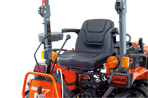

My BH77 has its own seat. I'm 6-2" and its cramped.
/ No seat on bh 77 #7
It's supposed to come with its own seat. If you Google "Kubota BH77", you get some pictures of what it looks like. The BH seat is back-to-back with the tractor seat, so your head is directly under the ROPS. They are pretty tight for space, so it helps if you're built low to the ground with short legs. Dealer probably has it sitting in the Parts Dept., wondering where it came from.

My BH77 on my B3300 doesn't have it's own seat and I don't want one either. It's an option to have the second seat, not just that the dealer 'forgot to put it on'. I'm 6'2" and have the seat set about mid-way on the slide tracks and happy with it in both forward and swiveled backward. I do a lot of quick stuff (like picking up a single rock) from the forward seated position with just reaching around behind me to run the controls. The flipped up second seat would all but eliminate this possibility.

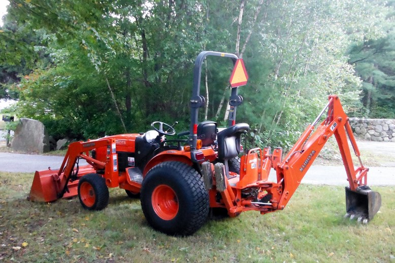

Looking at the hoe picture in your "Super B" post and comparing it to my BH75...it appears that the control levers for the 77 hoe are longer and angled back for the "swivel seat". On my 75 the control levers are straight up for use with the separate hoe seat. I don't think those angled one would work even if you fabricated your own seat assembly. You'd probably have to swap out the levers.

so can someone with the bh 77 with a seat tell me if you have straight or curved levers please

I haven't seen a new 77 with a separate seat. I'd call your dealer and ask him if the 77 is available with a separate seat. If it is, the levers might be swapped out as part of the "hoe seat" option.
/ No seat on bh 77 #20
Straight here. Separate seat. 6'4" & no way I could operate controls from the seat. Couldn't get my knees far enough apart to clear sticks. Had to fab up new brackets to move seat back about 8". Much better now. It is pretty much impossible to reach hoe controls over flipped seat.
