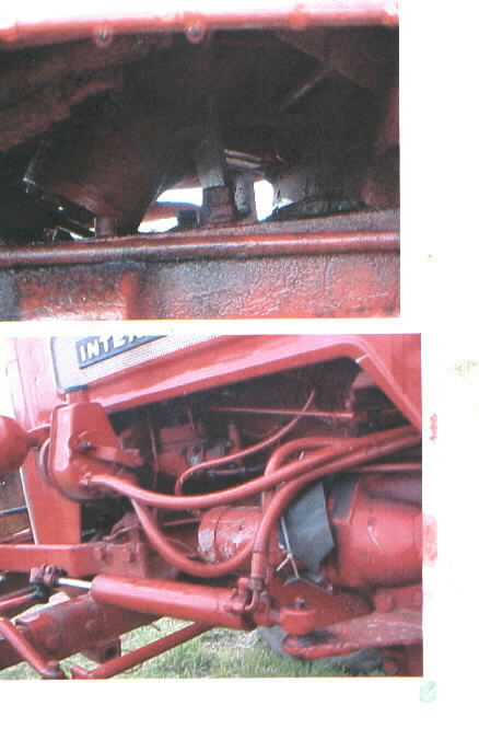

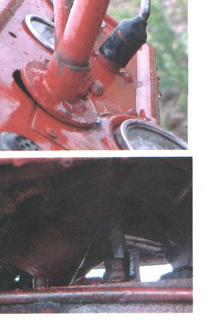

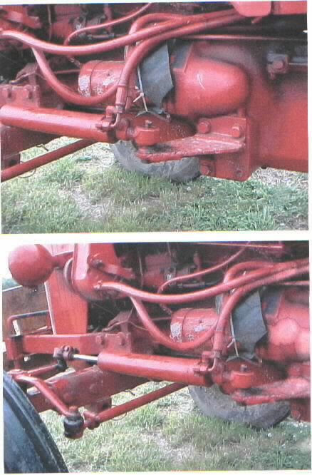

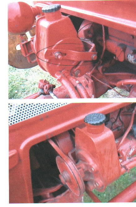

   / No Powersteering #19
These pics are from a conversion done by a friend. For my tractor I want to install the power steering pump under the hood using a pump with a seperate resevoir. Brackets can be made to fit, the orbiting motor can be purchased at your local hyd. supply. Be sure to measure the distance that your steering assy moves from far left to right to size up the steering cyl. Cyls. can be purchased new or used at a salvage yard dealing in equipment. This tractors conversion was done for less than $100.00. Sound investment in my opinion....
