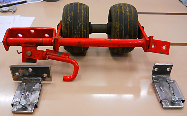

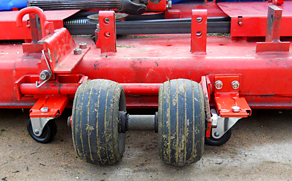

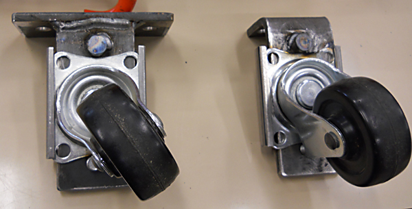

I bought my B7500 9 years ago with a FEL and 60 inch MMM. This was my first experience with something bigger than a lawn tractor and and I've learned much from these forums. I've learned that Kubota at one time had decks that you drive over to install. I've also seen pictures of Kubota decks that have 4 corner wheels that all swivel making installation/removal much easier. My deck, unfortunately, is one that has 2 corner swivel wheels in front and 2 wheels together in the middle of the rear that do not swivel. I was younger and stronger in those early years with my Kubota and dragging the deck sideways under the tractor was not all that difficult. I know there are postings showing solutions that others have made for this problem, like a plywood pattern with casters, but I wanted a simple solution especially since storage space is at a premium. I ended up making a couple of brackets out of 1/4 inch stock that allow easy install and removal of small swivel casters. The brackets utilize the same 5 holes that the rear gauge wheel assembly bolts to the deck. The casters are 2 inch rated at 110 pounds each. They slide on the bottom of the brackets til they hit a stop and a stubby 3/8 bolt is then hand tightened to prevent the caster from sliding off. After the deck is mounted and raised the casters are easily removed. The gauge wheels must be in the number 1 or 2 position but the design can be modified for the casters to touch first in any gauge wheel position. Below are pics showing before and after pics along with pics of the brackets separately.

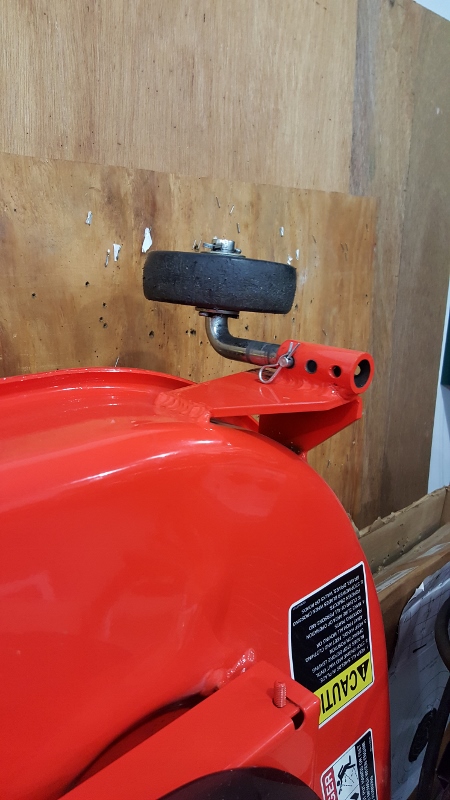

Zmansmac. I have a new B2650 with 60" mmm. the deck looks identical to yours what I can see in your pictures. On mine you can take and lower and turn 90 degrees the left rear anti scalp roller to allow it to go sideways. It already had the holes in the shaft that holds the roller new from the factory. I then just lower the 2 front bogey wheels that the deck rides on when mowing to raise the front of the deck. I then raise the rear gauge wheels all the way up. This allows the deck to ride on these 3 wheels and it holds it up off of the right rear anti scalp roller so there is no restriction. I then lower deck, unhook all the pins that hold the deck on, unhook the pto shaft, turn the front tractor wheels all of the way to the right, and can easily pull the deck out the right side with one hand. It only takes a couple minutes start to finish. Not sure if yours is the same being 9 years older, but I thought I would share this as it might be able to help somebody. I am going to post a couple pictures with this and the deck is stand up along the wall for winter storage thus the angle of the pictures.

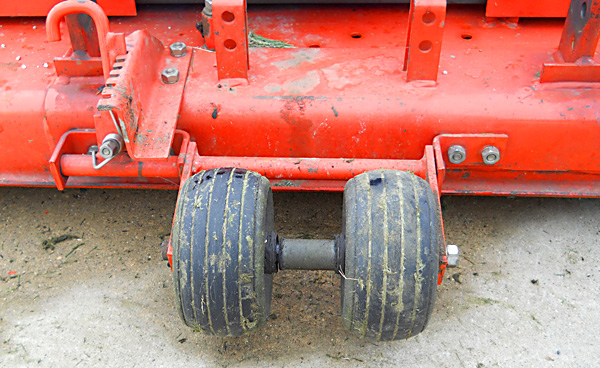

There are many Kubotas both new and old with drive-over decks. I've never figured out why Kubota chose to select the ones they do for the feature. Here are a few examples: (all are 60" decks)
First one is a BX2230 which has no provision for drive over but can be pulled out sideways. Note the corner wheels do not swivel. It needs those homebrew casters or similar.

By the way, I forgot to post what a great fab job you did on your mmm wheels. They look great! It is fun to weld and do any kind of fab jobs on your tractor or equipment. Well done.
