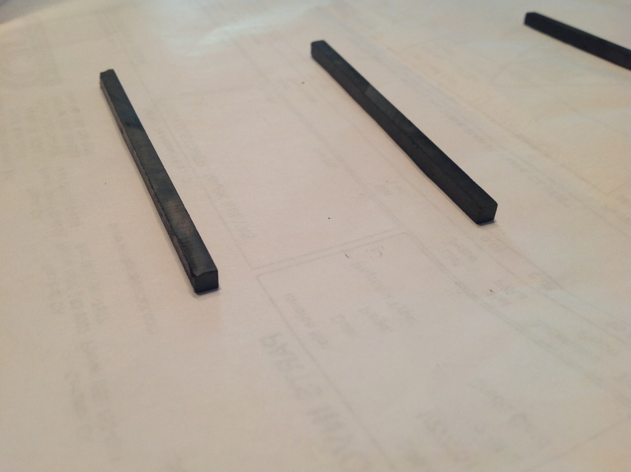

I just did my 50 hour service on my JD 2032R, I cleaned the transmission screen and the magnets as per the manual, after I installed the new transmission filter and finished the 50 hour service and was cleaning up, I noticed the same type of magnets inside the old trans filter but did not see any in the new filter. I called the JD dealer and asked them to look at a filter to see if they come with magnets or if I was suppose to transfer the magnets, they responded by saying their trans filters have no magnets and have no idea why mine did and have never seen magnets in a trans filter.
The manual does not mention magnets in the trans filter, only in the screen.
Any John Deere owners run into the same situation on their 50 hour service.

The previous 2 series (like my 2320) has the magnets on the screen and I don't think they changed that, so I would have expected magnets. The magnets don't come with the filter. You just transfer them. I would chalk up the discussion with the dealer to miscommunication, put the magnets back in and don't worry about it. Space the magnets evenly around the filter. They may have moved by the time you took them out.

Thanks for your response, I think you might of misunderstood my question, the screen has magnets and I did put them back, I was talking about the filter. When you say filter your not referring to the screen are you. If magnets go in the filter why doesn't the manual tell you to transfer them. You can't really space the magnets out because they attract one another. Unfortunately I noticed the magnets in the filter after the service and after I added fluid.

There isn't magnets in filter. Just screen

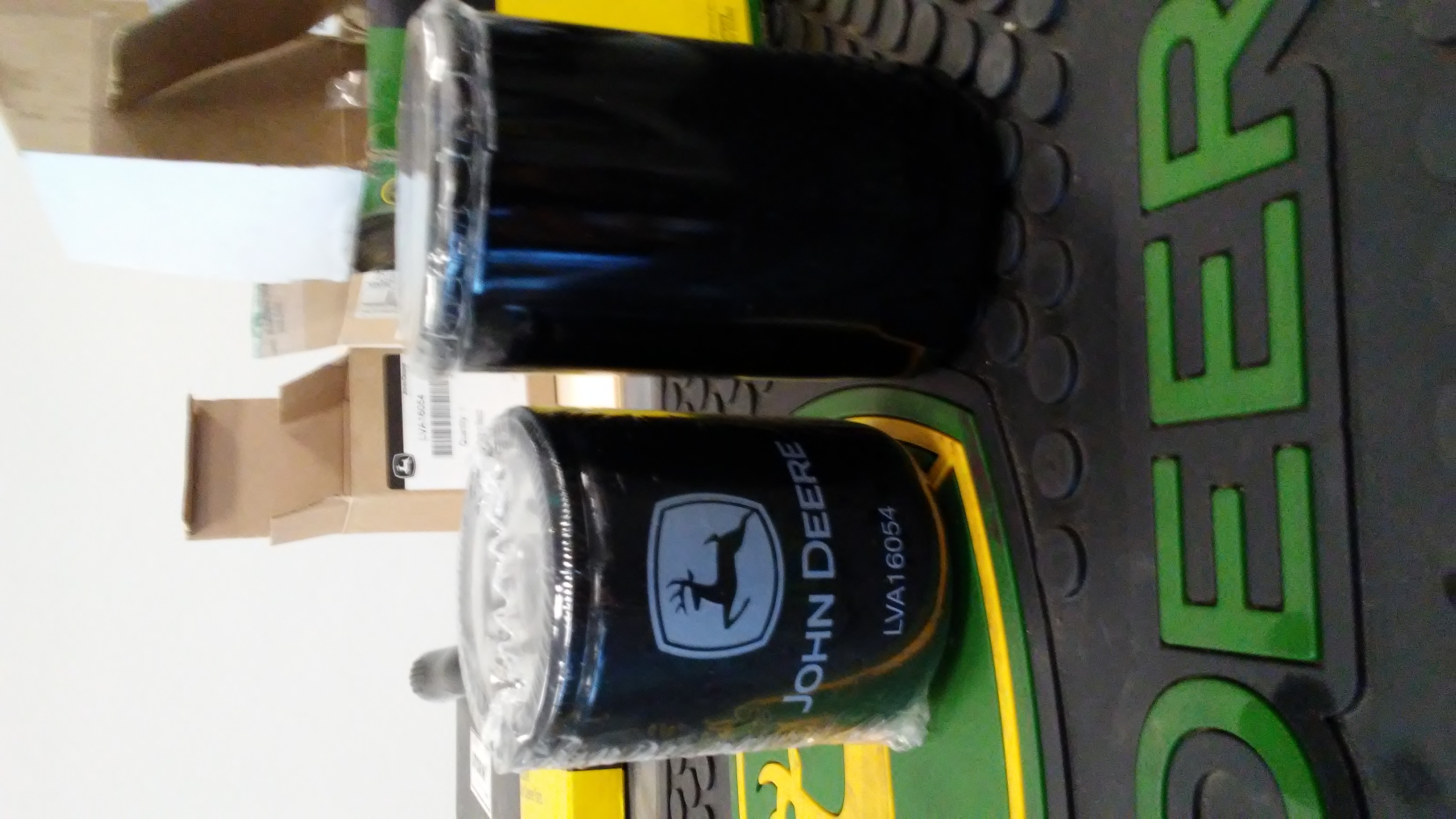

I live in Ca. But bought the tractor from Minnesota. I called another JD dealer and he gave me the same part number you did (LVA16054). he also looked up the LVU800097 and the schematic showed magnets that can be ordered for that filter. The service manager said he would check into the situation and get back to me. Very strange that a 2016 model can have different part numbers or can be changed from the manual. ( part numbers are subject to change without notice, part numbers maybe different outside the USA)

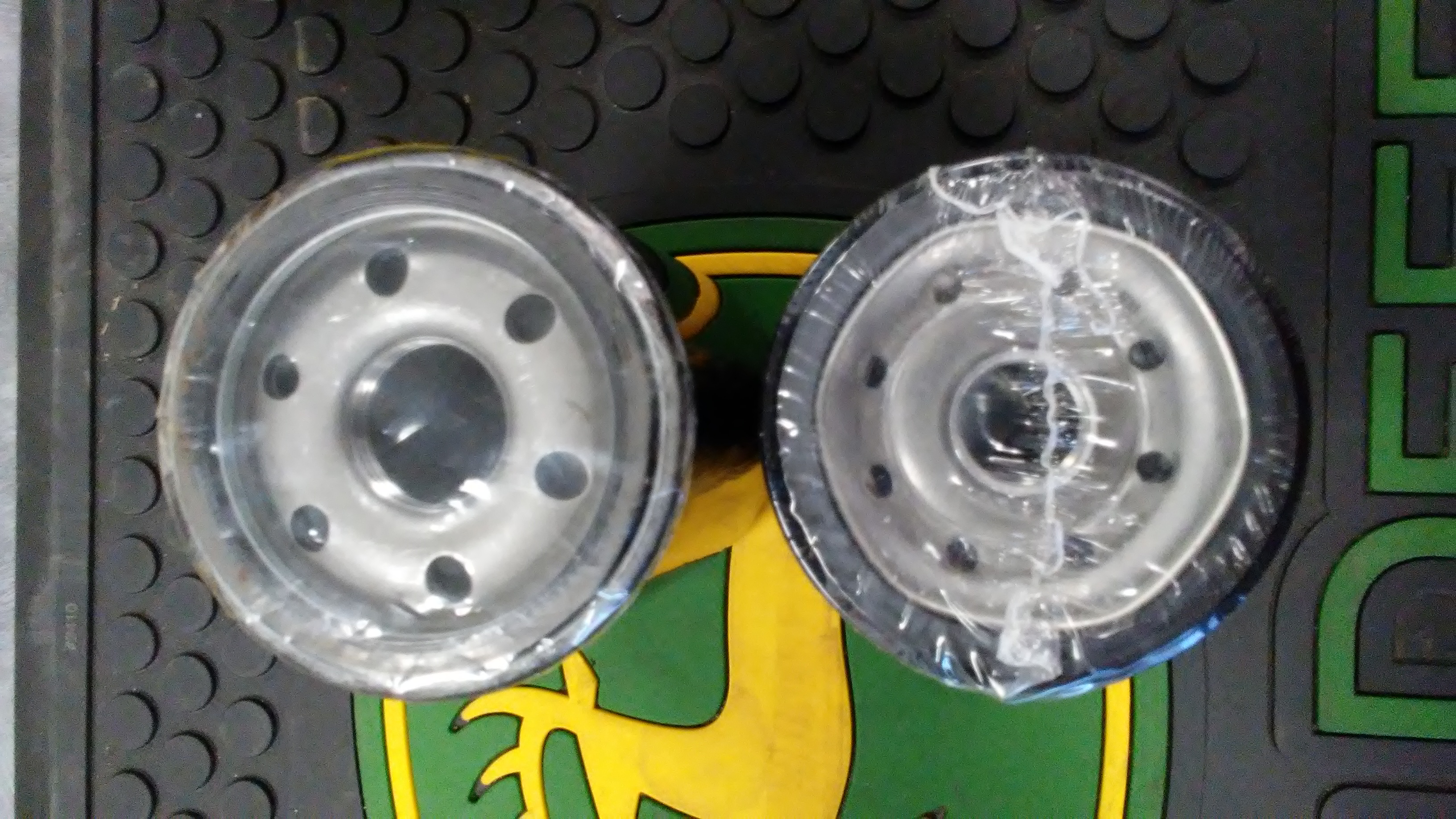

This is what I found out about the trans/hydraulic filter. If you live in North America and tell the JD dealer you have a 2032R he will give you a LVA16054 and it won't fit your tractor. If the JD dealer looks under world wide he will give you a LVU800097 and it will fit your tractor. I went and looked at the other 2032R's on the lot and sure enough the filter is the same as mine. I had him pull both filters to compare side by side and the threads are different sizes. Because the tractor is a 2016 the dealers are not familiar with there being magnets in the filter. The manual says nothing about magnets or transferring them, so it's up to the owner if he feels it necessary. If other 2032R owners find out something different leave your feedback. I forgot to add that this is a HST unit.

If you look under your 2038R, what filter does it have on it, the longer LVU800097 or the shorter LVA16054?
