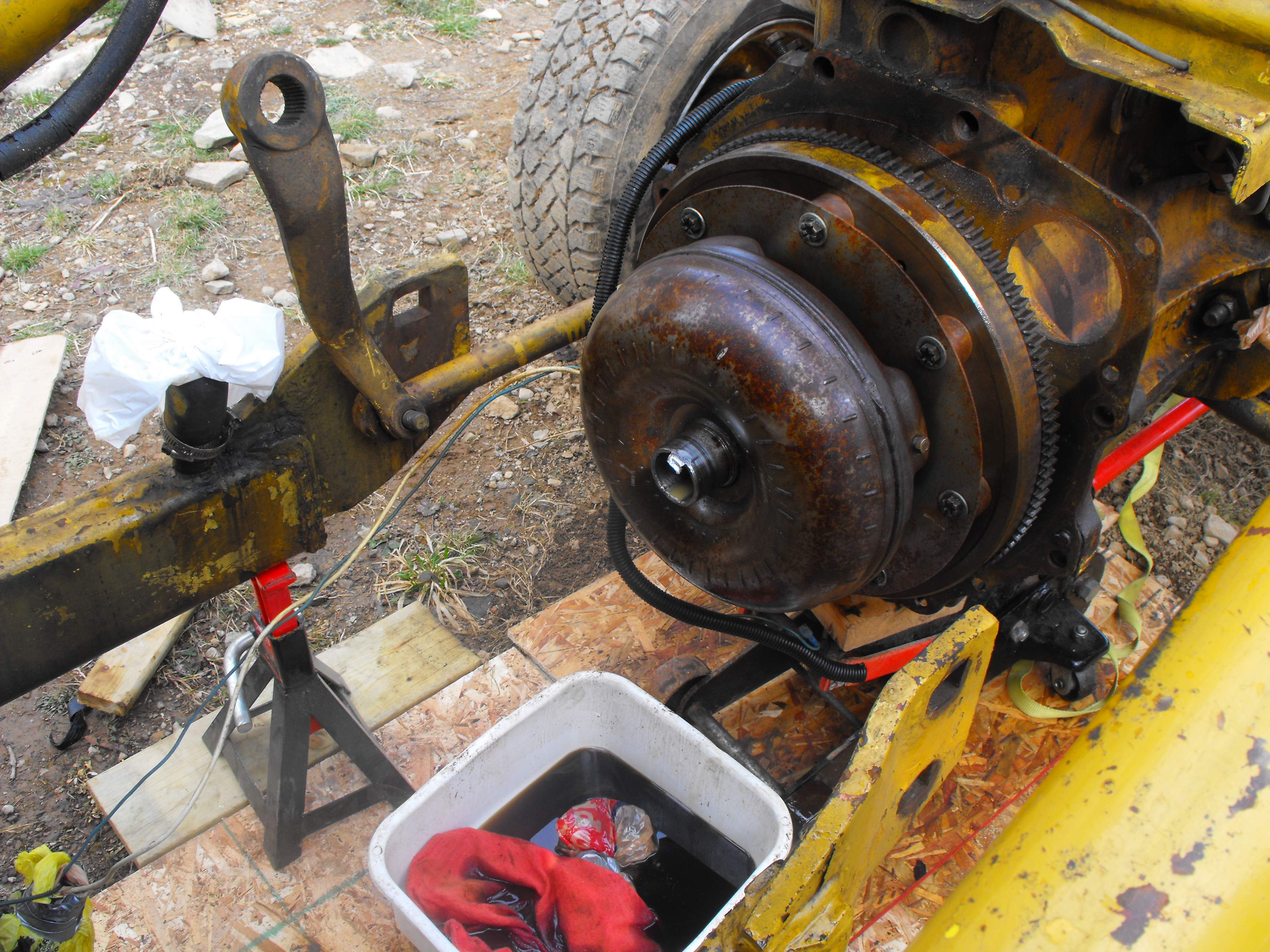

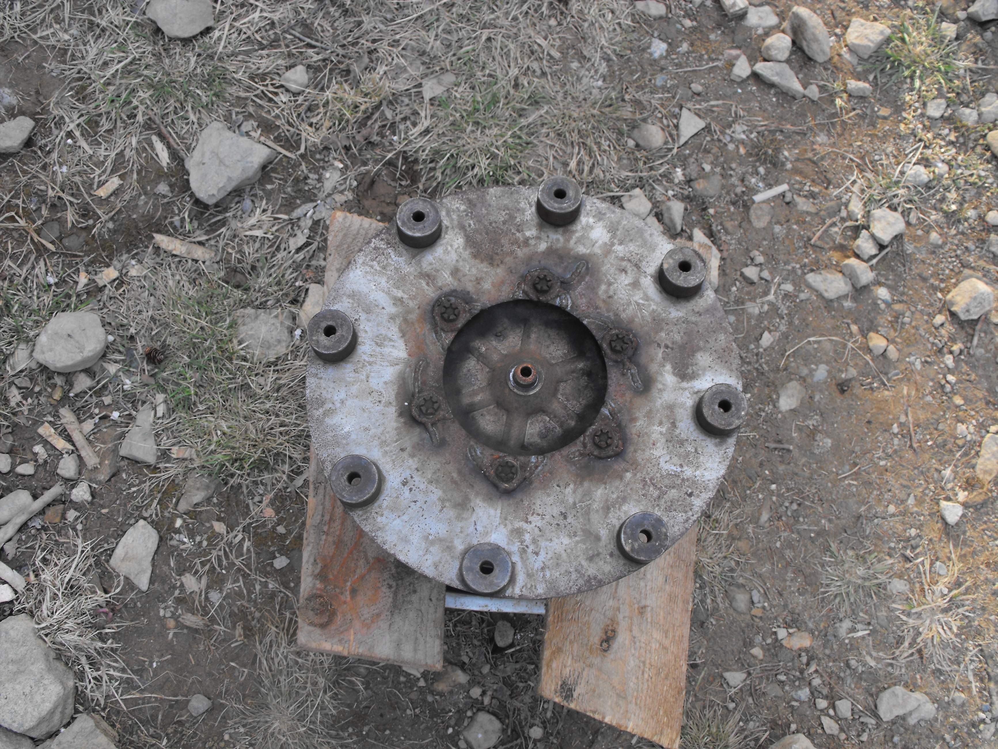

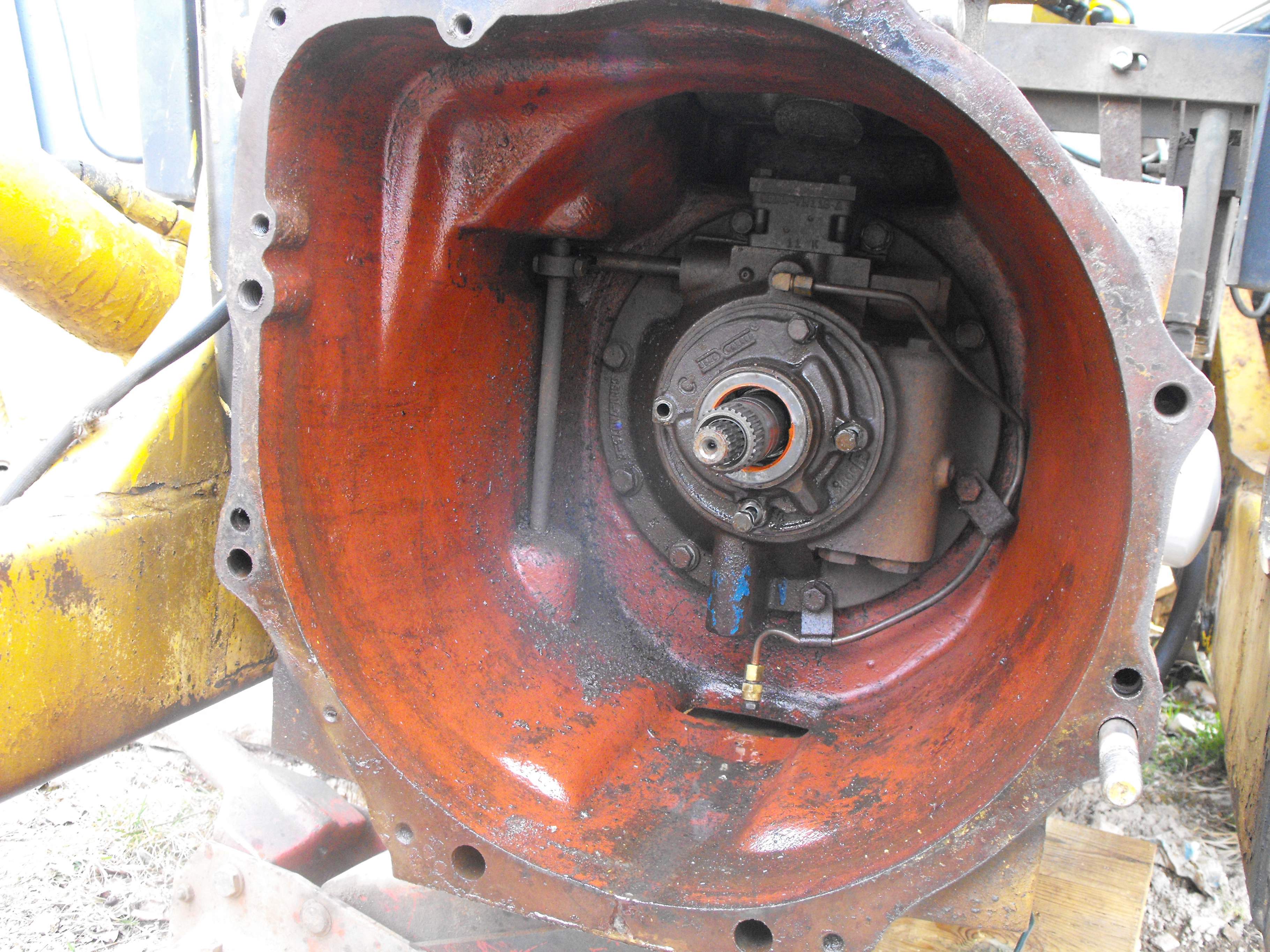

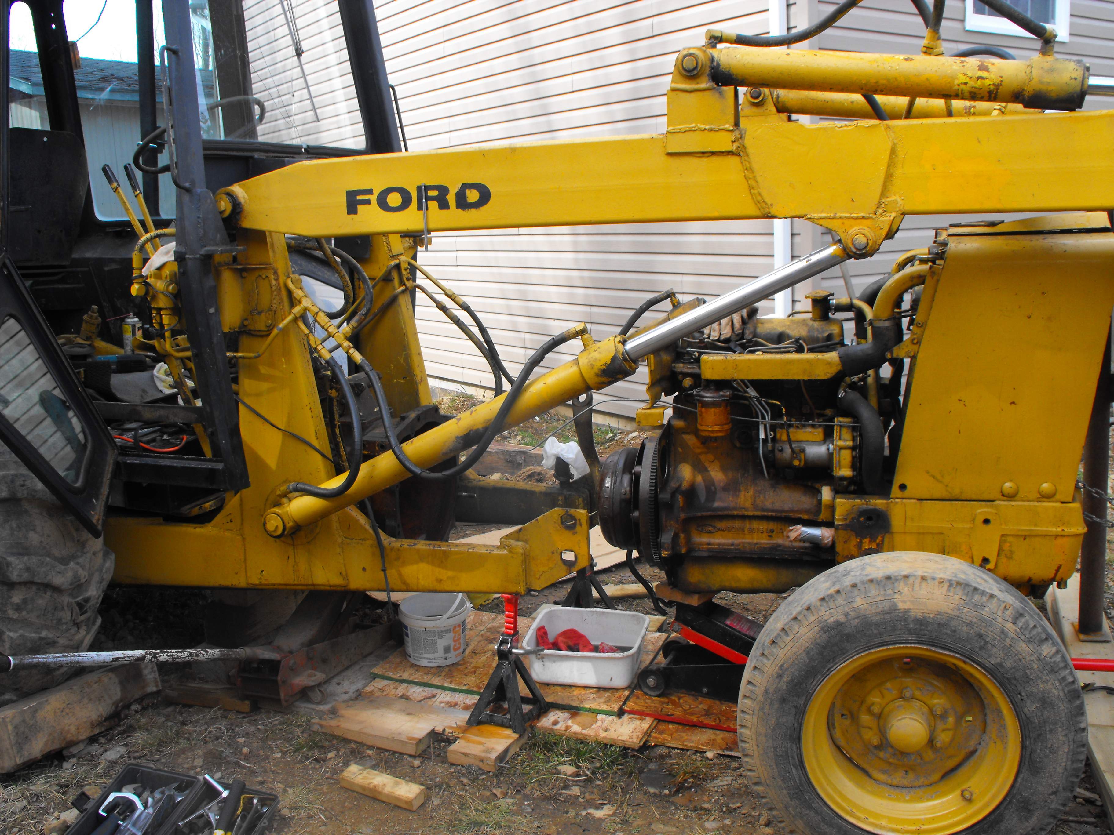

#78
Split the Machine, not good, here are the pics, torque converter damaged, I'm not surprised. Just hope the shaft on the pump side is ok. Anyone know how to remove the pump? Was the plate on the Torque Converter altered with the weld around the bolts or is this normal... :(

   / No idea what year this Backhoe is #79
Looks like you did a great job of getting it opened up. Hope you find what you need in the way of parts at a good price.
   / No idea what year this Backhoe is #80
Did you get page 12 of the manual? It looks like you just have to remove the 4 bolts to remove the pump.
It looks to me that the drive plate may have had some fatigue cracks around the bolts and somebody has welded them up, but I never had mine apart that far so that's just a guess.
