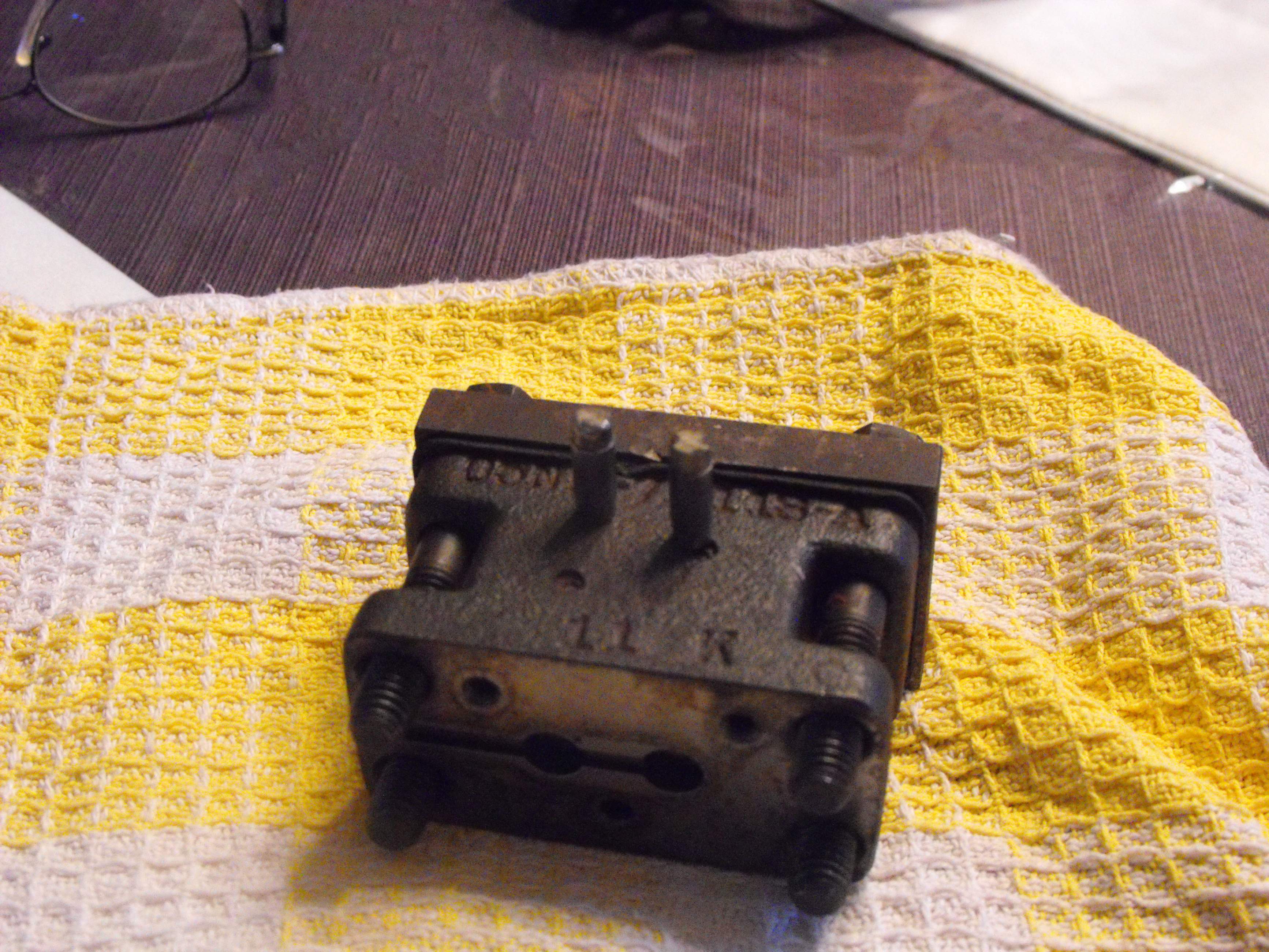

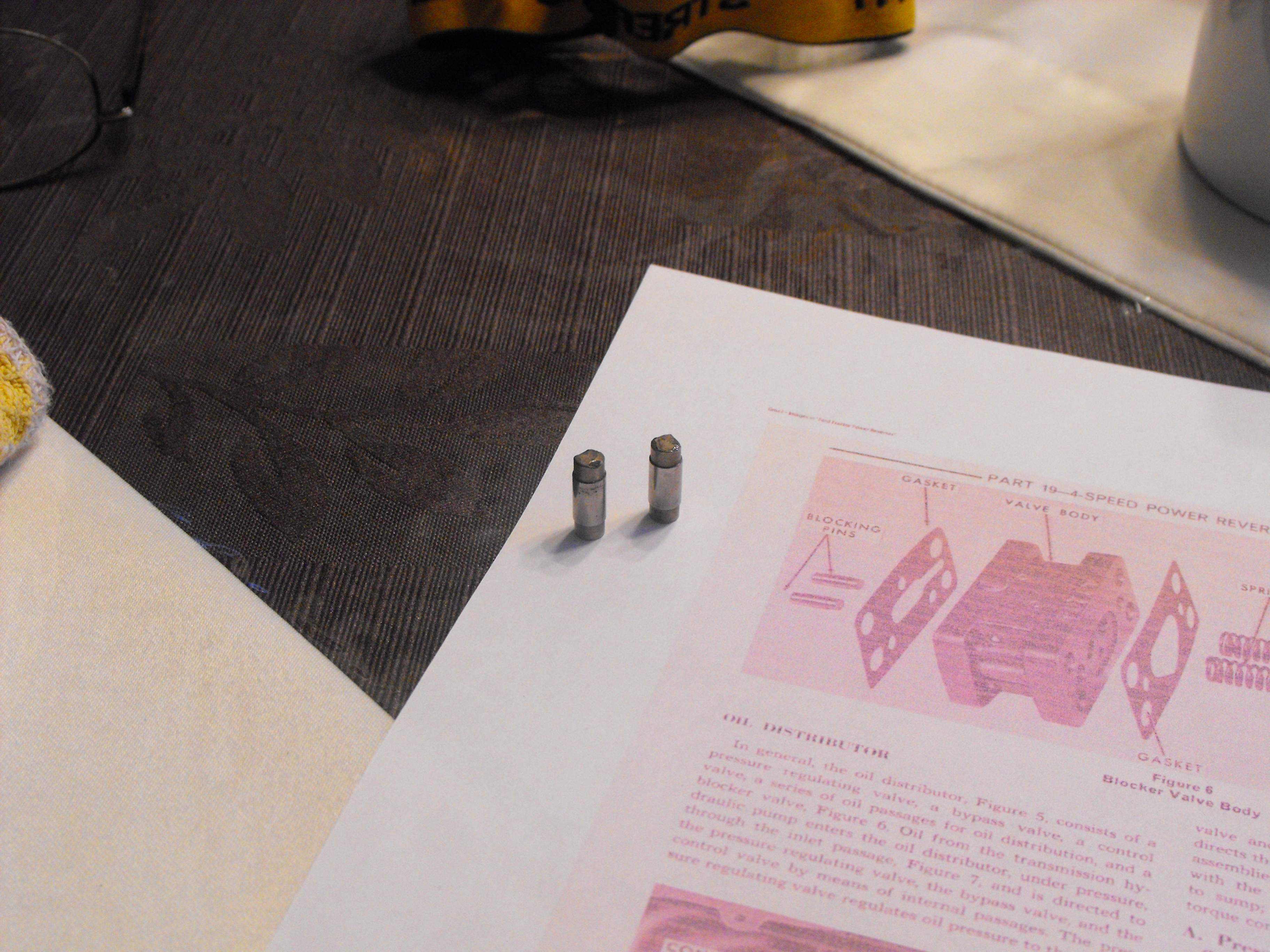

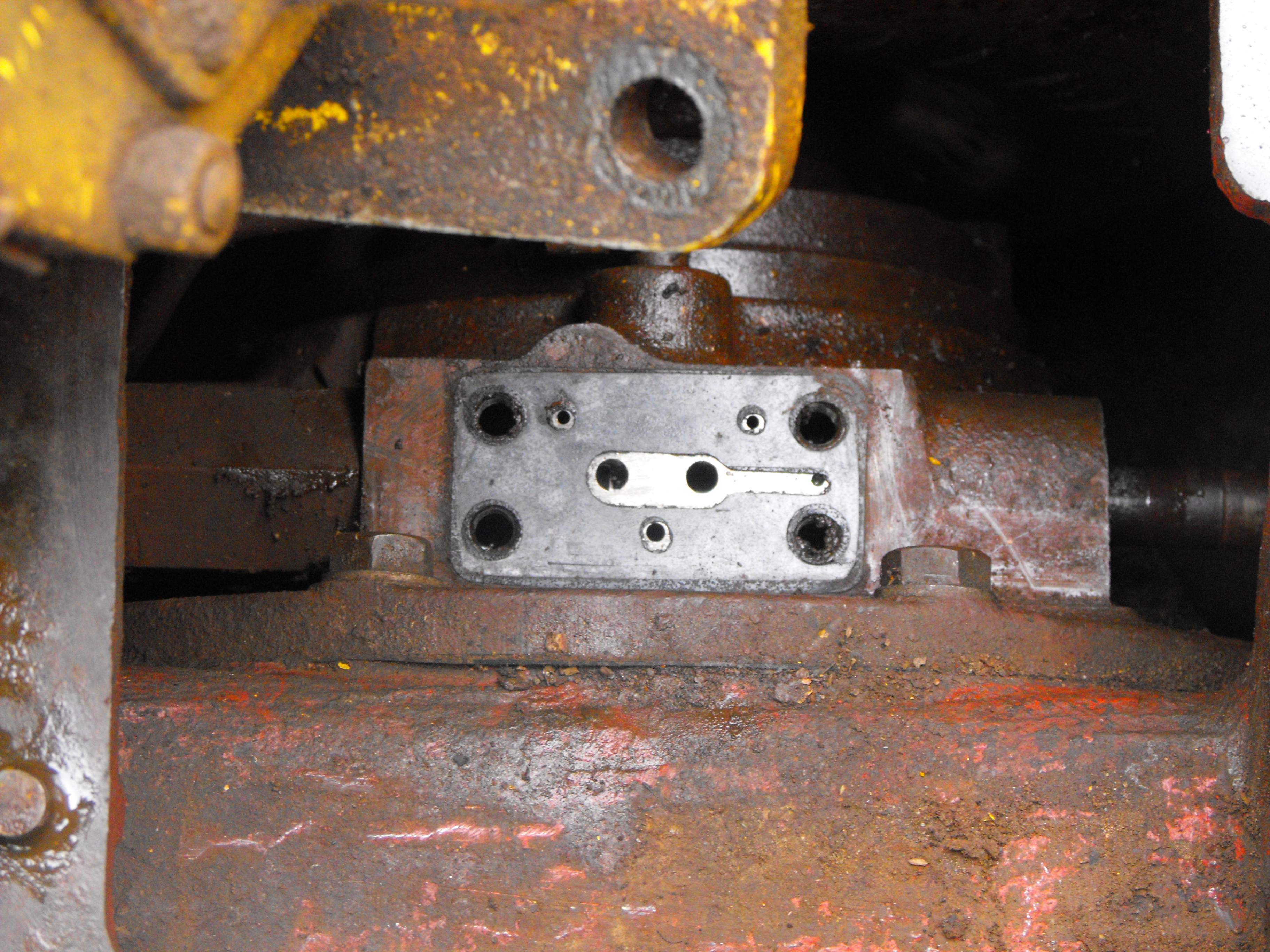

Bought four bottles of sea foam the other day put it in and let it idle for awhile with no success, doh! worth it though took that milky look out of it. I removed the fuel tank and shroud and steering column, removed the block valve and took a magnet and popped out the blocker valves and voila shaft moves freely...
now what does this mean I took the block apart and cleaned it blew air threw all the ports on the tranny has well. got pics of the blocker valve. ? I put the valves back in the holes and the shaft would not move until I removed them, shouldn't the shaft move when the motor is shut off. I'm stumped Any suggestions
tks for all the help:drink:

Thanks for the update and photos. Glad the Sea Foam addressed your moisture problem. I would not expect Sea Foam to help with any sticking valves until after working the BH 20-40 clock hours which is not possible since yours will not move.
Did you pull PSI readings at all of the test points to see if any were out of spec? It sounds like you may have something preventing fluid from reaching the block. What kind of flow will the open lines produce on a quick start up and shut down?
You really are going to determine where you have/do not have the correct PSI readings at all of the test ports. Our JD shop manual has them labeled and min PSI readings.
If you had a helper you could just open test ports one at a time with the engine off and then start it up with a hose on the test port to check for flow. I would not advice this but to purchase a gauge set that can read upto 3000 PSI and test it right.
