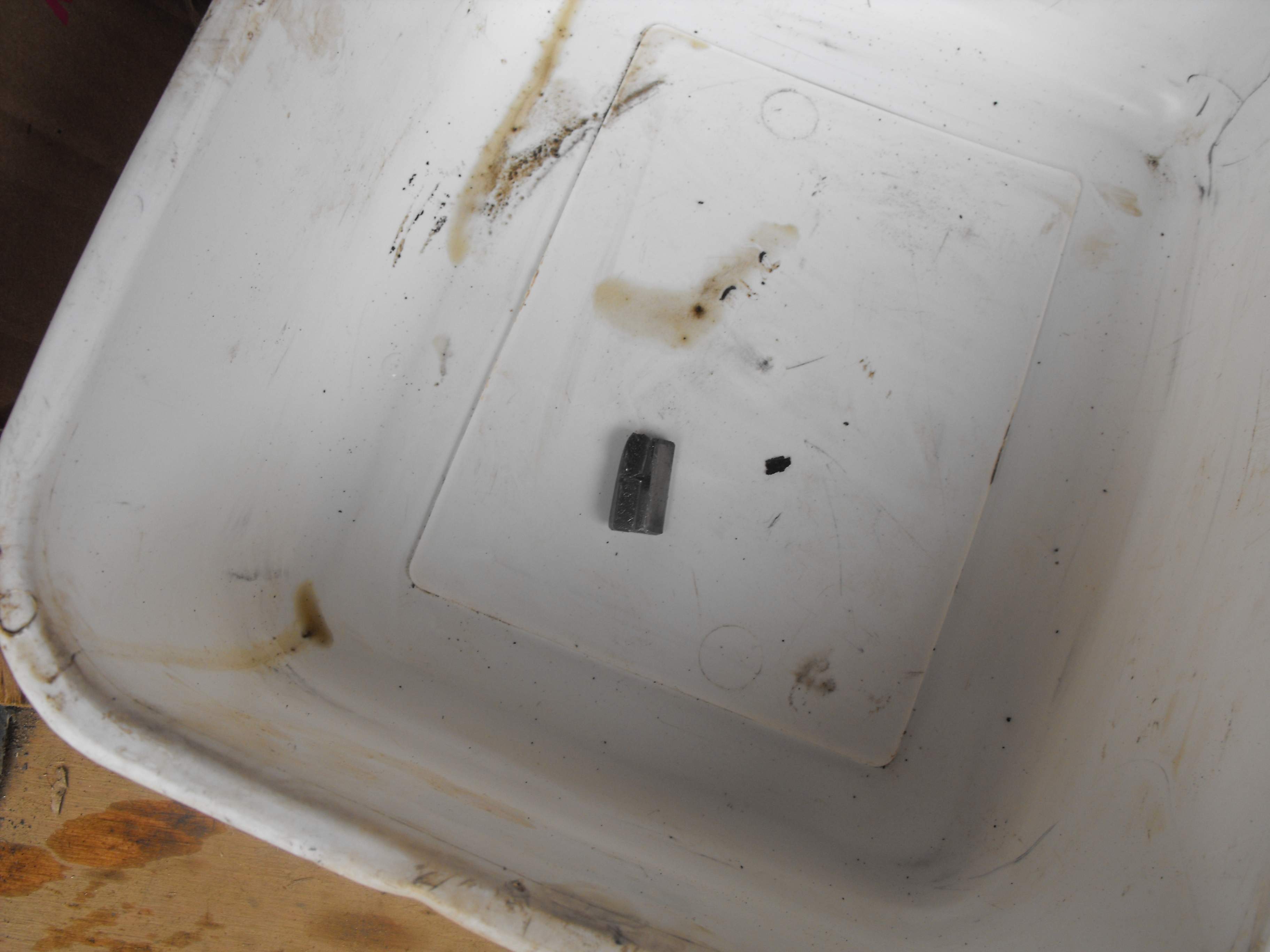

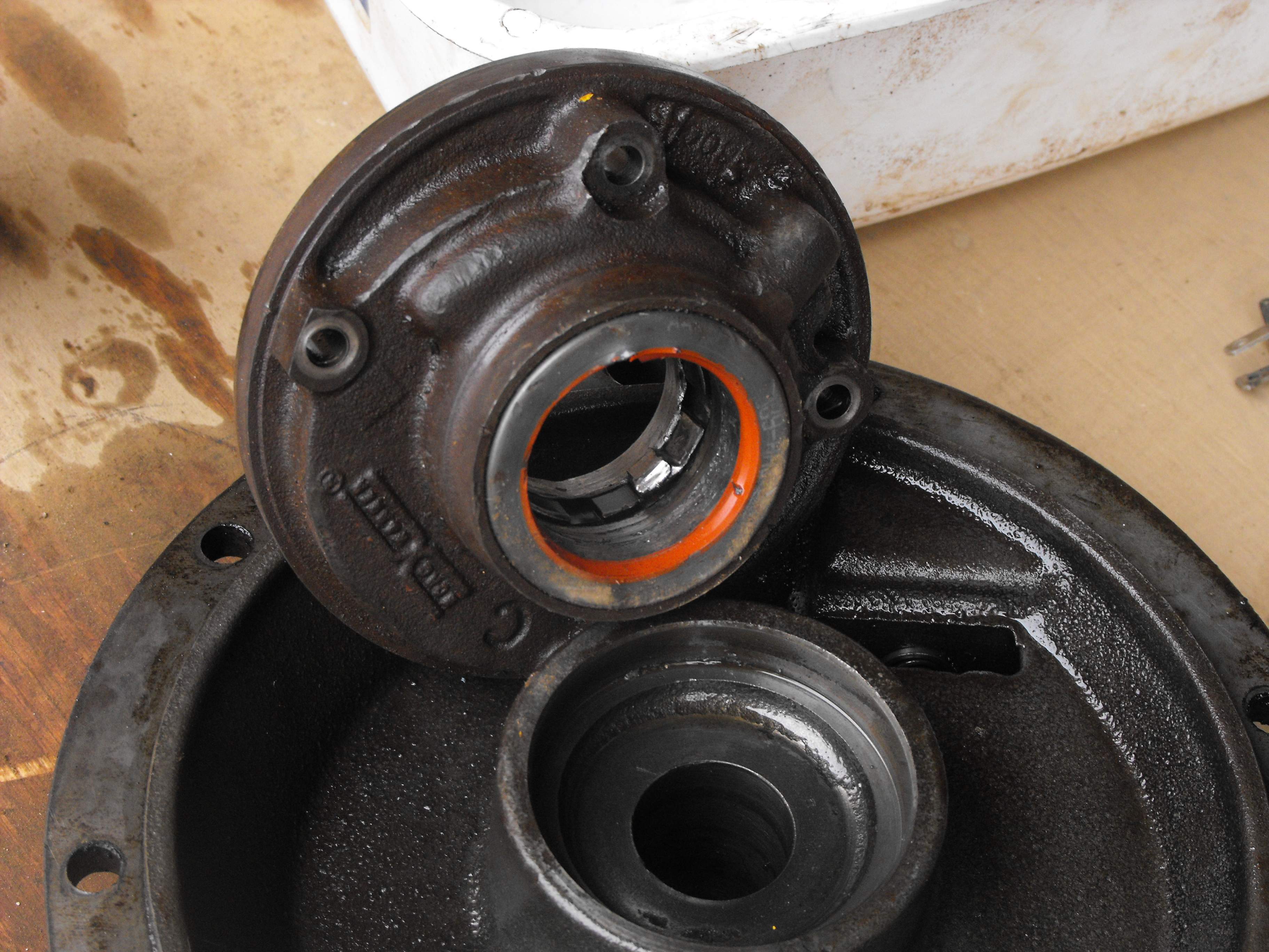

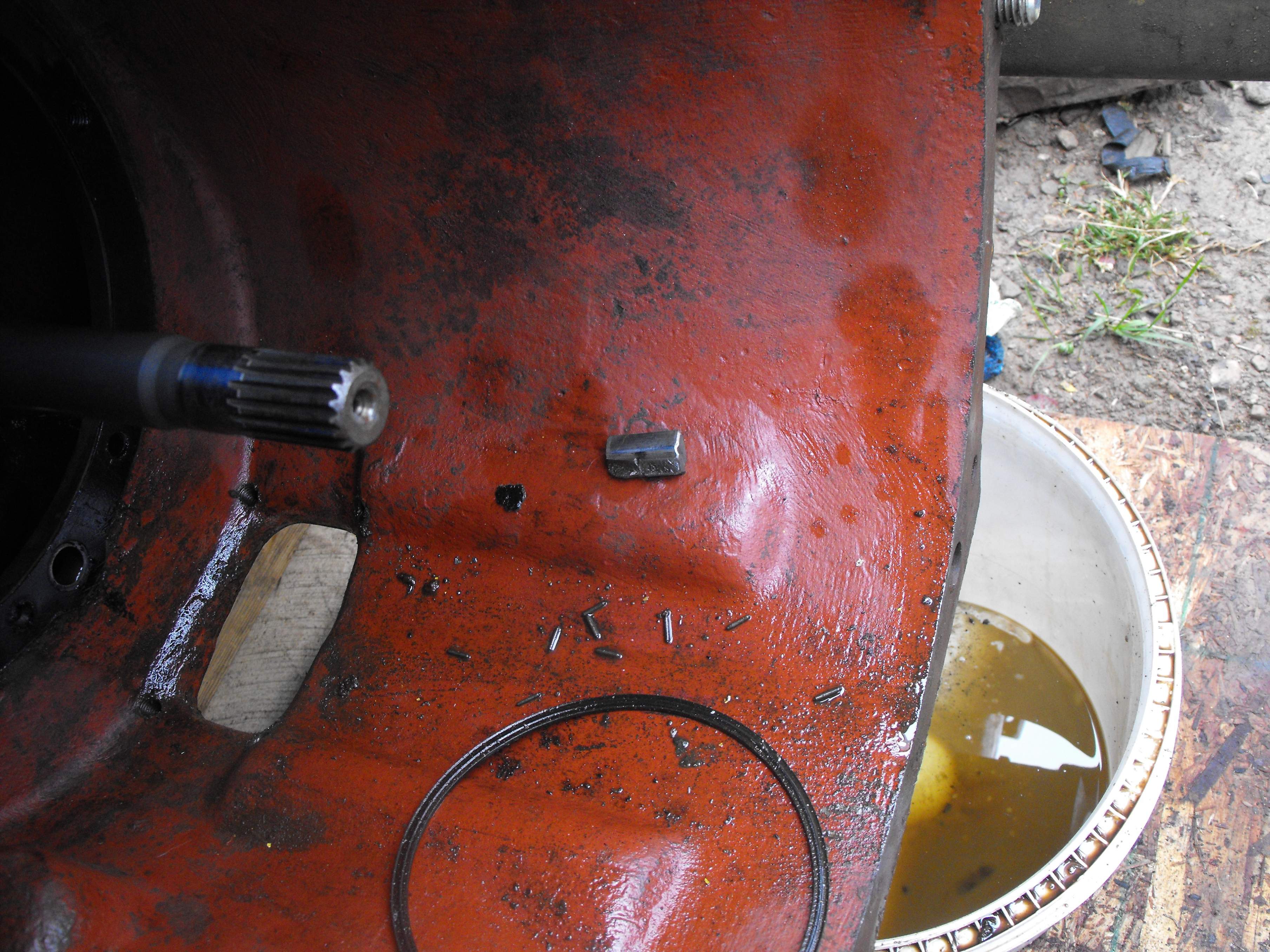

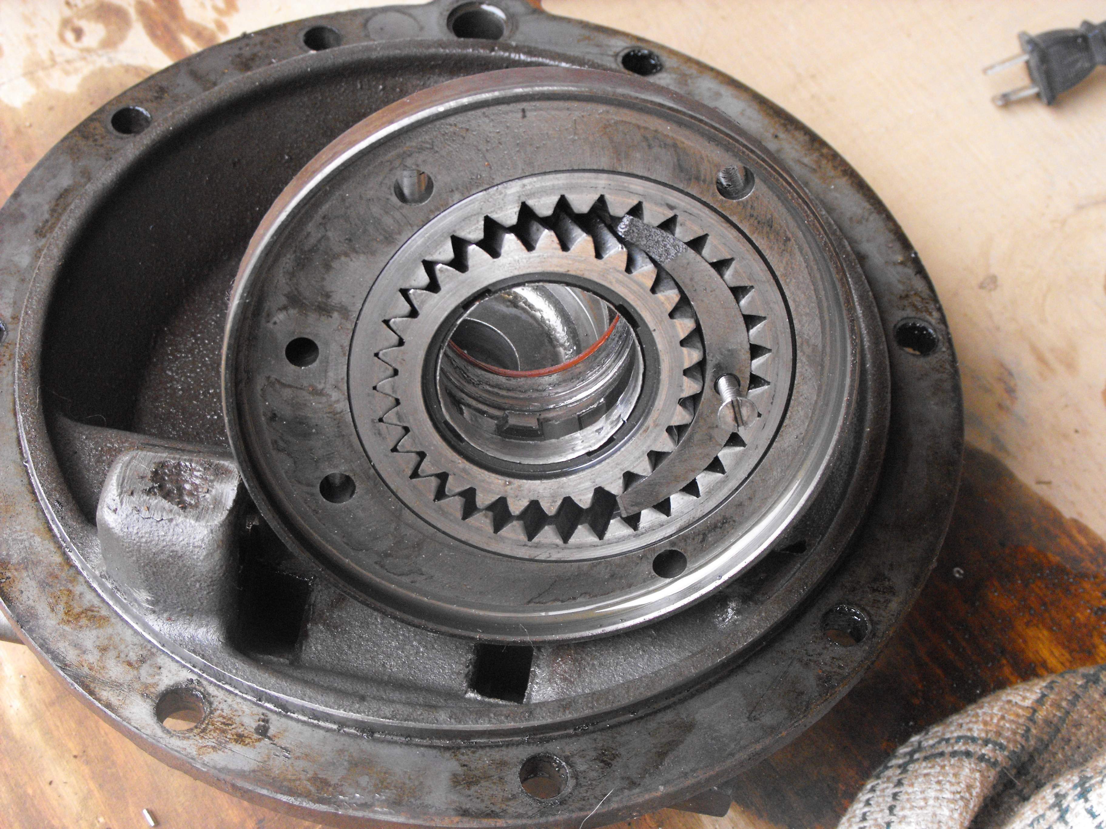

I took some pics of inside of the pump, I already know that was damaged but what I wasn't expecting was finding a tooth on the bottom of the tranny when I was cleaning it out, what I found is it looks like it came from 2nd gear :( NOT GOOD! .....
:confused:
where too go from here???

   / No idea what year this Backhoe is #88
No. Gears with broken teeth need to be replaced as a general rule. There are ways some gears can be rebuilt but not where replacement parts are to be had easily.
I was talking about the spline on the shaft sticking out of the transmission that may where it goes through the torque converter.

ah! I see said the blind man,
Tks for the info Gale, :thumbsup:
Do these gears get pressed off. and do the splines need to be lined up the same way, when they go back together?? It would be nice to get some feed back from someone that did this before...
I would like to know what caused this so, I can stop it from happening again.. if it was I that done it. I just can't see moving snow would have done this, and the little bit of work that I did do.

   / No idea what year this Backhoe is #90
The damage was there when you bought it. It just had not yet flew apart.
As a simple guess is due to wear, loose bolts, etc some space developed letting a tooth break off. That tooth is like "throwing a wrech into the works" expression.
Fix it right and it will be fine. Parting out the tractor is your only other option to recover your money I expect. Consider buying a used transmission since your damage may still not all be in sight yet.
