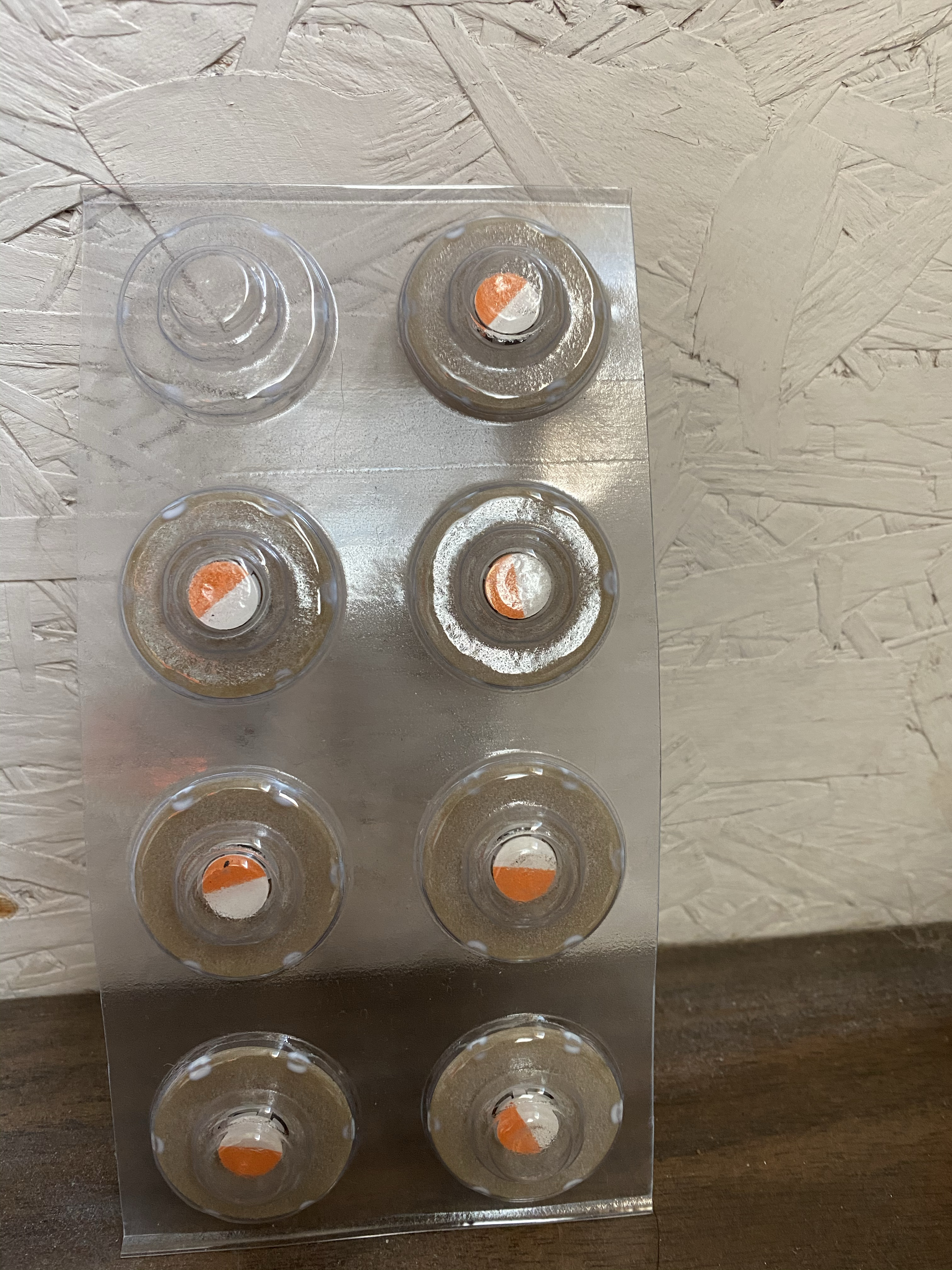

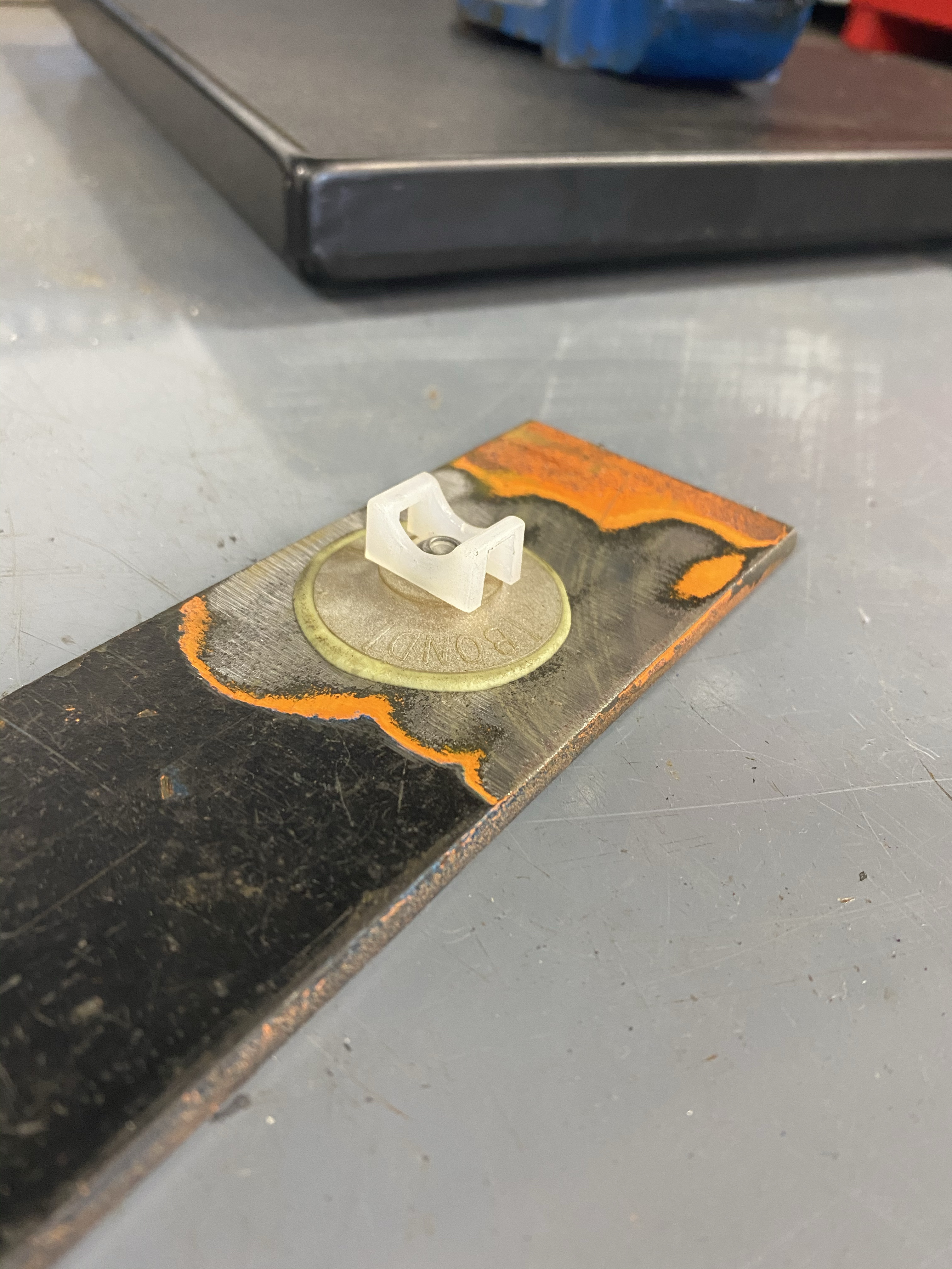

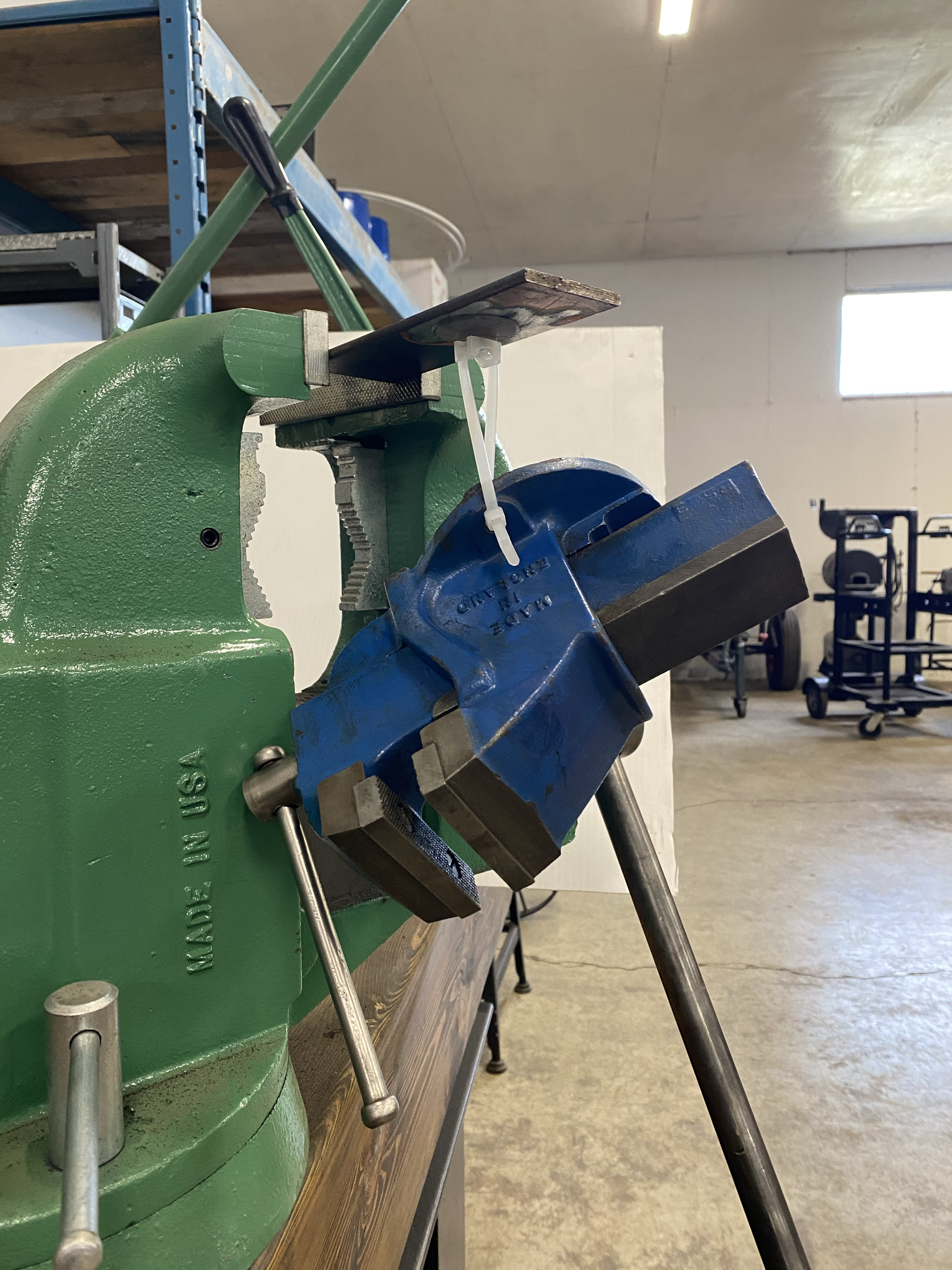

Feb 15, 2020 / No drill fasteners for stringing wire/cable bundles #12 Big Barn Super Member Joined Aug 20, 2013 Messages 7,047 Location Victoria, B C Tractor More than 40 over the years. Ten at any one time. Mostly Ford and New Holland Re Click Bond Here’s a sample I did with swivel a cable tie holder on mild steel. Painted metal ground to bare metal. A vise was the handiest object I had. The adhesive will hold for a much heavier weight but I’m certain the cable tie would stretch and fail first. Totally unscientific but I guess you get the idea. HTH.
