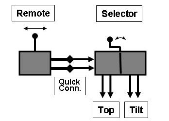

Matt, I think you have two choices. The first is to use one remote with a selector valve for each cylinder and buy your TnT setup from CCM. The CCM cylinders have pilot operated check valves and will hold firm in the position you leave them. You can install a manual selector and easily control which cylinder you need to adjust from one remote.
The second choice is to use your hydraulics power beyond and build a dual valve setup yourself with aftermarket parts.
Personally, I think your easiest solution would be to get the single factory remote and a manual selector valve with the CCM cylinders. That way you will only have to select top or tilt and then use your single remote to make your desired adjustment.

Matt, what gave me some doubt about your tractor's setup was the way you said your log-splitter is plumbed. It sounds like power beyond may already be in use. If your dealer did this plumbing, I'd talk to him about how that circuit might be affected with the additions kennyd and I are suggesting.
I think if you add a remote, you will be able to run your log-splitter off that remote instead of how you are now running it. You can plug in your log-splitter to the quick-connects on the remote. When you finish with your log-splitter, you can disconnect it and connect back to the TnT selector valve.
I've made a simple block diagram that shows the function of the selector valve and how it would be placed into the system and connected to the remote's quick-connect. These are not standard hydraulic symbols, but just a layout illustration. Your dealer might be able to install this selector for you if you don't feel comfortable doing that yourself. He will have to mount the valve and plumb it to the the TnT cylinders plus have hoses with quick connects going to the remote's outlets. You are gonna have quite a few extra hoses on the back of your tractor any way you look at it.
Whether you go with the fully configured system kennyd suggests by using power beyond or the remote and selector I suggest, I think you'll be happy you took the time to put this together. TnT is a very handy feature and I love mine.

What you have in the diagram is using the hydraulic remote valve to operate each cylinder independentaly, so operating it would be: adjust top link with remote valve selector and it would maintain it's setting. Then switch selector valve to sidelink and use the same remote control handle to operate the sidelink. Is that correct? To see if I understand correctly adding a joystick valve instead from a power beyond port would allow me to not have a selector valve and just use the joystick to operate both cylinders. LEFT/RIGHT for sidelink and FOR/AFT for toplink. Without a seperate selector valve or utilizing the remote valve at all. Correct?? That setup seems ideal to have a joystick mounted on the ROPS behind the seat would be the best spot to keep and eye on the 3pt.

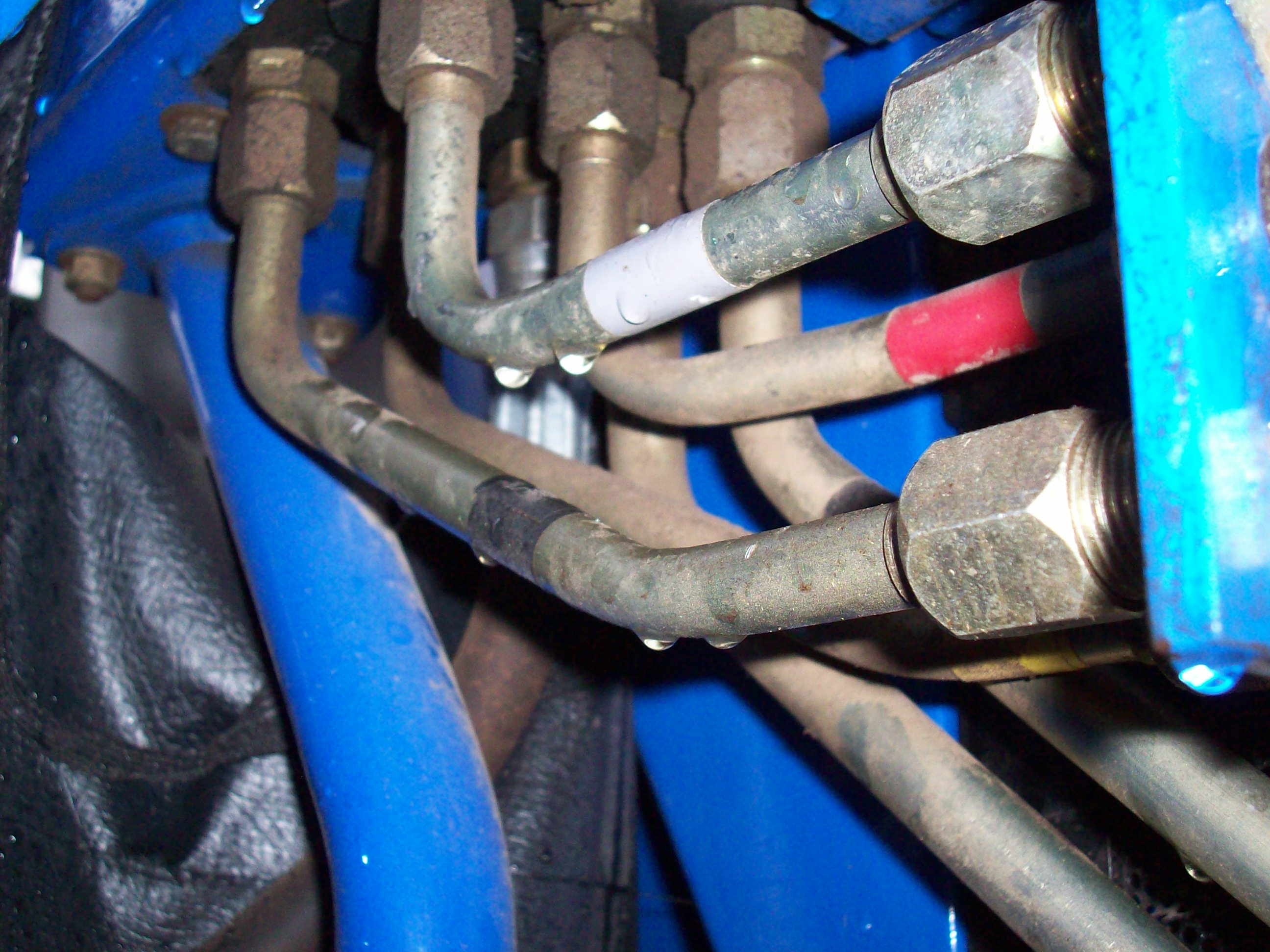

Thanks I'll ask some more later on, just wanted to post some pics while I have the opportunity. Still waiting on the dealer for an answer on remote availability.

Been trying to get some info from my dealer as well as some others. They're still checking on adding power-beyond. I'm limited to 1 rear remote. They also think I might be limited by pump output on the ability to running additional cylinders. Maybe I'll hear something more definate this week. If I can only run 1 rear remote without a power-beyond from that maybe I would be best to use the FEL power-beyond for the joystick valve for the T-N-T. Then I wonder if it's even worth adding the rear remote for the woodsplitter etc.
