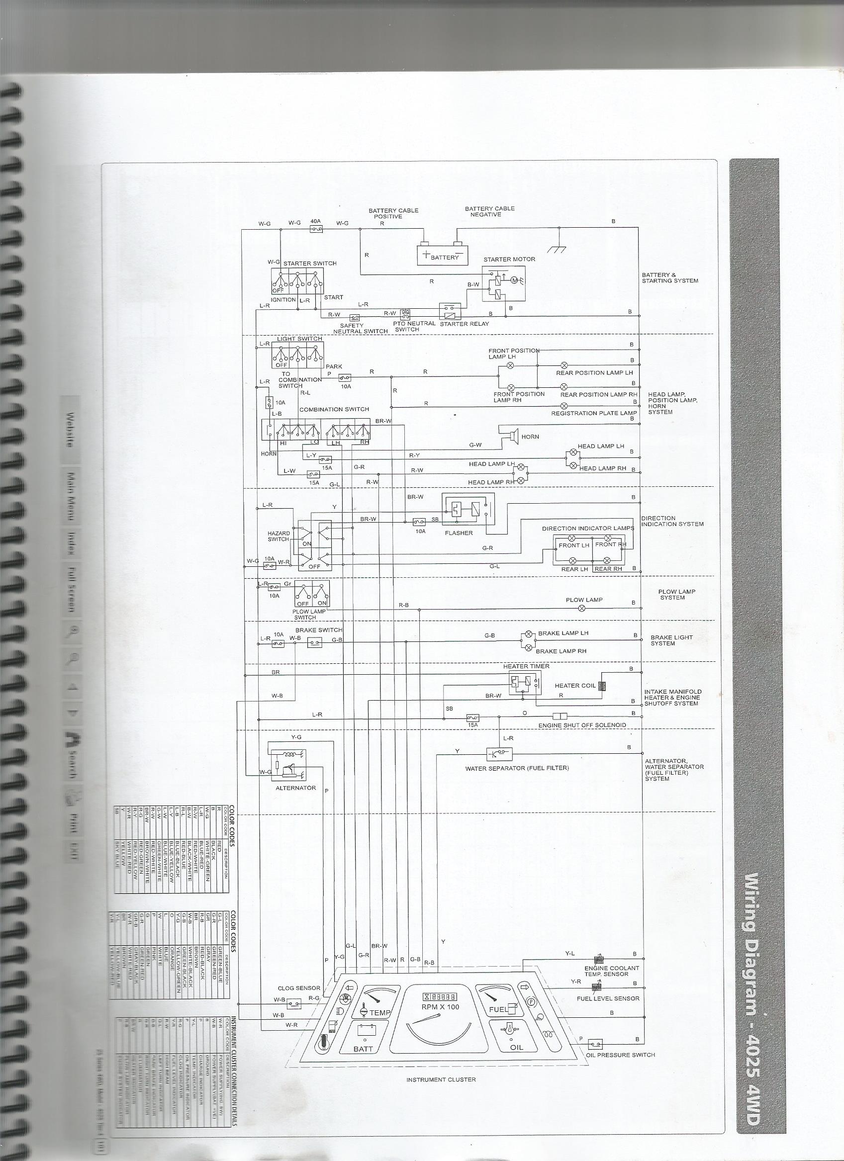

My schematic says 40amp. I found a 30 but no 40. The diesel start module with the corroded hot is a circuit board. There was no corrosion under the washer so I doubt that was a problem. I cleaned it up and put it back together. Now I have lights. No start. Going to PTO switch next. How do you test these kinds of switches with bat disconnected? Do you look for continuity or what?
Do you have horn also? So everything but starter? You can unplug the switch and check continuity between posts on the switch. It now sounds like either the PTO or Range lockout is the issue. The range switch is on the left side of the range selector, held on by two bolts.

Ok here is the schematic he sent.
/ Newbie #69
So I would start by finding the start relay coil. It has a Black wire which is negative ground and probably a red/White wire which should have 12 volts on it when the key is turned to the start position. If it does not, work backwards to the PTO nuetral switch tracing thru it and its red/white feed wire and if nothing there go back to the safety nuetral switch with is red/white wire and if nothing there go back to the key switch itself and its red/white wire We know the White/green feed to the key switch is good because when turned "on" it feeds the Blue/Red wire and you said the headlights work. The Blue/red buss feeds many other things in the tractor. including the input of th contacts of the start relay and goes out of the contacts as a black/white wire to go over to the starter solenoid.
Now if the lights go out when you turn to start, work backwards on the white/green wire to the 40 amp fuseholder and battery connections.

I'm going to get back at it before it gets too hot. Yesterday as I was wrapping it up I took the cover off of the PTO switch. It didn't look like the lever pushed the button down so I pushed it down with a screw driver. It clicked if that means anything. I'm going to follow your instructions and if I don't find anything I'm going to button it all back up mark this weekend down as lost time (as if I had a lot of time left) and drive the 40 miles to the dealer and drag a tech over here and make him fix it.
/ Newbie
#71
Tractor started right up. It's the PTO safety switch. The lever does not push the button down far enough. In about five minutes it will be referred to as the "previous" PTO safety switch. Appreciate all your help, all of you ,
