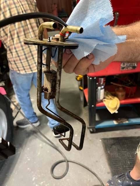

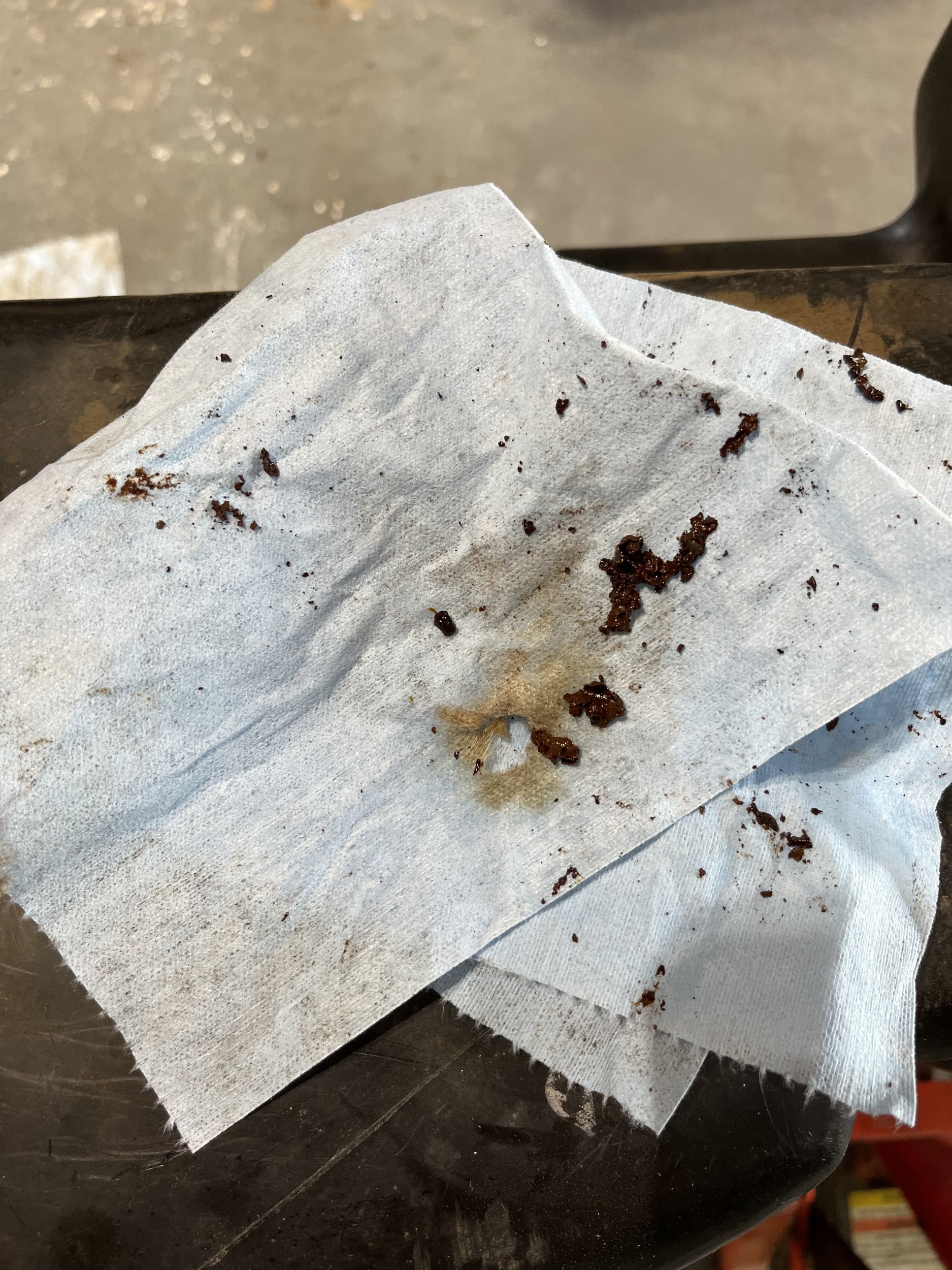

Well, pulled fuel tank and discovered black sticky goo in the tank and lines. I assume it’s from breaking down of old ULS diesel. The stuff on the towel is from the return line in the tank which means it’s all inside the FIP and injectors. We run the FIP intake into a bucket of fresh fuel and it still would not rev. I guess to the dealer it goes.
