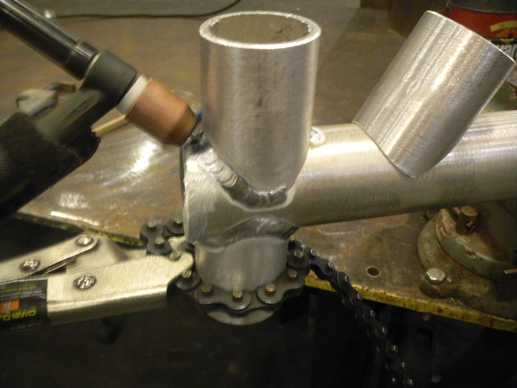

That's not much of a welder! Wonder how far $180.00 would go towards renting a portable welder? Wonder if your neighbor would loan you his welder? Saddling the pipe should not be a big deal if you have a drill press.
I'll check into the rental, and the neighbor did offer to loan his welder, he tried to scare me though with how much gas it used, surely $180 worth of gas would do the job. My saddles were done using a cutting torch on used oilfield 2 3/8 pipe already set in concrete. I think I can make them ok after grinding a bit. For the horizontal rails, I'm going to try some 30 degree cuts with my chop saw for the saddle cuts. Those pictures using the drill press explain the perfect fences I see around. :)
