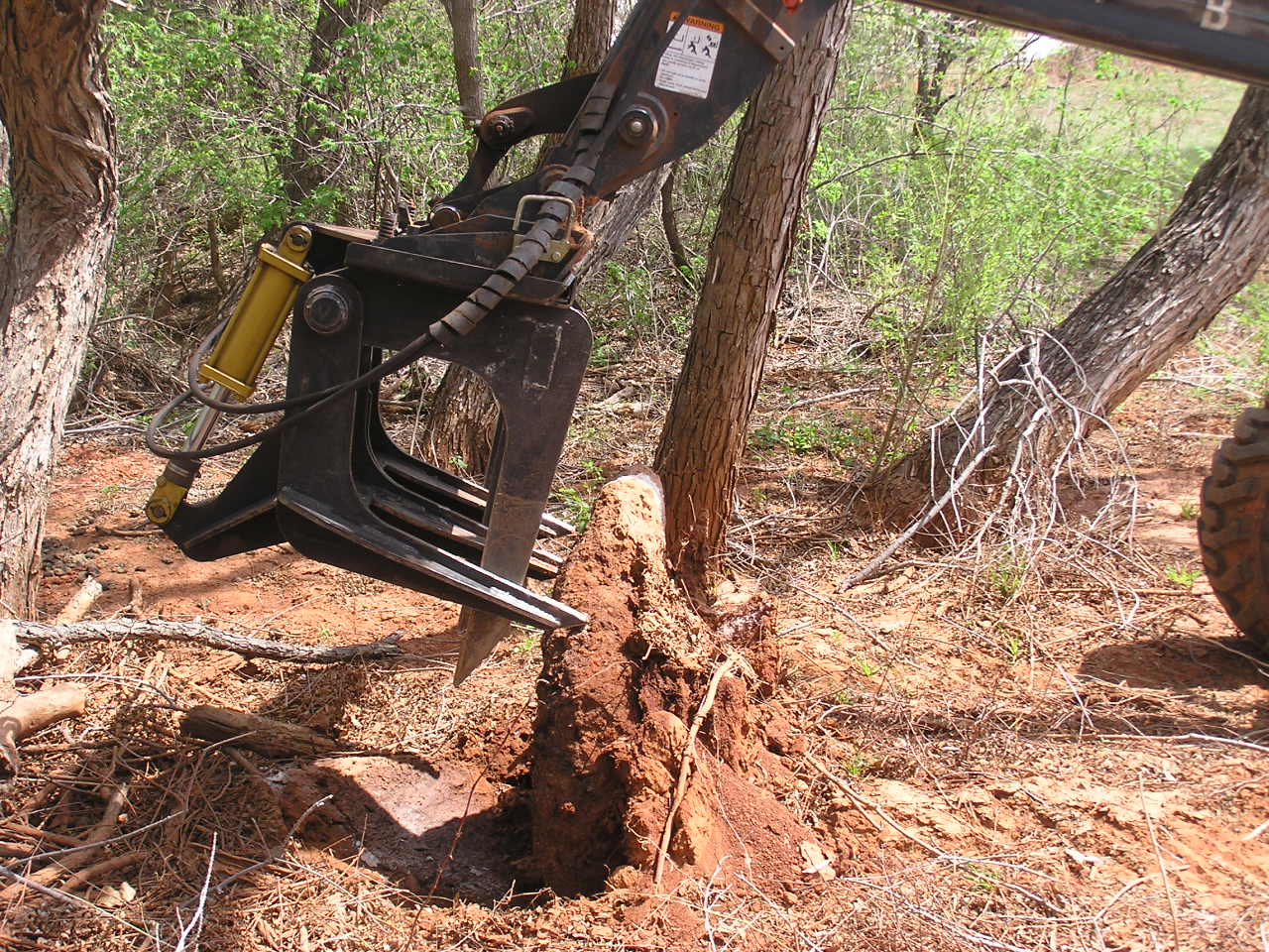

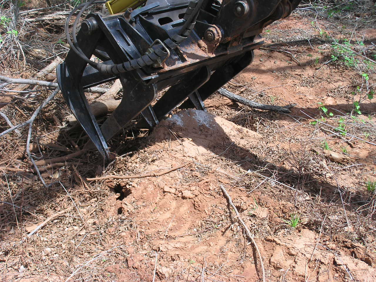

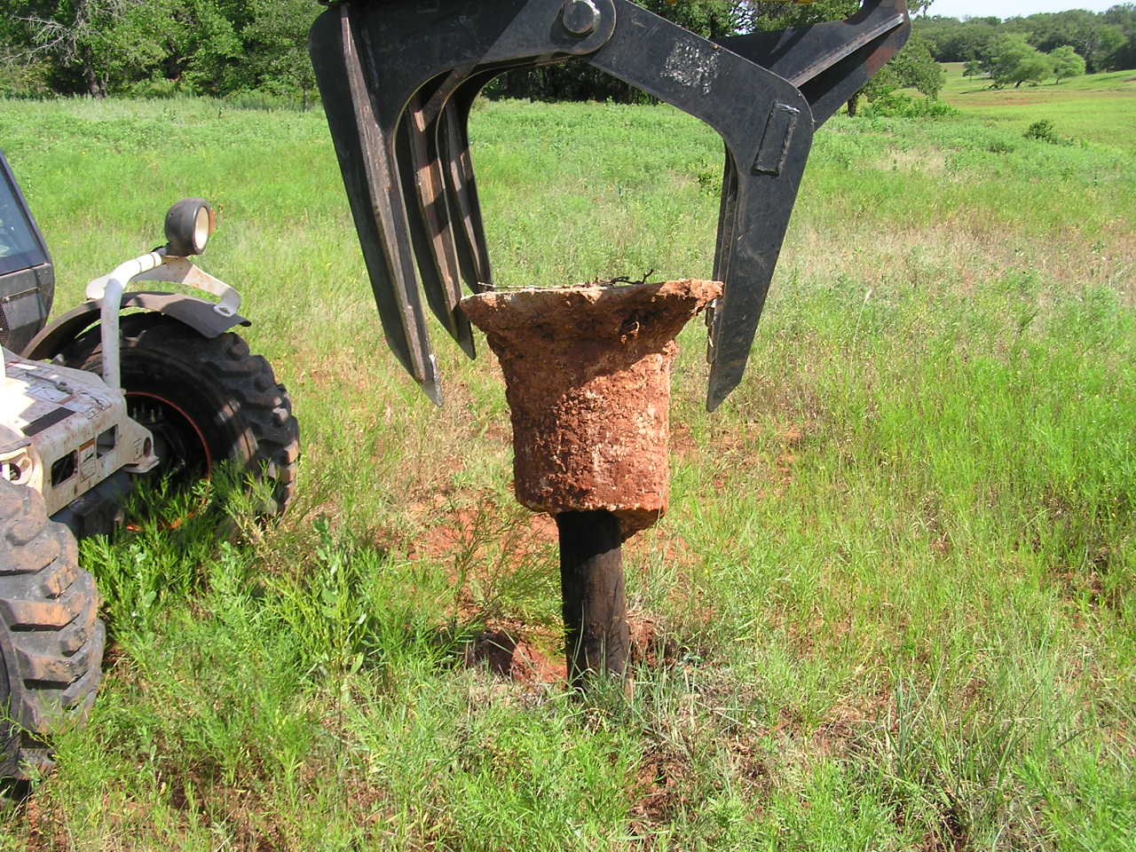

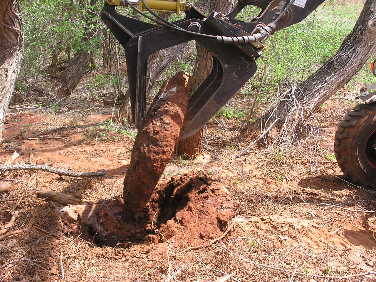

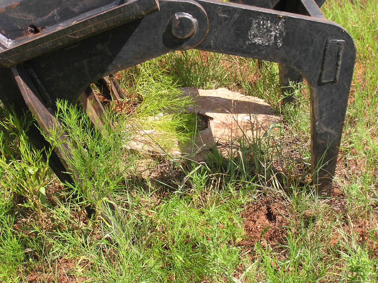

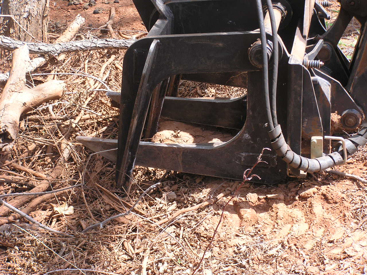

Here is a drawing of the Loflin Monster Grapple that shows the QA plate and the raised hinges, to give it the large opening.
The rollback angle works well for me.
Maximum curl down: :thumbsup:
