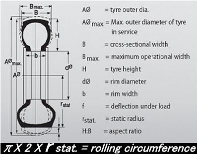

2.2" taller is quite a lot of inches in circumference. 8" to be exact. Static radius is what is important for gearing calculation though. The radius as measured from the center of the axle to the ground, specifically, due to squat. I'm wondering if you couldn't lower the air pressure to get the same radius measurement where it counts. Those tires show a static radius difference of 0.9". That much will definitely put the driveline in a bind unless the air pressure is adjusted down significantly or a half inch or so is ground from the bar height.
The front axle is already geared to pull more than the rear when in FWD, adding circumference will only ask the front axle to pull even more while engaged.

11.2-24: 491 revolutions per mile
9.5-24: 510 revolutions per mile

I've researched going to 11.2-24's on my 7040 a lot. I've talked to my dealer and several others and nobody really had an answer. All you really need to know is the front to rear drive ratio and you could do the calculations yourself. The problem is nobody seems to know the number. You generally want a 0-5% overrun in the front. "If" the 9.5's were around zero, then the 11.2's would be just under 5%, depending on manufacturer.
I've talked to several people directly at Kubota, also. No one has been able to tell me the actual front/rear ratio. The most knowledgable person I talked to, though, said that it would be fine to run 11.2-24's on the front with the stock rear tires.
