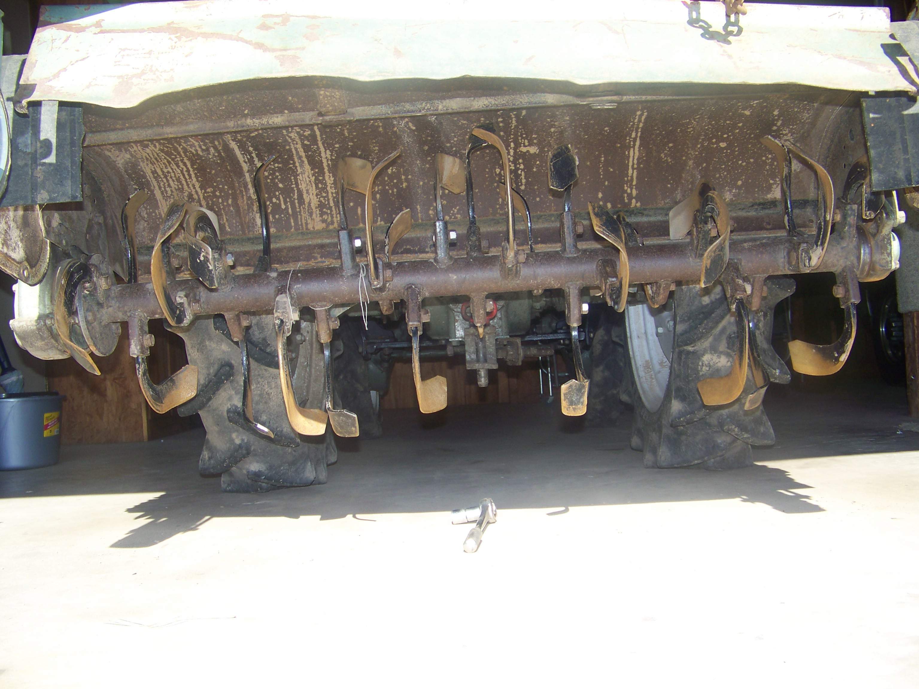

I jsut purchased new tines for my Yanmar tiller, the tines are left and right, my tiller did not have tines on it. How are the tines configured where do the lefts go and where do th rights go? do you alternate left, right? I am lost.

Easy... point the tip of the tine to the side that the nut bolts on.
Remember the bolt head goes in the slot, (not the nut)
That's the factory setting.:D

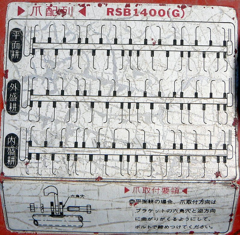

There are several patterns for the tines depending upon how you want the tiller to handle the dirt. Know one doesn't shift dirt and another shift dirt towards center so when center piece is removed from drag it forms hills. One should be able to figure out how the dirt is handled by looking at the tine pattern.

Also - tine decal photos for RS1303 and RSB1400(G). On this last one the bolt head is shown in the recess as Ernie said, and as shown in Mickey's photo above.

My wife translated this sticker. Your earlier posts were pretty accurate. The top tine configuration is for level (flat) tilling. The center for a hill on each side. The bottom for a center hill. Also the other sticker says grease wheel shafts every 50 hours and change the 90 weight gear oil every 200 hours.

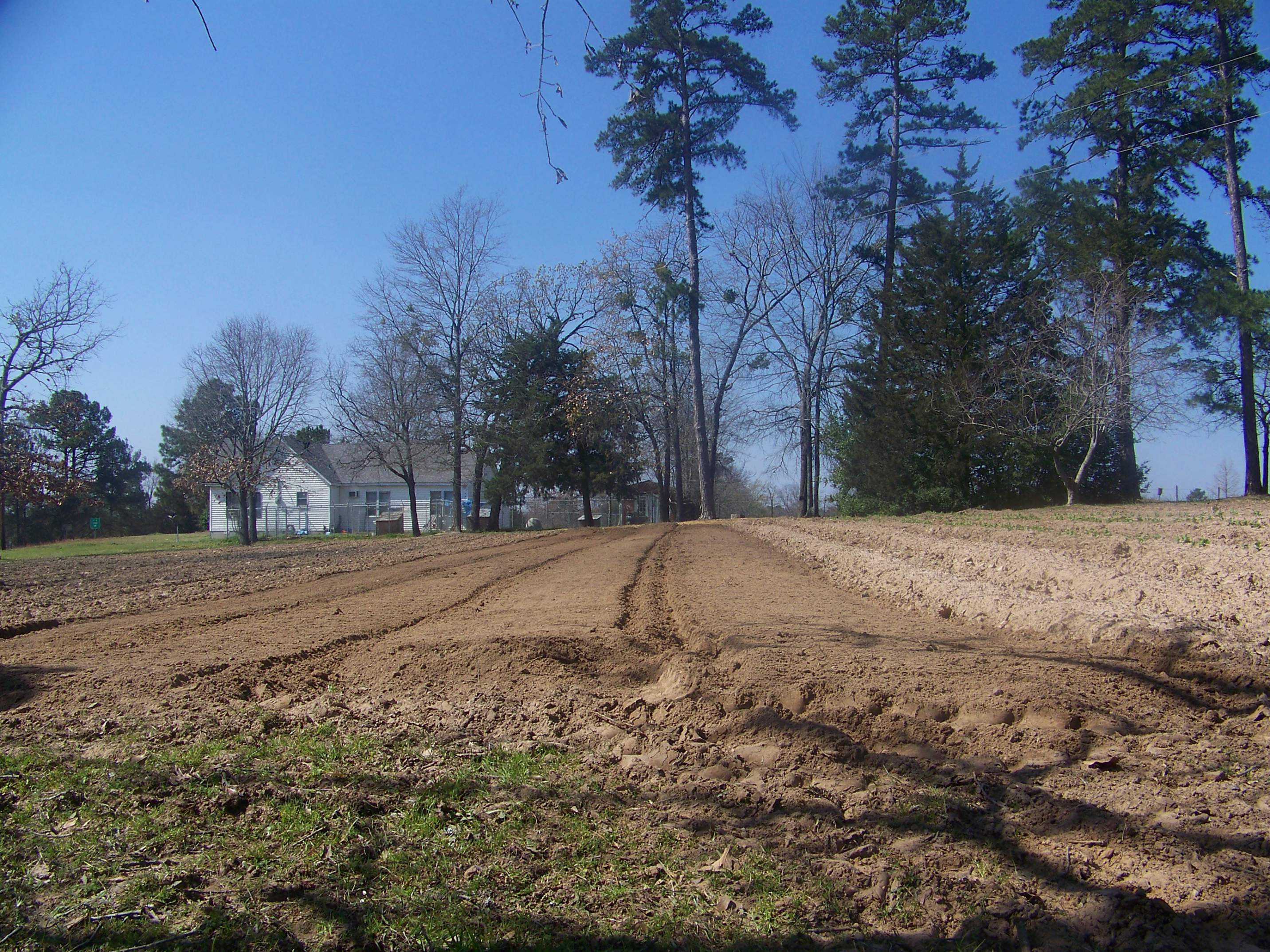

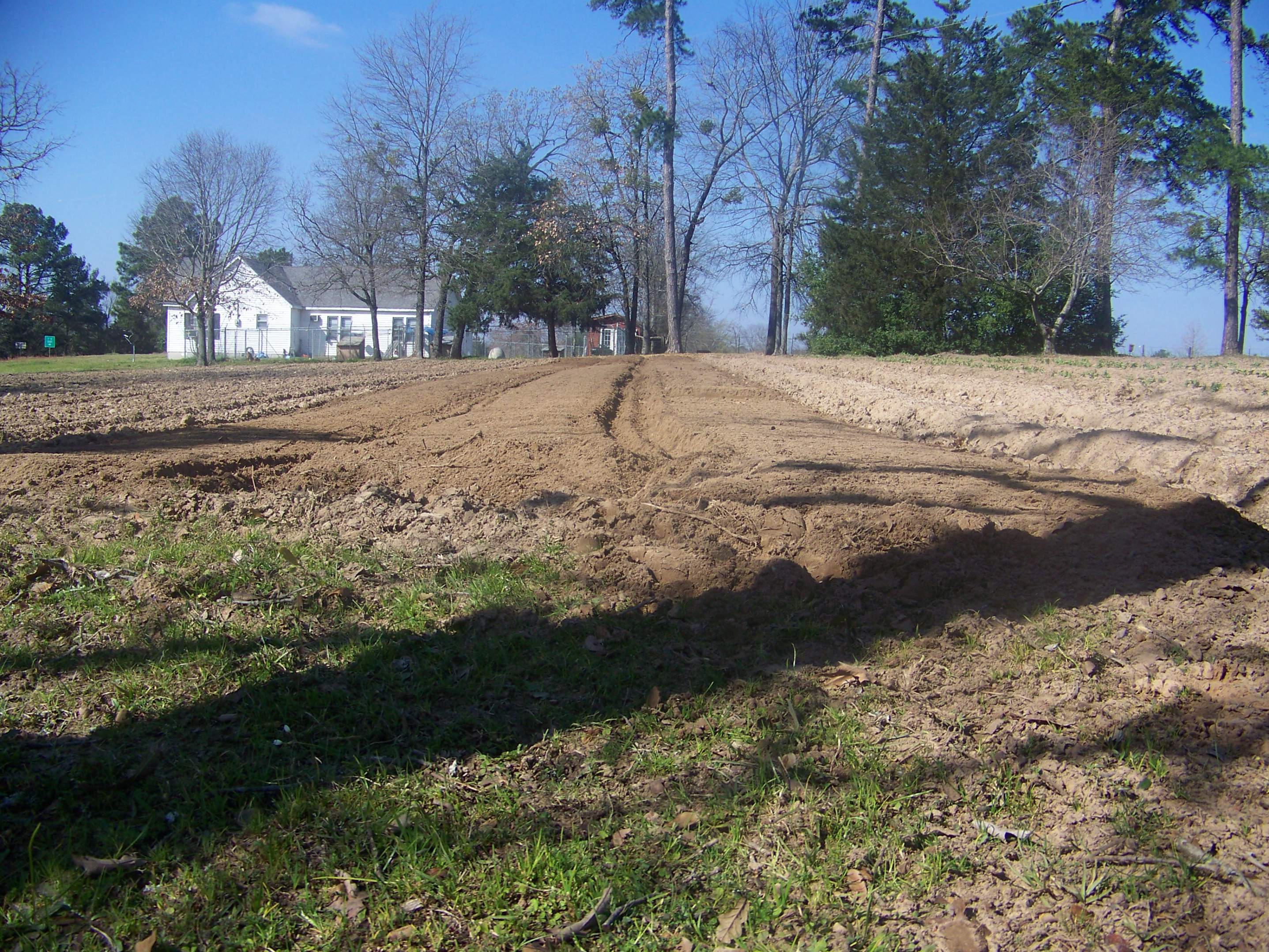

Since i like raised rows I decided to configure my tines for a center hill. Picture 1. Picture 2 shows the results. I didn't like the results so I put my tines back in the original "flat" formation and went back over the same area and that is picture 3. Very little difference. If you raise the deflector up it will hill a little more.
I put new tines on as my old ones were so thin out toward the ends I was afraid they were going to start breaking. For what it is worth I can't tell any difference in the results with the old or new tines.
